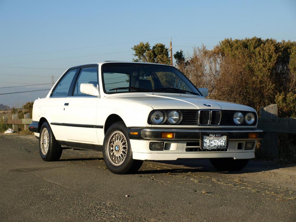

    After wasting time looking a thrashed-out beaters, I came across a great example: all-original 1988 325is, two-owner, with an inch-thick maintenance folder. It was a nicely optioned, Alpine White with black leather sport seats, maplight mirror, basket weaves, the works. The bad news: The suspension was worn out, shifter was like stirring paint, and it needed some deferred maintenance. It was also well beyond my target price, but… never wrecked, no rust, hey, it was all there.

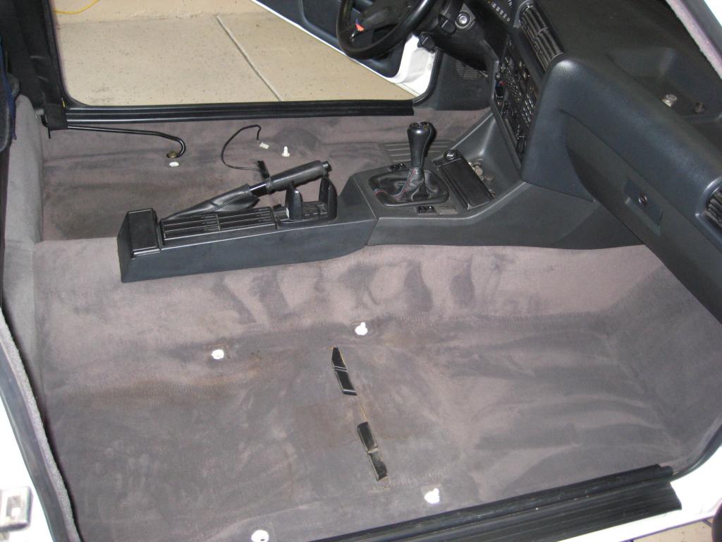

    First order was to clean out the interior, and patch up a few tears in the leather. A Z3 shifter and new bushings made a world of difference. A few months later, swapped to plastic bumpers. Tinted windows were necessary, given non-functioning A/C and summer temps over 110o. I bought a Bentley manual and “101 Projects for your BMW”.

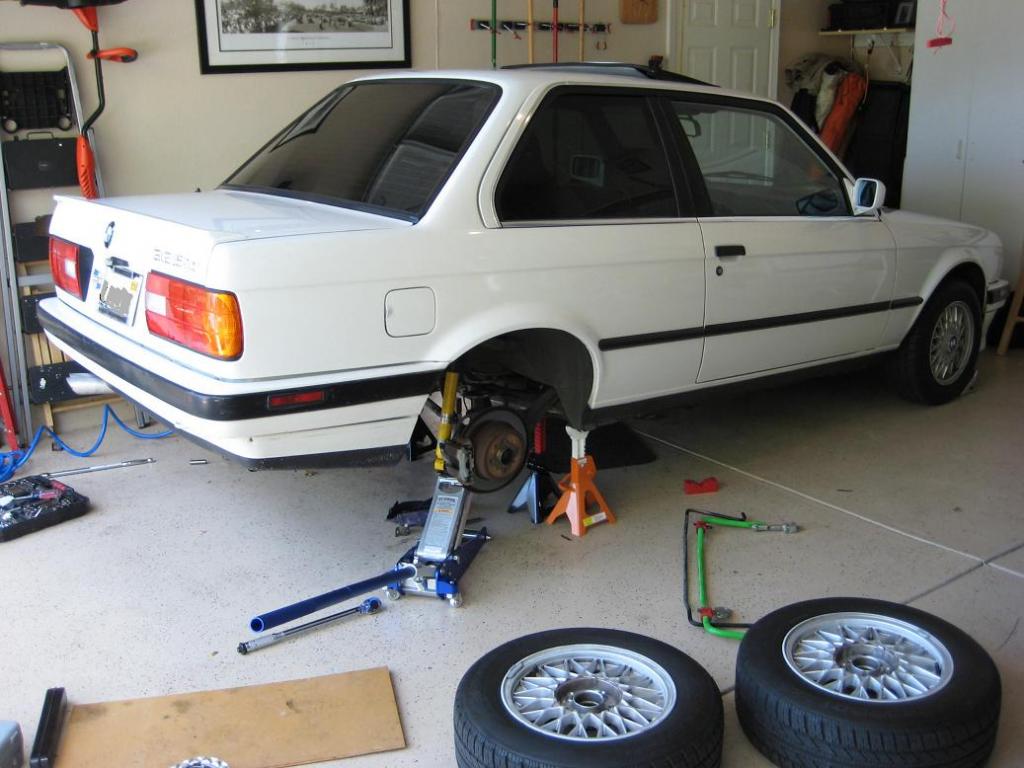

        Installed the suspension and added 21mm Suspension Techniques sways. New bushings and rubber everywhere I could. Went with M3 springs and sold the BavAutos to keep it at reasonable height.
        Check out the difference between OEM 325is and aftermarket rear swaybars.

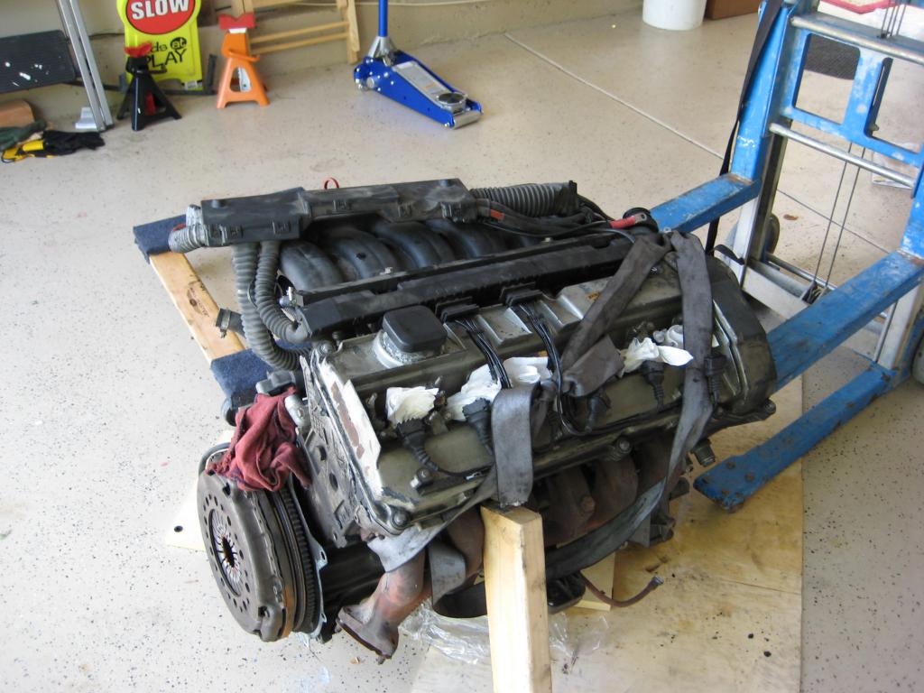

          Spent quite a bit of time thinking over my M20 engine build. I priced out a full-on rebuild vs some simple head work, and everything in between. The stock engine ran fine, but… well, it wasn’t overwhelming. A little extra oomph would make a difference. I was intrigued by the possibilities of a 24v swap. Yeah, this was the point where I first departed from my original objective of “within the limits of SpecE30.” And budget, what budget?
          Wow! Came across a smoking deal on Craigslist! Found an M3 being parted out. Low mileage S50 engine… ZF Trans…. Close-ratio steering rack. Boom, I hit the ATM and hauled it all home. It all cost just a few grand.
          The next morning, I was physically sick... I spent far too much and I’m way beyond my original constraints. The “Nut that holds the wheel” is still mediocre at best. I put an ad up on Craigslist and within days sold the whole S50 Engine + Trans package for a few hundred more than I spent. I cried a little inside when the buyer rolled away with "my" engine.

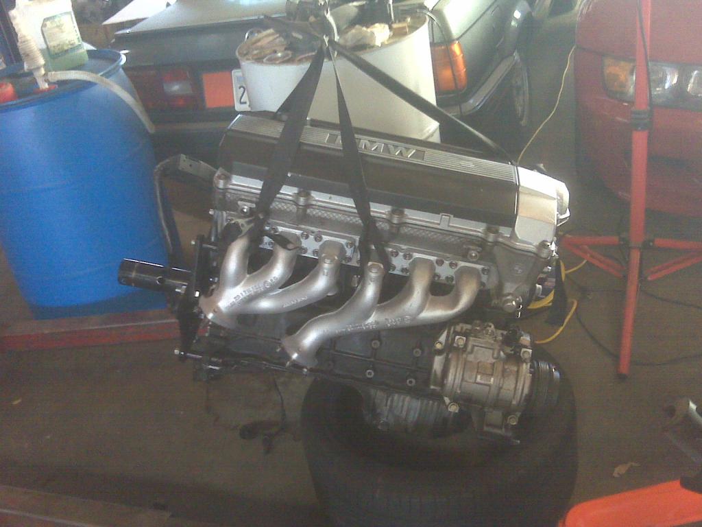

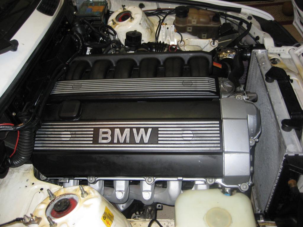

            I found that once you go down the 24v rabbit hole, it’s hard to stop, and I found myself obsessed with doing an engine swap. I set up a spreadsheet and tried to find a way to do it cheap(er). I searched Craigslist and found a nice complete E34 M50. Add M3 cams, and we’re almost there. I figured I would keep my original Getrag 260 and 3:73 limited-slip to keep costs down.
            I did all the maintenance on the engine. New water pump, oil pan & valve cover seals. Installed new VANOS seals and fixed the Oil Pump Nut. Degreased and painted everything. Compression was good, so I left the head gasket alone.

              Despite best of intentions, this is where the costs went horribly awry. I questioned my ability to pull off an engine swap. I didn’t have the flexibility to leave an engine-less car sitting in the garage for weeks/ months (years?!?) on end. After talking to different shops and a few independents, I made an appointment at Valley MotorWerks in Sacramento. They have a solid reputation in the E30 world, and field a car in the Spec30 series.
              I dropped the car off, with promises that it would be done “in a few weeks.” This is where time and budget completely got away from me. VMWerks treated me right, but a race shop doing custom work doesn’t exactly keep costs down. I lost the ability to source parts off Craigslist. We had all sorts of delays and the incidentals really began to add up.

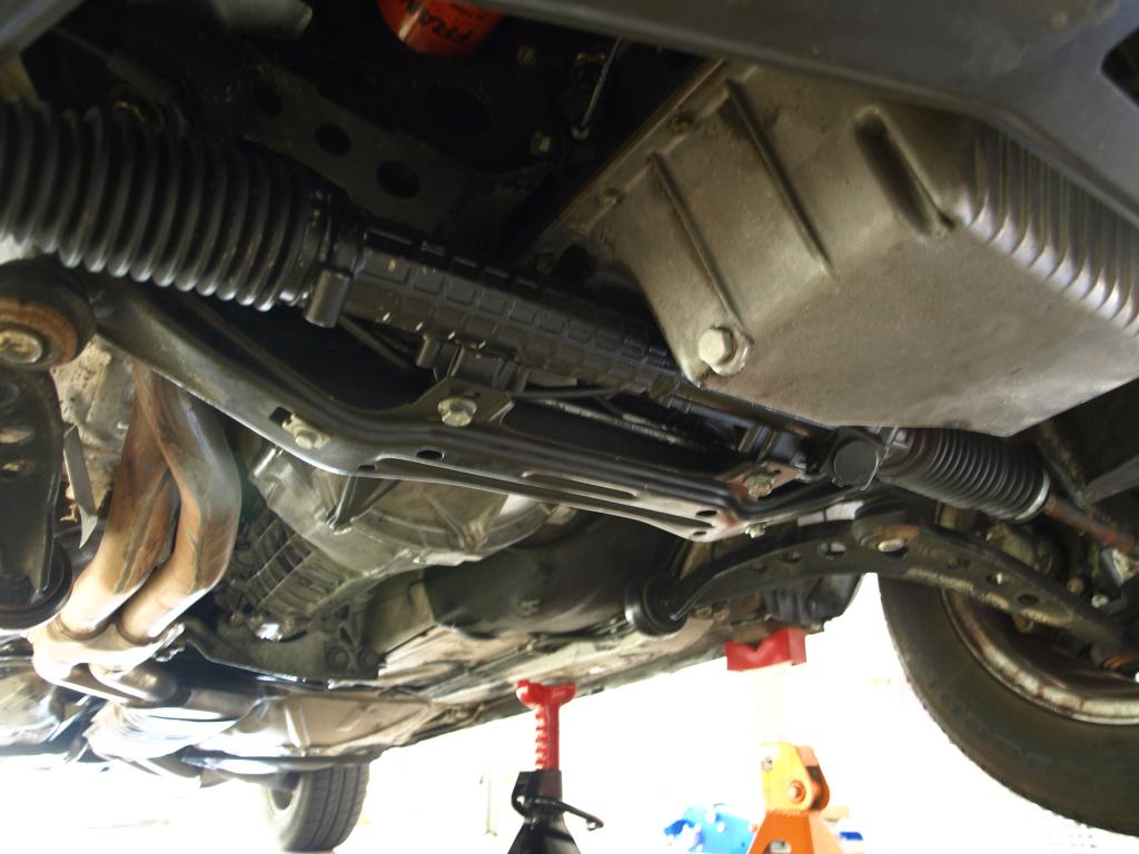

              As they pulled the engine out, various deferred maintenance issues became apparent. Heater core, steering rack, etc, etc, all had to get replaced. Replaced all the tranny seals. Added Treehouse lollipops. With costs escalating, I was starting to panic. Nearly two months rolled by before I finally got the following in my email:
              Anyway, here's an engine bay shot. After all my moaning & bitching about cost, I must say that VM Werks did a very clean, professional install. It looks like the engine was born in that spot. It starts up every time, and idles like a new car.

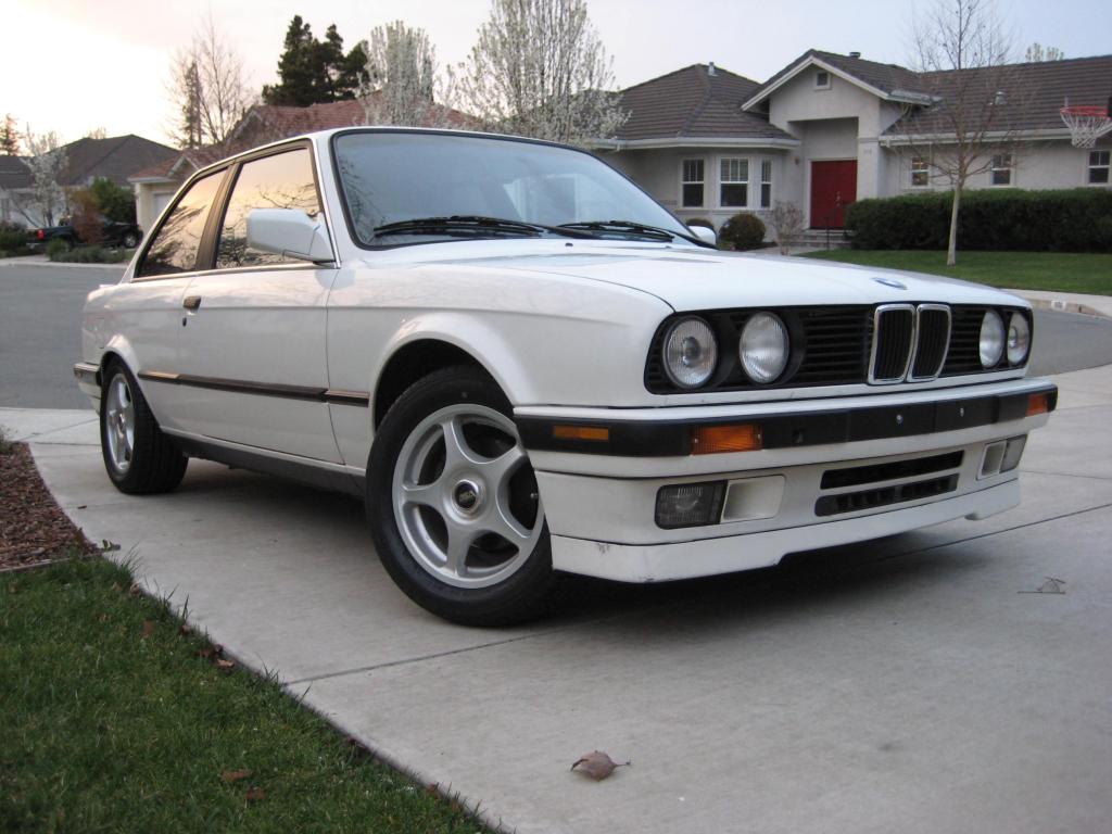

                Baby got a new set of 225/50/15 shoes and period-correct rims. I searched for 15” Euroweaves, but couldn’t turn down a great deal on these rims.
                So that’s where we are now. We’ve long since eclipsed the $5k all-in budget I originally set for this car. Once it stops raining, I need to detail the car and do a proper photoshoot. The paint is nice, but the car hasn’t lived in a garage since 1998, so it could use a tub of rubbing compound and a good polish. Comments & feedback appreciated.
