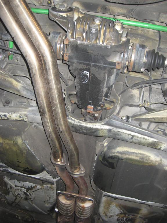

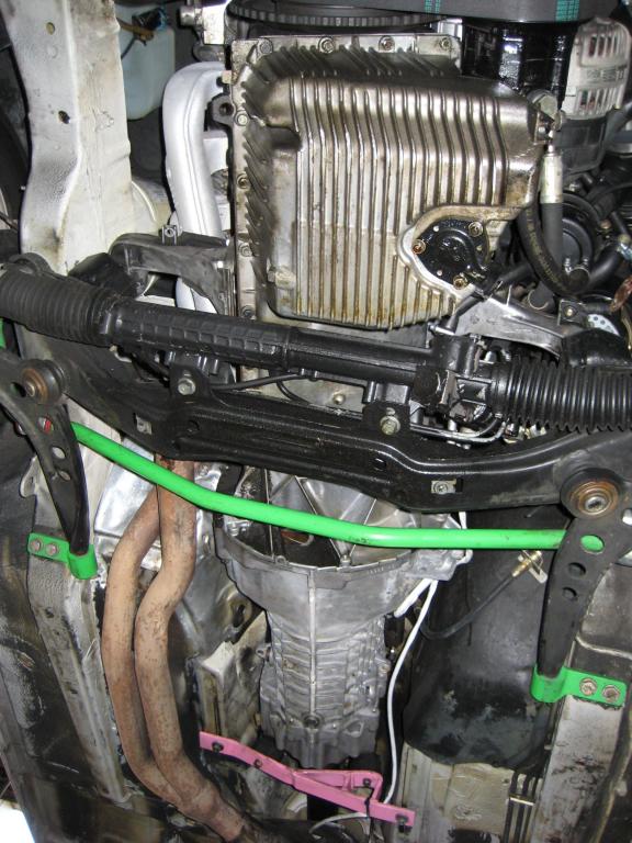

    Another Undercarriage Shot
    Engine & Undercarriage shot. I think it's pretty damn clean, but despite new gaskets all over the place, there's a leeeeeetle bit of oil moisture on bottom of engine, which annoys me. Trans is clean enough to eat off of.
      #32
      Original 3.73 Limited Slip, proudly displaying the "S". Drained the fluid and reinstalled a bottle of new Redline fluid. Maybe it's all in my mind, but it just feeeeels smoother driving down the road.

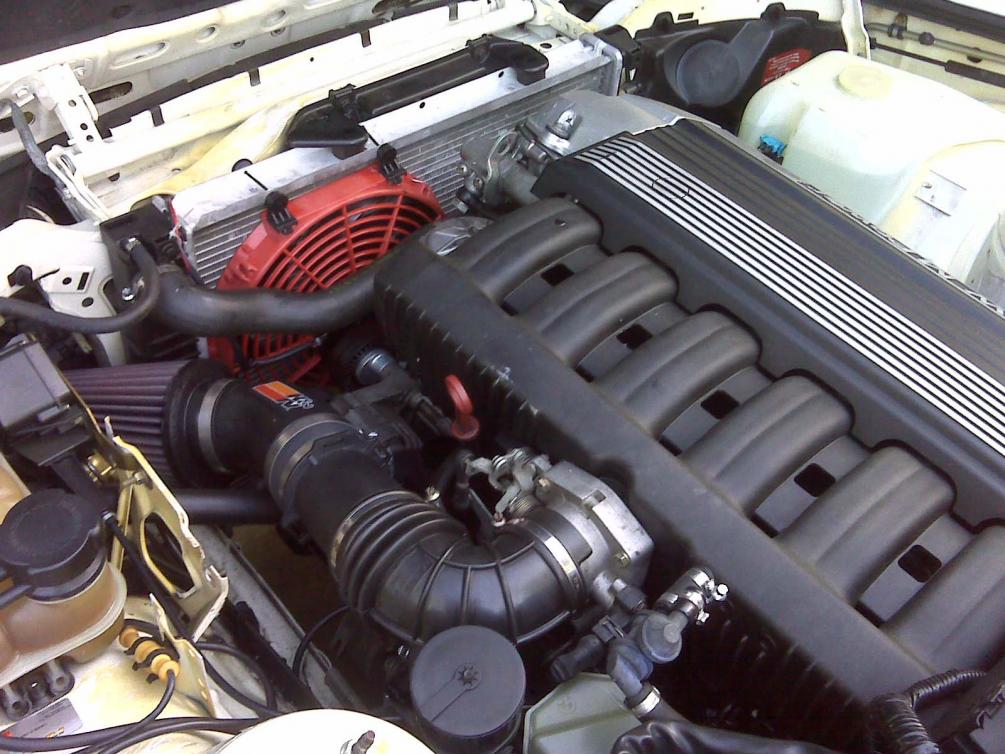

          Engine Fan
          Installed an auxiliary engine fan and 80/88c temp sensor. Now the temp gauge stays pointed perfectly vertical, even in stop and go traffic or extended idling.

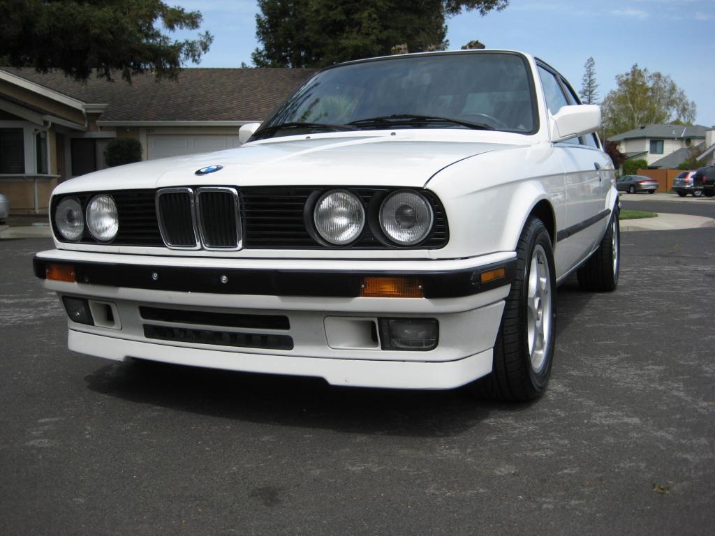

                Another E30 glamour shot. Pulled the grilles and resprayed them with semi-flat black. New Roundel on the front.
                I passed smog for my biennial registration! Woot! It failed once (high hydrocarbons), so the next day I took it back. I changed the plugs (unnecessary, the originals were nearly new), swapped the original OEM chip back in, and got the car nice and hot. Drove around for 30mins at 4000 rpm, one or two gears lower than normal. Pulled right into the smog inspection bay with the catalytic converters practically ready to self-combust... and passed with flying colors.
                If I didn't proudly point out the engine swap and my spanking new Smog BAR sticker, the smog tech probably wouldn't have noticed that it wasn't the original engine. I should have kept my mouth shut, since the original E30/M20 smog requirements are much, much more lenient than those on E36/M50. Now I'm good for another 2 years.

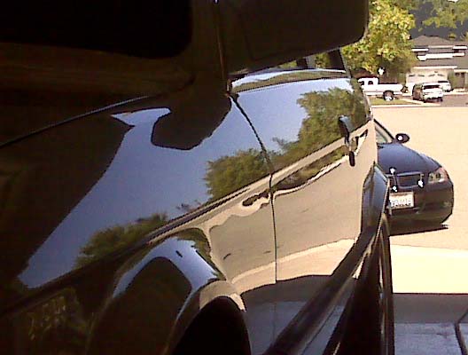

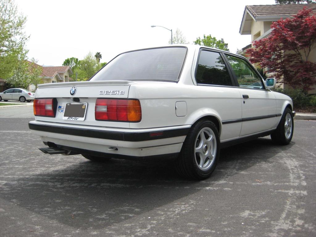

                      Side shot
                      Damn, this hand polishing is hard work. Polished up the driver rear quarter panel and trunk lid today, but it is smooth as glass and has a mirror reflection. It's tough to get a good reflection shot with a white car though. Those flaws behind the fender arch are reflections of the road, not flaws on the car.
                      Next up is to claybar the lower body, mask, and respray the black trim. Maybe tomorrow or next weekend... my arm hurts.

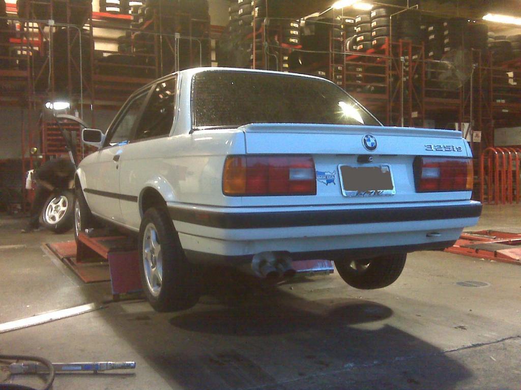

                                This week, I had the Turner swaybar reinforcement mounts welded on the rear. One of the factory mounts was tweaked, and it was a matter of time before the 20mm rear sway bar bent the other one. The reinforced mounts should keep things working.
                                The sway mount was noted during a chassis inspection at Edge, a local race shop. Some of their other findings were:
                                >> Tie rods and control arms appear to be original.
                                When I asked about tie rods/control arms, they said, "oh, these degrade over time, after 20+ years you should replace." ORLY? Anyone have thoughts on this? Dunno.
                                This Street car, I intend to do autocross/track but haven't gotten to any BMWCCA events yet. With the engine swap, I've managed to categorize the car far beyond the limits of my driving skills, so I'm not sure if I will make autocross a serious goal.
