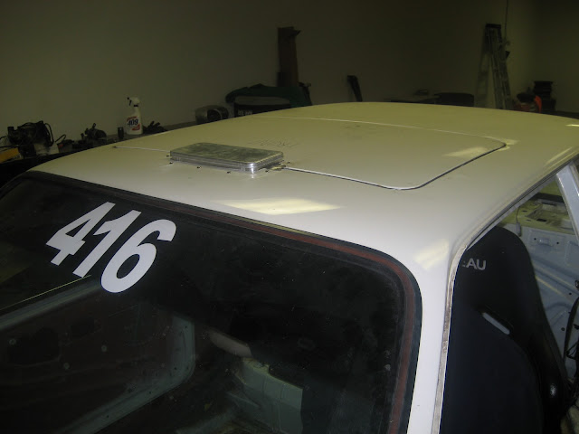

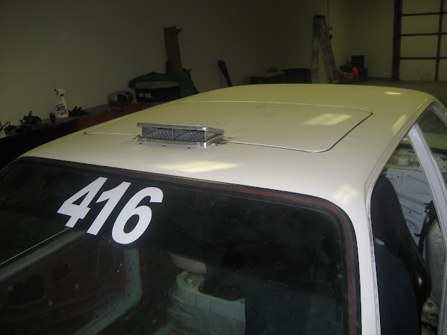

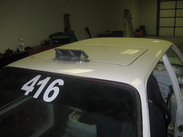

                          Next are the pics of the welded in sunroof. We added some spice to our life with a little gadget from the rally car world. Its called a roof scoop. :D It opens front ways, and back ways, and side wa.... er, just front and rear. So, pull air in, or get it out. Works very well. (Would like to thank my buddy Dave, for the idea. He has a Miata with a hard top that has one of these in it. Does an amazing job of helping you stay cool.) And before anyone mentions the drag it will create, remember, this is an E30. Driving one is akin to driving a brick wall. ;)
                          Closed:
                          Partial open:
                          Fully open:
                          And open toward the rear:

                              Otherwise nice project guys. Love the roof scoop. Where did ou pick that up from?

                                we already have adjustable swaybar links, so no worries there.
                                scoop was from my long time friend and awesome rally driver, Paul Eklund.
                                http://get-primitive.com/ <-- go to the body kit and spoilers section, it is at the bottom item number 1080.
