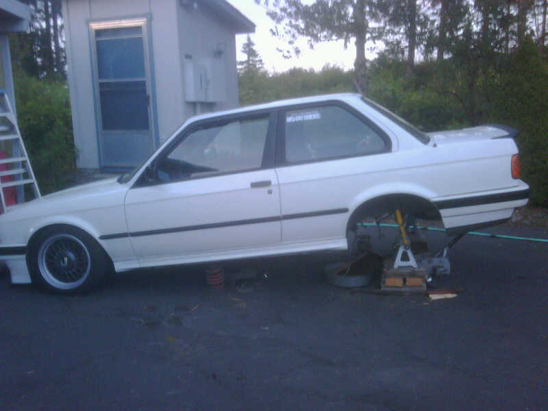

                    #99
                    Driver side was stuck. But I got it...
                    • freeride53
                      • 11972
                      #100
                      that doesn't look very safe.

                      • Danny
                        • 14216
                        #101
                        What? Looks very safe to me.
                        • Matt-B
                          The Waffler
                          • 3856
                          #102
                          wheel chocks both sides. e brake on and in gear ;)
                          besides, ive have never herd of an e30 rolling forward while up in the rear.
                          • Matt-B
                            The Waffler
                            • 3856

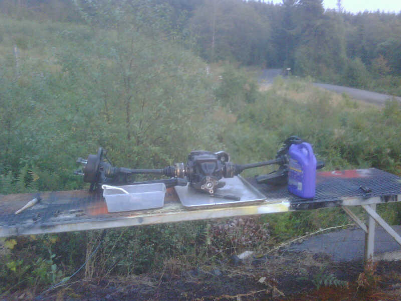

                            #103
                            Removed 11lbs of grease from rear suspension area. Rear Brake lines are in car and on rear arms. Pics soon, camera battery is charging

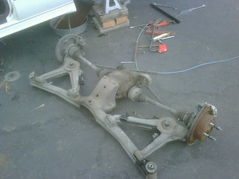

                              #104
                              half a side done
                              • Matt-B
                                The Waffler
                                • 3856
                                #105
                                rear lines in car...
                                passenger side done
