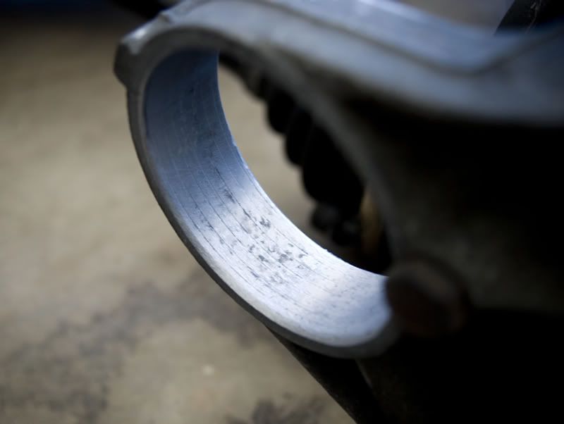

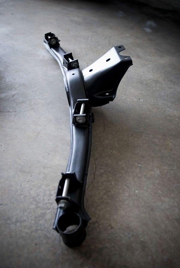

        After a long time of running with nothing to do, I tackled another project on the car this weekend. I did something I really should've done last time I had the whole rear end off the car. I swapped rear end for one with eccentric bolts and added subframe risers to get my rear alignment under control.
        I got new tires back in April/May and the rears are already toast....one side was particularly bad so I assume an arm is slightly bent since all the bushings back there were pretty fresh. I decided to make the subframe adjustable for toe and camber and also add the subframe riser kit to max out the camber reduction. Since I had already done the rear subframe within the year, the work wasn't too bad. Nothing was too difficult to remove and I was able to tackle the job quickly.
        The results look great from what my eyeball can tell. I think camber on the rear was around -4deg at first, and while I have not gotten an alignment yet, I think it is nearly 2.5-3 degrees improved. I am pleased with what my weekend of effort bought me...now to get some new rear tires and and alignment. Already she drives a lot smoother. Here are a few pics of the job:
        A quick shot of what I was looking to correct:

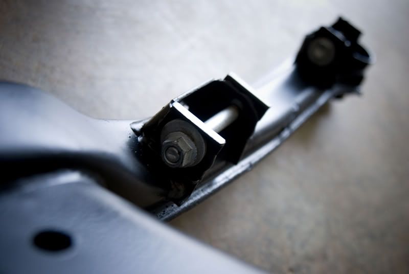

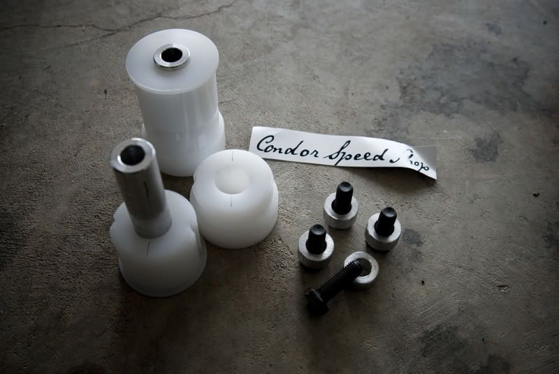

        My new subframe...got it from a fellow r3v member who makes them for a very reasonable price, MarshallM.

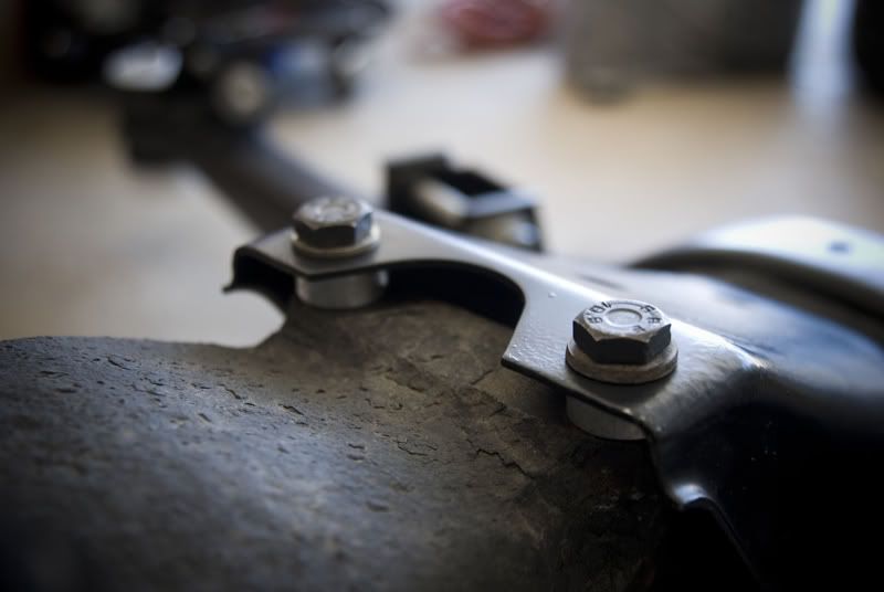

        Close-up of the adjusters

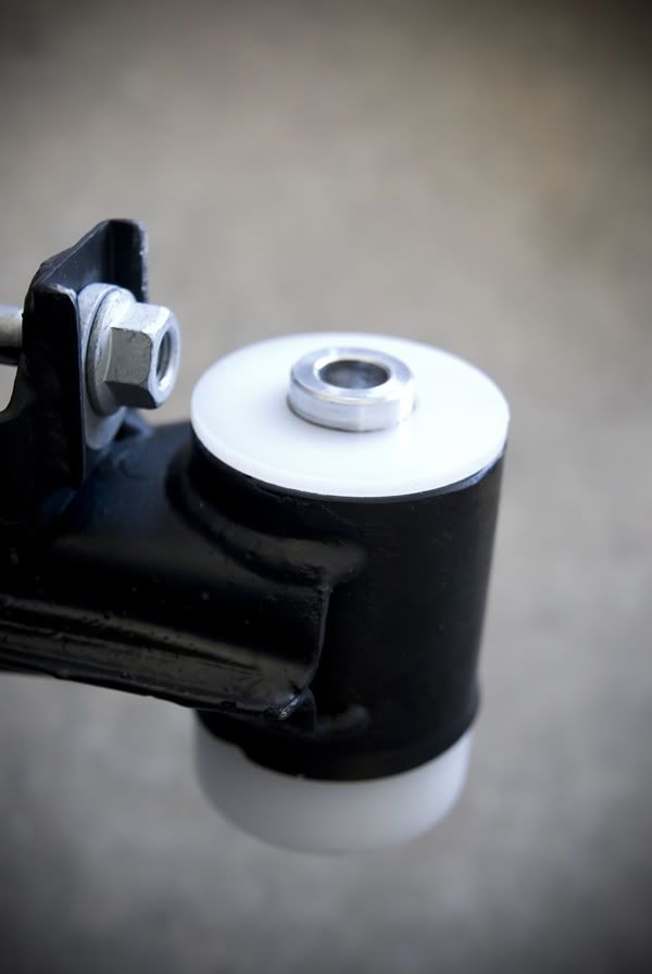

        Supporting another r3v guy...silence from Condor Speed Shop. Quality kit and everything fit together great! Can't say enough good things here.
        Shot of the bushing installed...Large side down, the lift it will provide is quite evident!

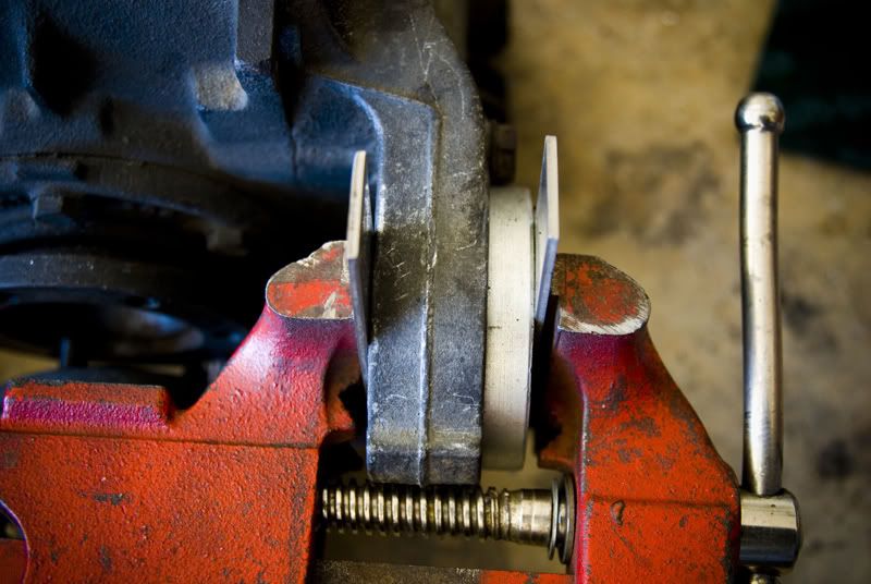

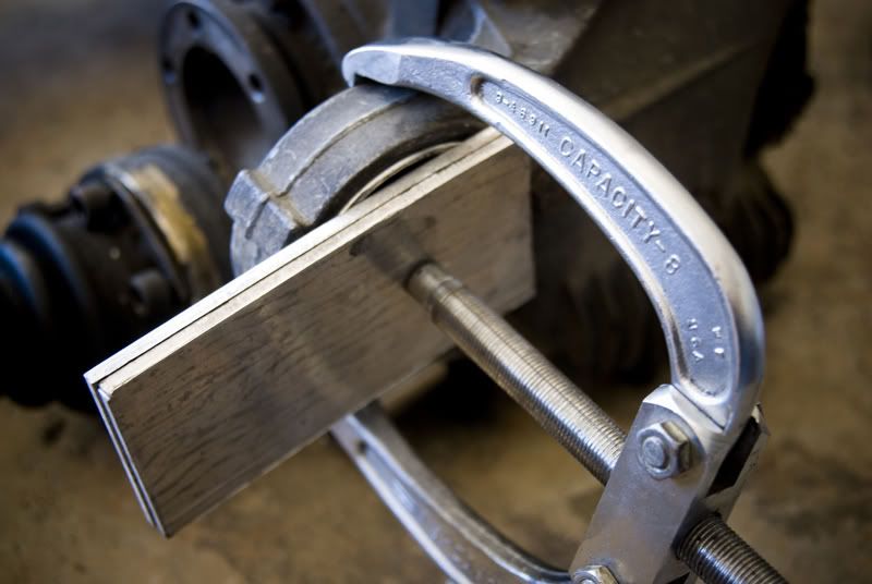

        While I was in there, I decided to replace the diff bushing. I wasn't planning it for this project, but figured why not...I've already got it all out. Removing the old bushing was easy, as it practically crumbled when I touched it. Getting the new one in required a little ingenuity and multiple tools. I'm sure it would've been easy to get it pressed in, but I didn't want to lose all my good diff fluid I recently added nor did I wan't to waste time looking for a shop to do it on a holiday weekend. Got it done with a vice and a puller. Hardest part was getting the bushing to track straight in...once it was set, it was all pressure from there!

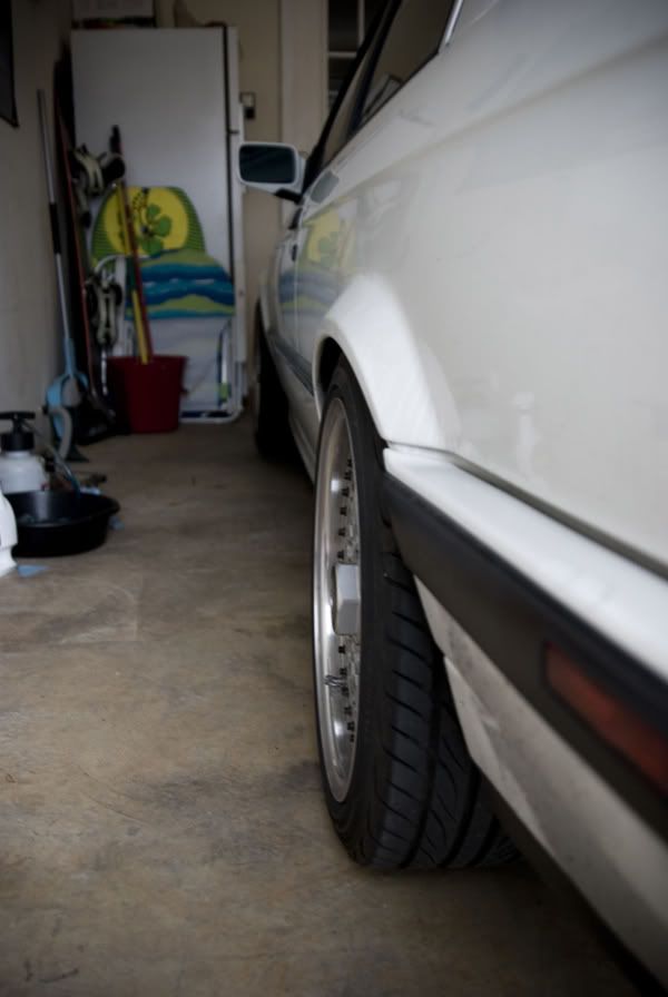

              A little shot from the parking lot:

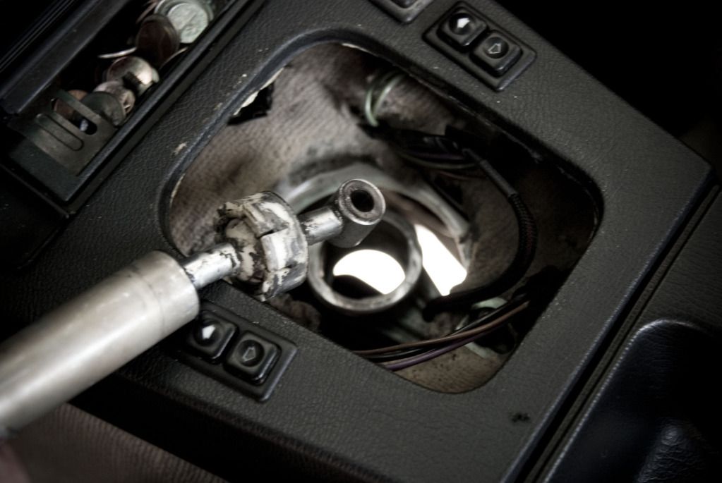

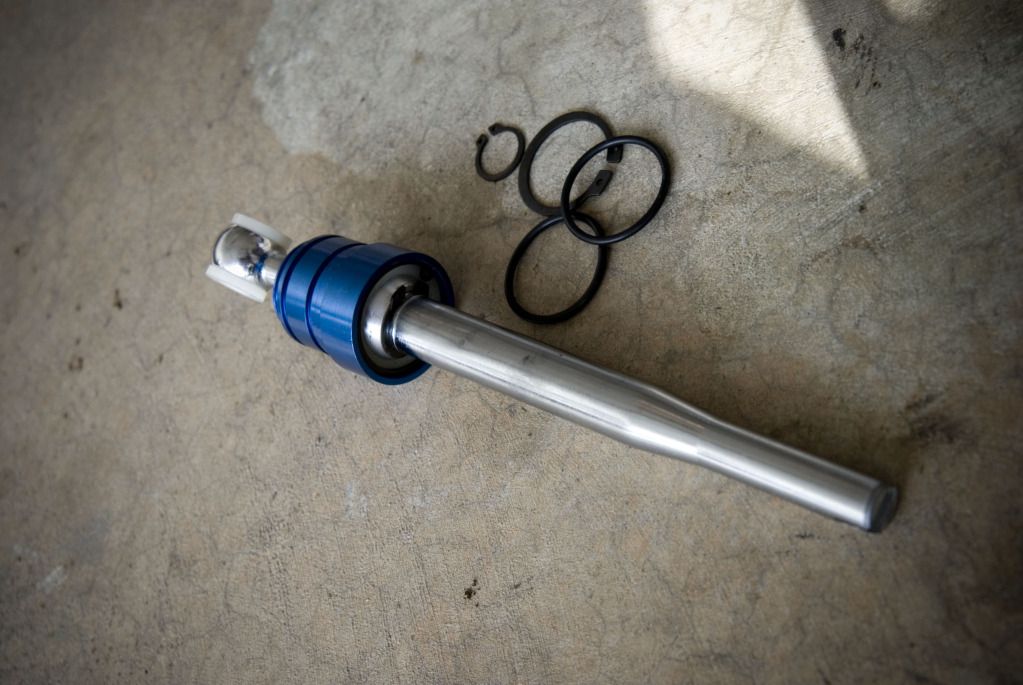

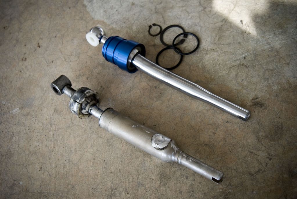

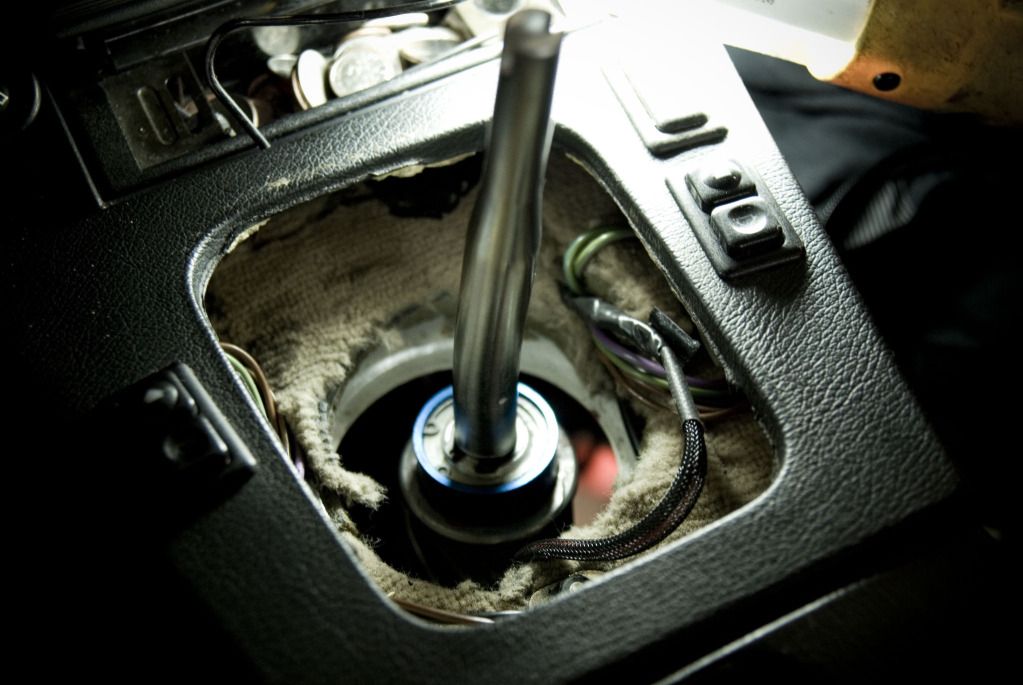

                    Quick update...threw a short shifter in this weekend. It's an ebay special...couldn't resist for the price.
                    Overall, it was money well spent. Not hard to do, and very effective. Over all feel of the shift is much improved and the throw has been noticeably reduced. Here are a few install and comparison shots:
                    Install kit
                    Removal of the e36 M3 stock shifter I had
                    Side by side
                    Installed
                    I would highly recommend this to anyone for the $30 it cost!
