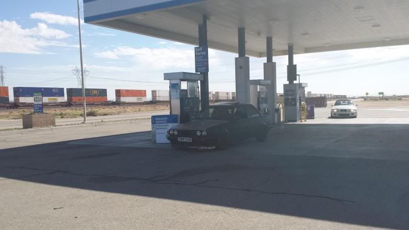

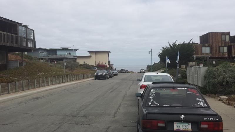

                            August 23rd, 2013
                            I took a roadtrip out to Cali before school starts again. Definitely needed the break from the daily grind.
                            And of course, the E30 was the chariot that got me to where I needed to go.
                            This is in the middle of nowhere, getting some gas.
                            Another gas station shot
                            Relaxing here in Monterey Bay, 500 feet from the beach.
                            E30 handled the 850 miles very well so far, I have to travel back another 700 this Sunday night, and I hope that that is just as problem free.
