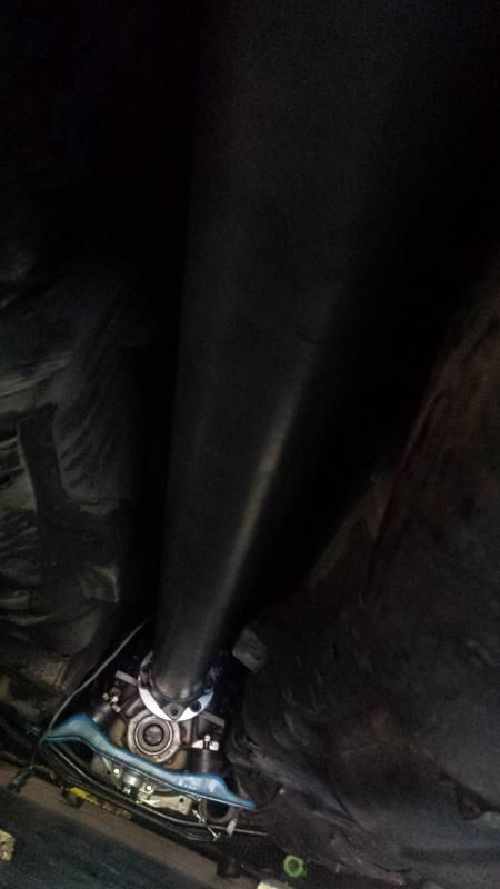

    Raul, thanks for the compliments man! And yes, it was modified to fit the massive CV and hardware inside of it.
    Update!
    Got the subframe installed easily, and the CV fits in the rear subframe without issue.
    Bad news though. The driveshaft is 3/8 of an inch too long. So the flange at the diff is going to have to be milled down to allow the shaft to fit.
    More updates will be posted after the flange is modified for fitment.

      I have done it.
      It is in.
      Here's what I had to do.
      - Modify the rear subframe as pictured above.
      - Lathe the rear coupler down, 3/8".
      - Purchase 6 8mm M10x1.5 allen bolts, 1/4" shorter than the 6 that are supplied.
      Voila, it is in.
      At this point you can own a car with a driveshaft that is far more capable than the car will most likely ever be.

        Hell yes! Nice work Mike. Video asap!
