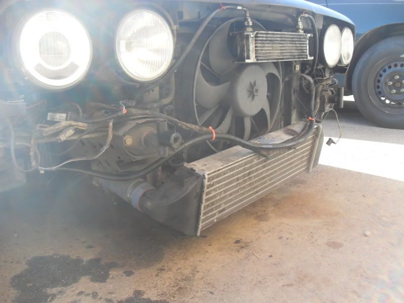

          Well progress was made, albeit it wasnt as much as I would have liked. I was forced to stop early because I needed a 90 degree tube for the discharge to intercooler tubing. So a trip was made to autozone and I found one that will work just fine.
          Its also the best friends 21st birthday, so I will be going out with him tonight to celebrate.
          Unfortunately the tune didnt get here today, but it is really close and will be here tomorrow according to the tracking info. Which is fine, cause the E30 still needs a little bit more work, and I have a few things to tweak to make it fit better.
          It is definitely a puzzle to get it all to fit in there, and I cut two pieces out of either side to allow the intercooler to properly fit, and it worked out perfectly.
          Onto the pics!!
          Just to show you I am not lying....
          The three hoses that route into the system, just begging to be attached!! I know the car is dirty, but due to my situation I cant clean every nook and cranny, so dirty it will remain!
          I am happy with how the progress is coming along. I can only work for a few hours each day after work.
          DISCLAIMER: This is not the final location of the intercooler (angle wise), it had to be in place to check the fitment. I promise it will be held on by the brackets that came with the kit, and not zip-ties. I picked up some self tapping bolts, and the brackets will be mounted and attached tomorrow.
          Thats all I have for now. I am learning a lot about superchargers, and forced induction in general. Its a lot of fun, and I cant wait to experience the power.
