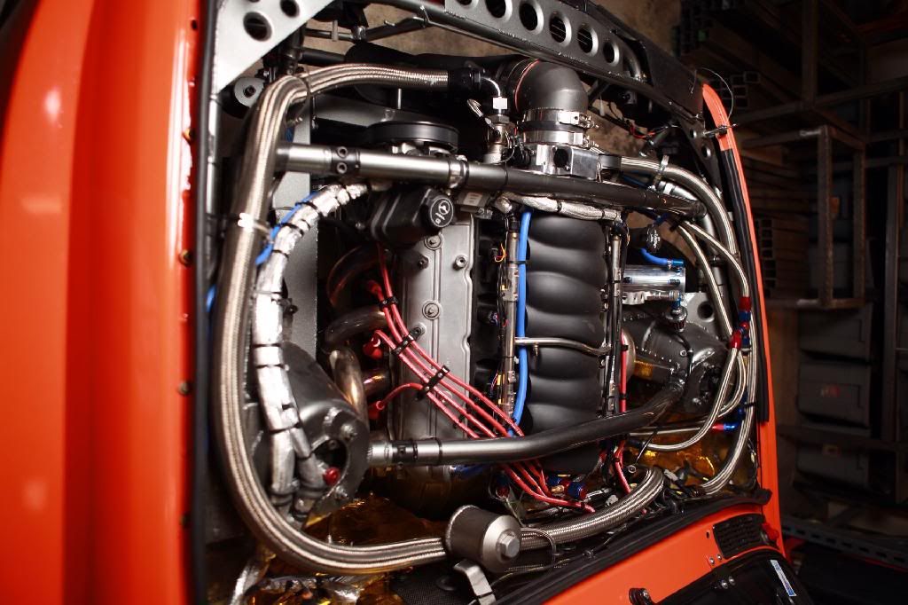

            Thanks dude! It was hard to make that thing work! No one made thin wall 4.25 inch tube to connect the intake to the throttle body. So I grabbed some .060 steel sheet, rolled it into a 4.25 tube and welded the seam. Then I cut the tube into a few pie shapes to make the bend. The intake was way too low to the ground so I had to cut the plastic intake tube shorter to get the intake it line up with the opening in the front bumper.

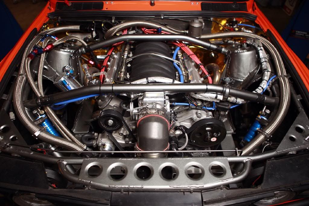

                    Thanks for updating for me dude! Got the map sensor fixed, wiring guy put a 3 bar in the car for some reason... The tune went good despite the throttle cable end fitting popping off, luckily it landed on the water pump and stayed there while I rolled back into the pits. Got that fixed and finished the tune, huge thanks to Tom Nelson at Nelson Racing Engines. He is amazing with tuning and he is very humble about it. Some tuners think their own shit is made of gold. Tom gave me a great price and stuck to it even with the extra work due to the map sensor not functioning. He liked the build too, it feels weird impressing people that are that good at what they do. Brakes are still not where I want them, I might go back to a booster. The huge 60mm e46 m3 calipers up front are not helping me balance it out. Car got a hot for such a cold day, intake temps were 42F and I still got the water temp to 215F after a little drift session. When I hook up the water sprayer this should improve, how much is the question. I have already marked up the bumper and trunk lid to cut out sections for more air flow, and will be adding fans to the trunk lid too. More testing to come after the holidays. Happy holidays to all the e30 freaks out there!
