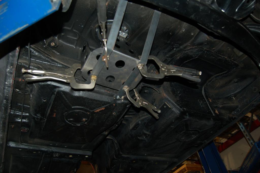

    you seen them going one after another into the wall at irwindale? it was nuts. gutting the trunk area like that seems to becoming the trend now. Essa is doing it on his 2013 e46 too. just as JR's and JTP's mustangs. but they have been that way for at least two seasons now I belive.

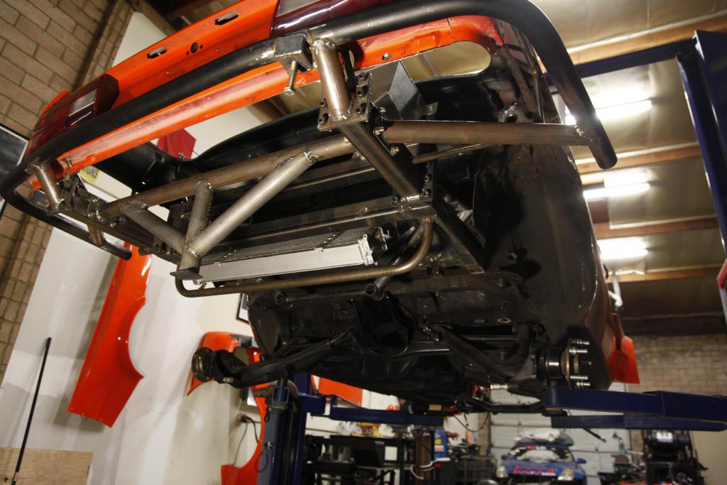

      #122
      From the underside
      • Shmately
        • Jun 2010
        • 64
        #123

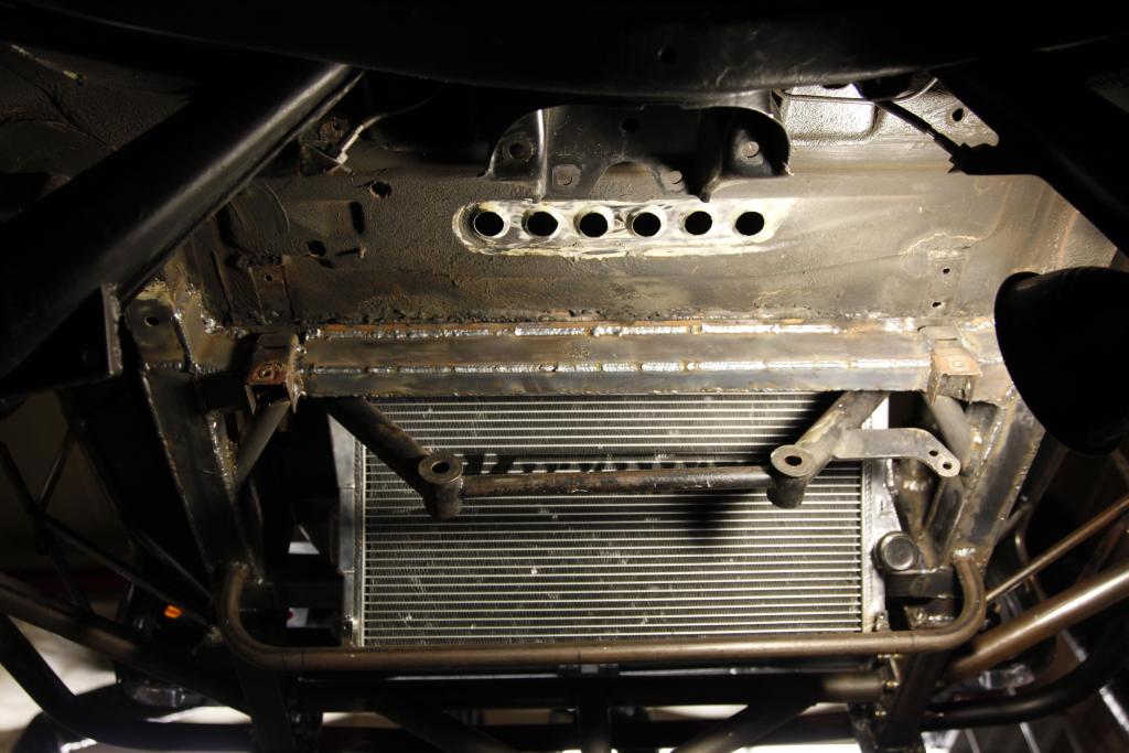

        Radiator should get some decent airflow from under the car
        • Shmately
          • Jun 2010
          • 64

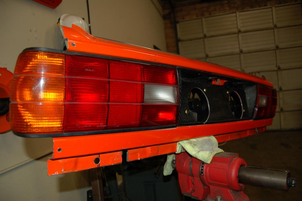

          I installed a pair of 5.2 inch spal fans in the rear panel
          • Shmately
            • Jun 2010
            • 64

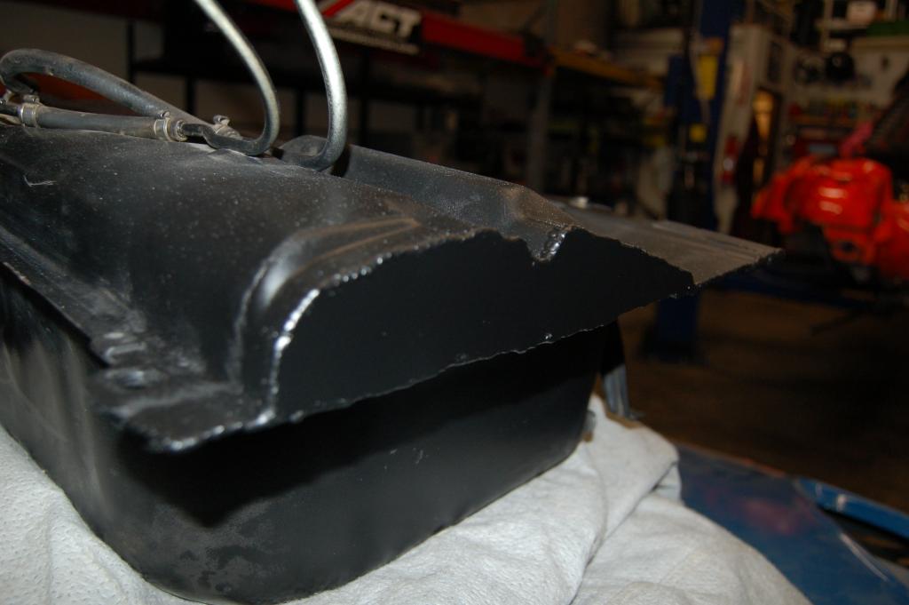

            #125
            I cut the bmw gas tank in half and sealed of the end

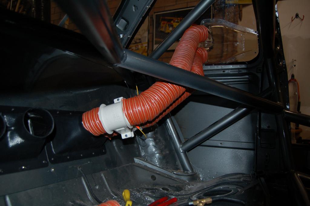

              A few naca ducts and inline blowers installed for some more flow
              • Shmately
                • Jun 2010
                • 64

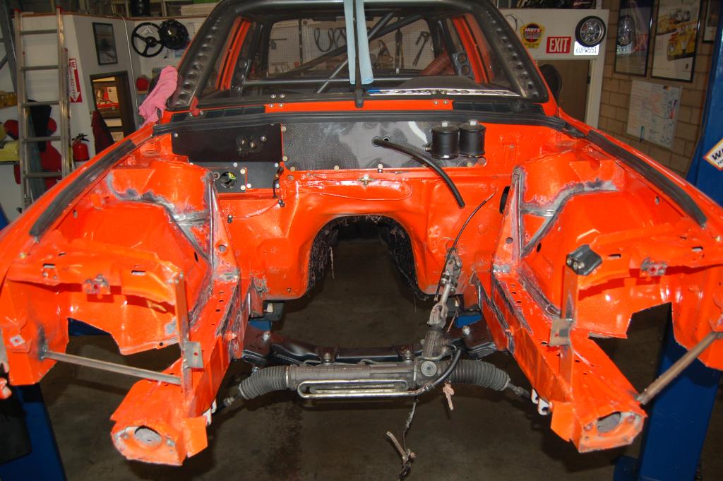

                    This front ends days are numbered, I will be cutting the framerails and tubing it out after engine placement is finalized. As for now I have some seam welding to do.
