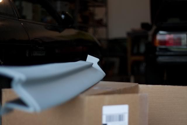

    Then I was able to begin working on it again and started with a Zender rear apron..
    This is going to take a little work.
    Fits ok, I'd like to see better.

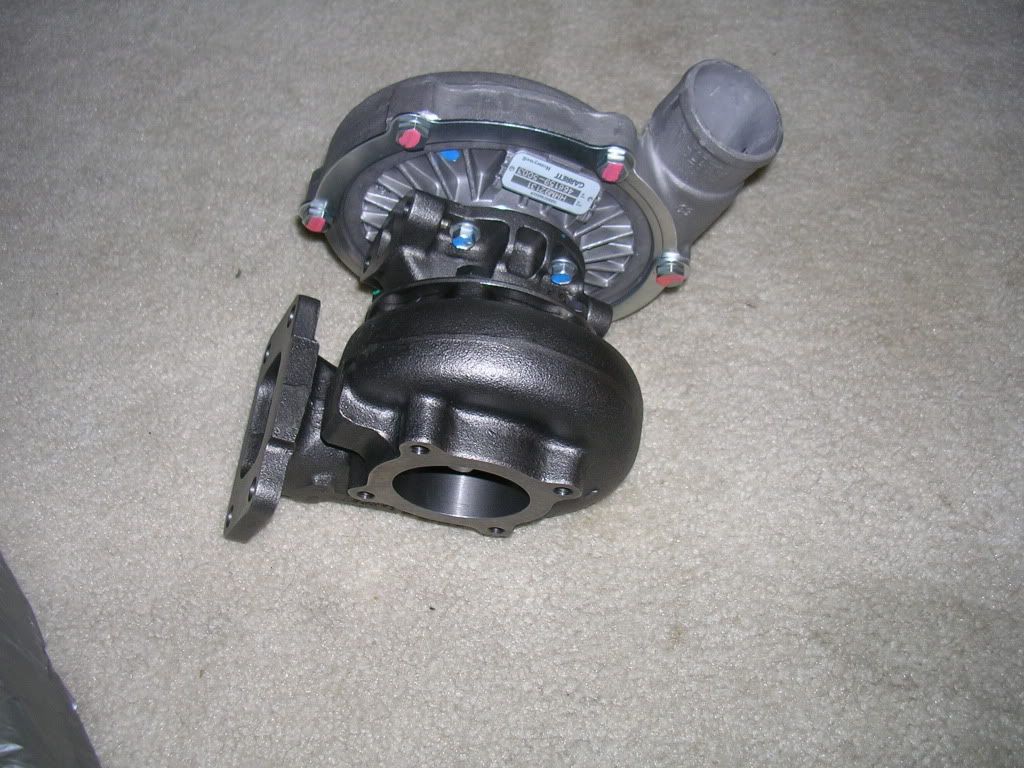

    Garrett t3/04e .60/.63 stage 3 57trim. Bought it a few years ago.

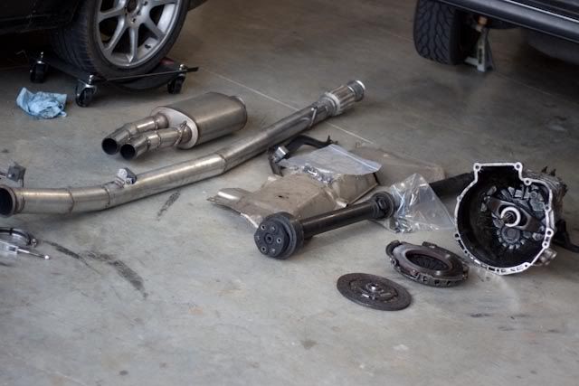

    Finished up the exhaust,3in w/vbands to Magnaflow 3"-2x2.5" muffler.

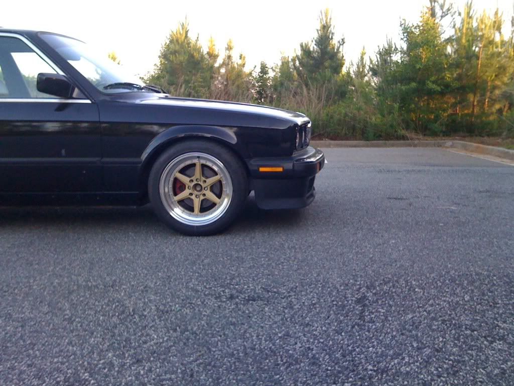

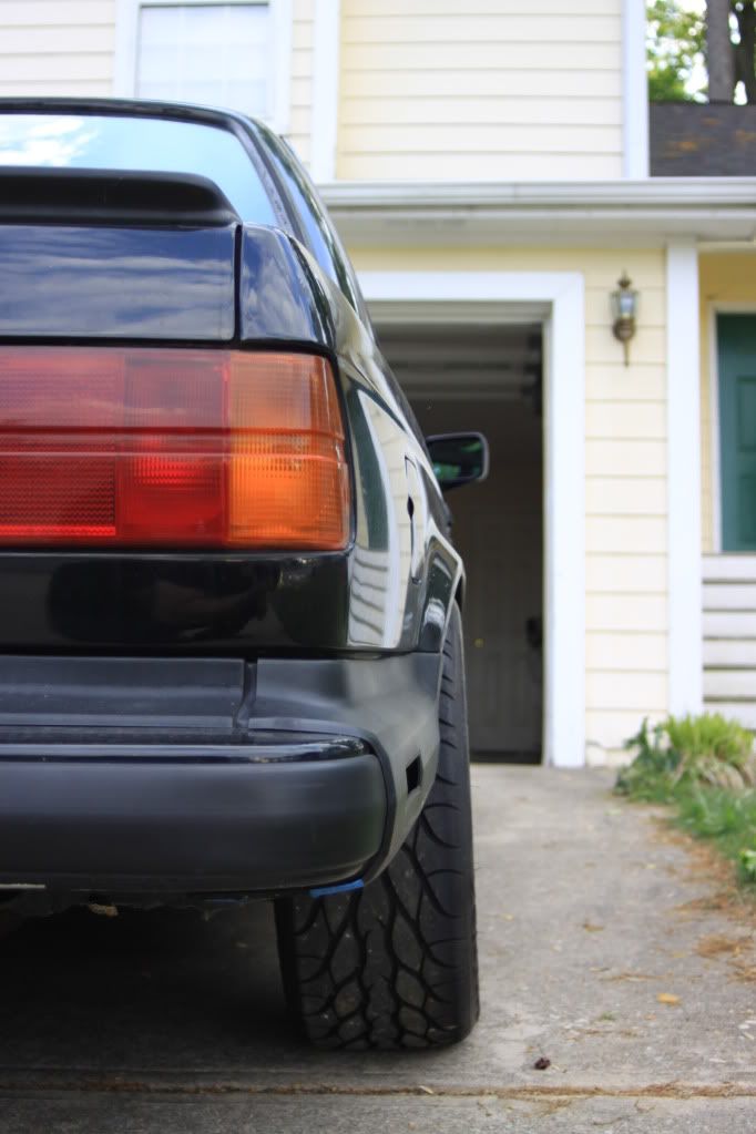

    New wheels 16x8 xxr 15 offset
    Next to a bottle cap.
    BFG kdw's 225/45-16
    Mounted

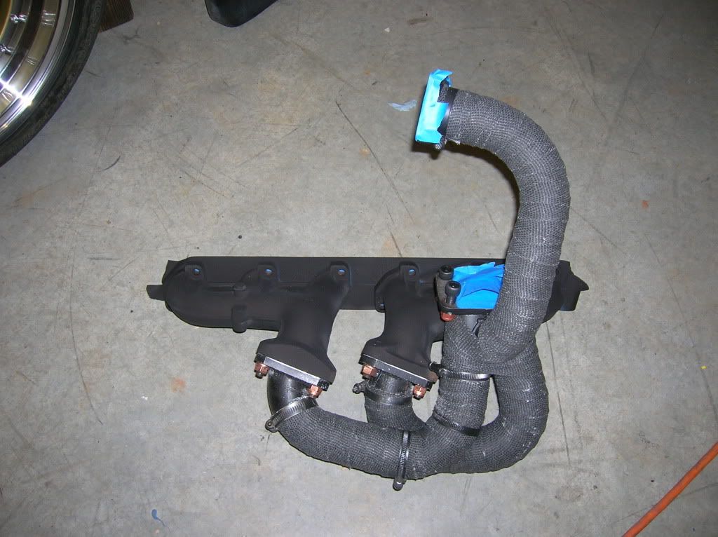

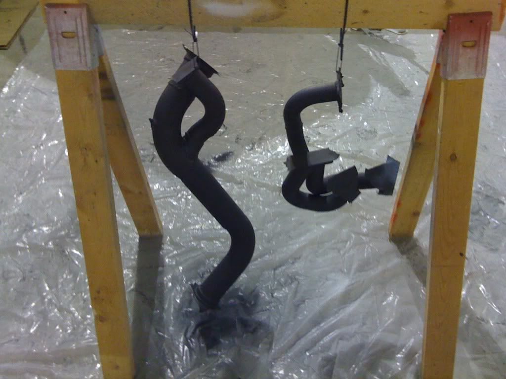

    Ceramic painting the pro turbo adapter w/ 50mm waste-gate provision and matching down tube

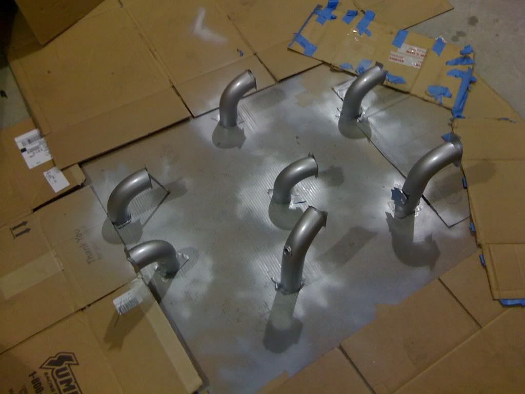

    I thought my intercooler pipes were kind of ugly, so I grew some out of this cardboard.

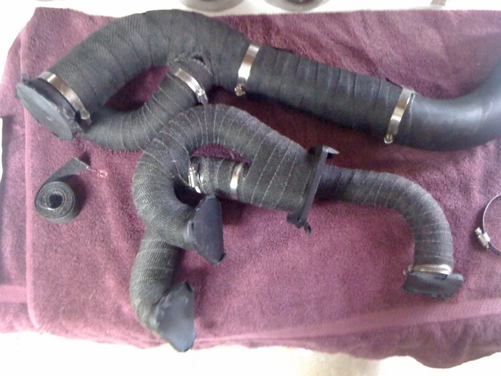

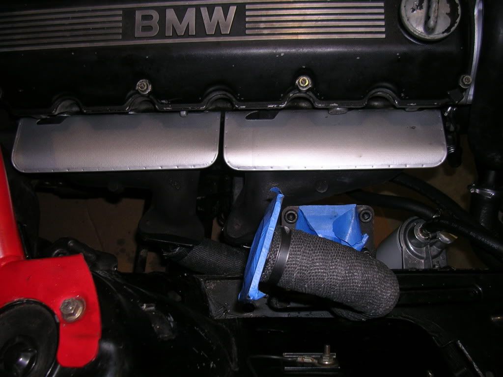

    Wrapped the manifold and downtube after the paint had fully cured.
    It took about 3 days for the wrap to fully dry, but after it did. I super high heat silicone sealed it.
    combined the manifolds

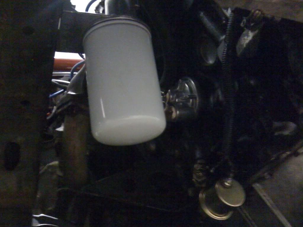

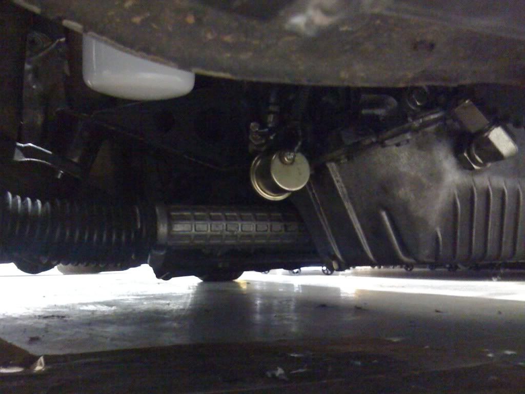

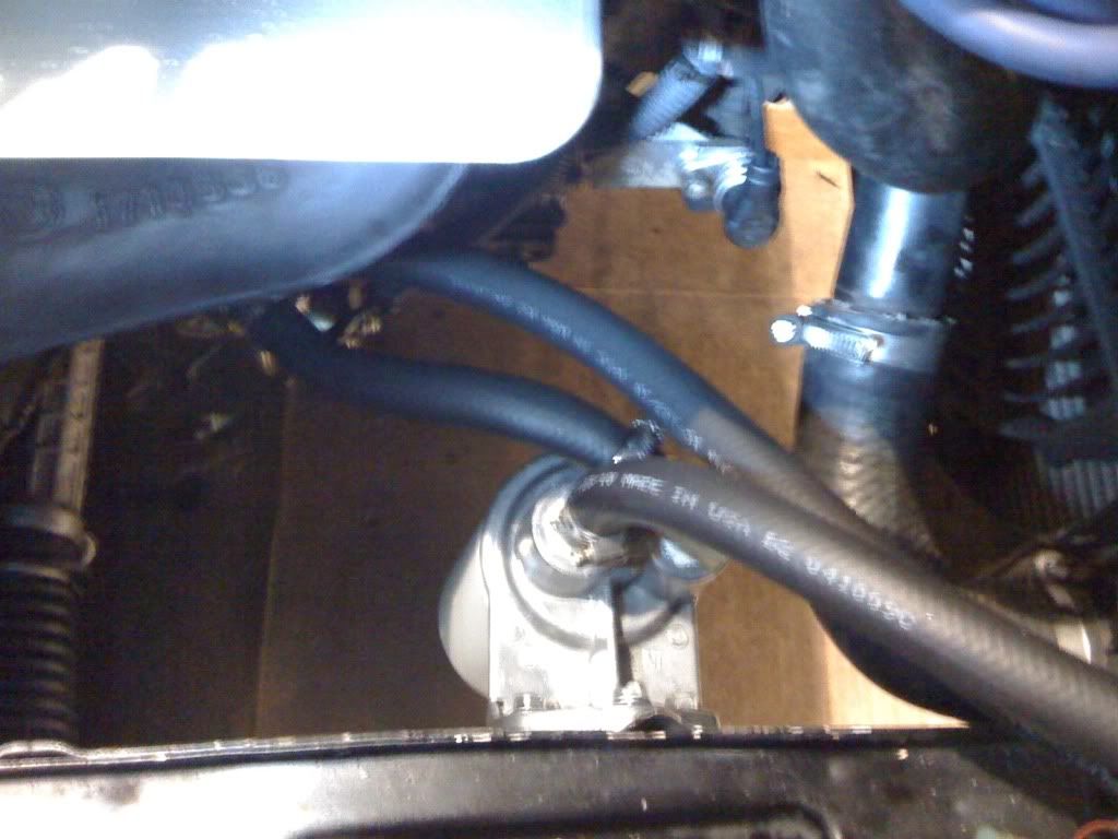

    Relocated oil filter

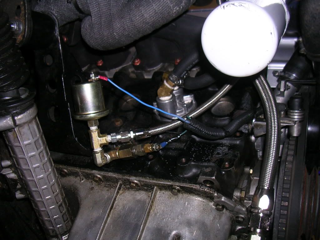

    Turbo oil supply -10an
    Supply and drain. Supply is -4an with a .065 restrictor.

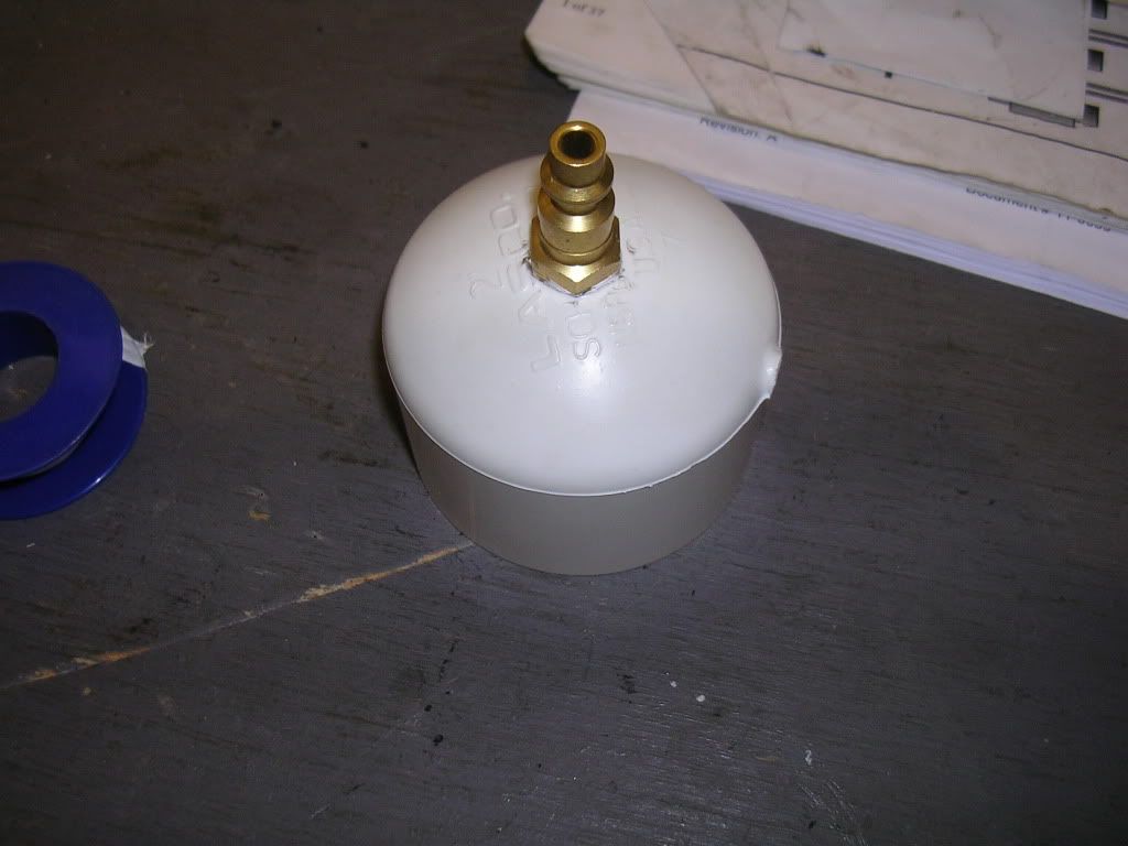

      Made this to test for boost leaks.

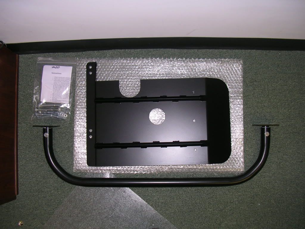

      And still need to get Roberts skid plate installed, it's been sitting right here since I got it. =( I need a welder.

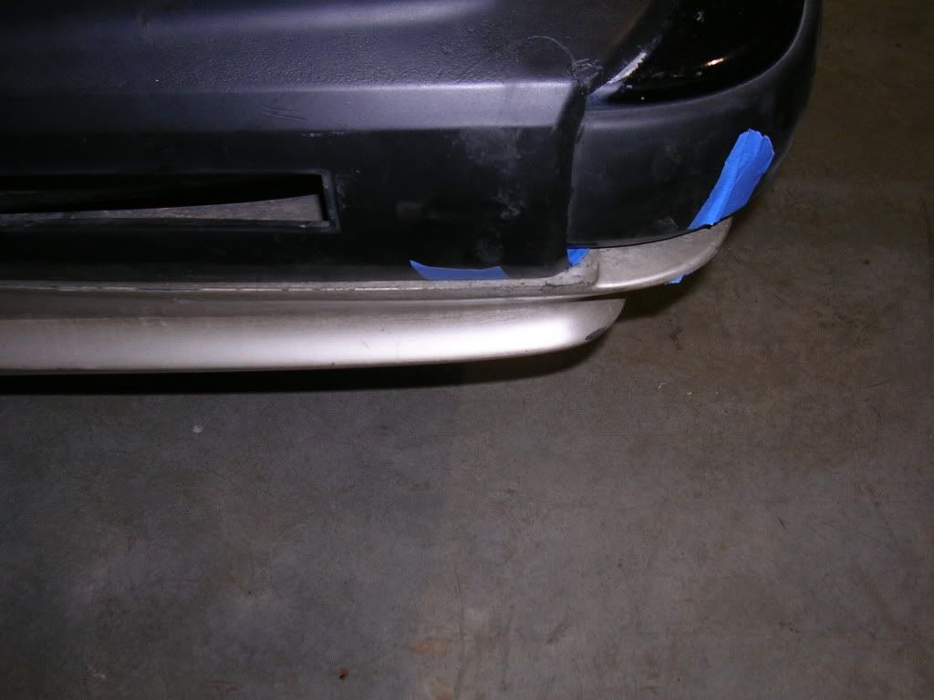

      I got the front end on, had to cut quite a bit away, but it still looks clean imo. Now to figure out the fog light situation.

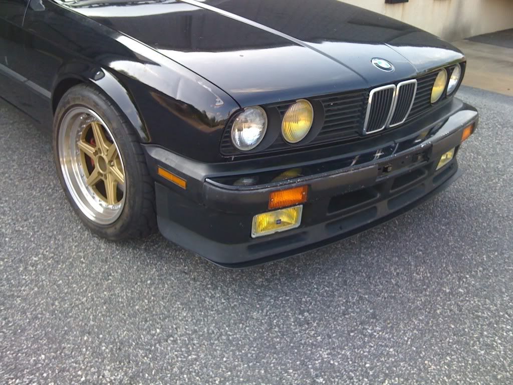

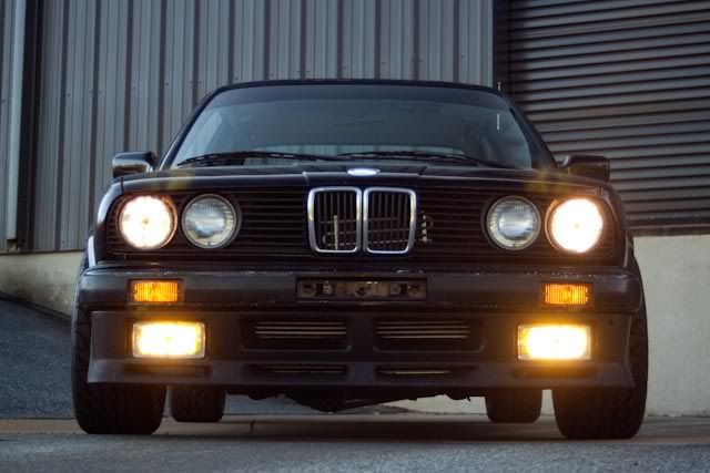

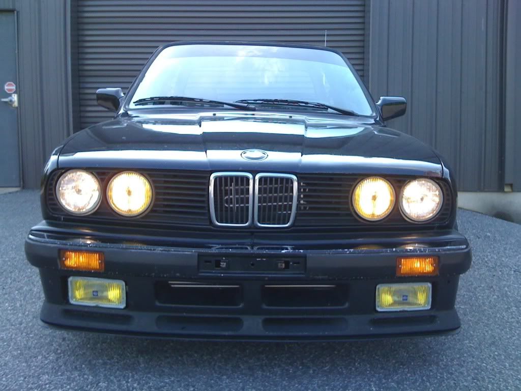

      I also picked up a set of Hella 550 yellow fog lamps to try and fit something in the stock location. I saw em at the Summit store and thought "man, those look like they could fit!" So I bought them completely sans measuring.
      Turns out they could, with a bit of work. I cut open the gaps some. And had to notch the valance for the new mounting location.
      Lots of measuring, and a couple of holes later, they fit.

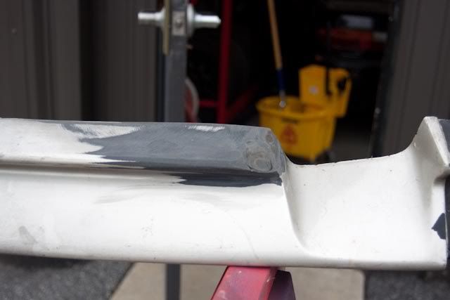

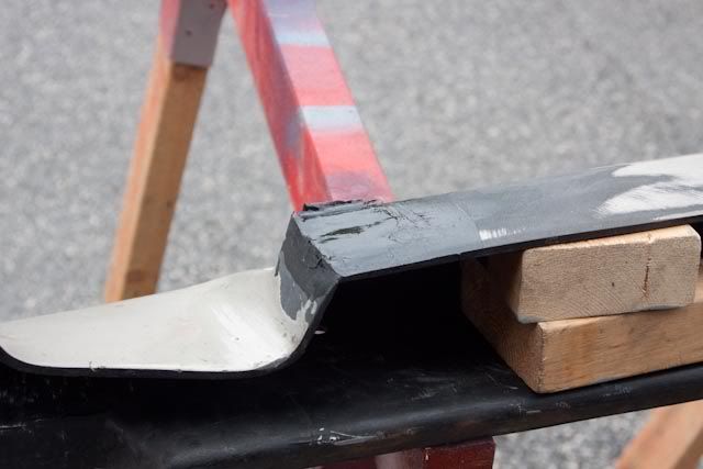

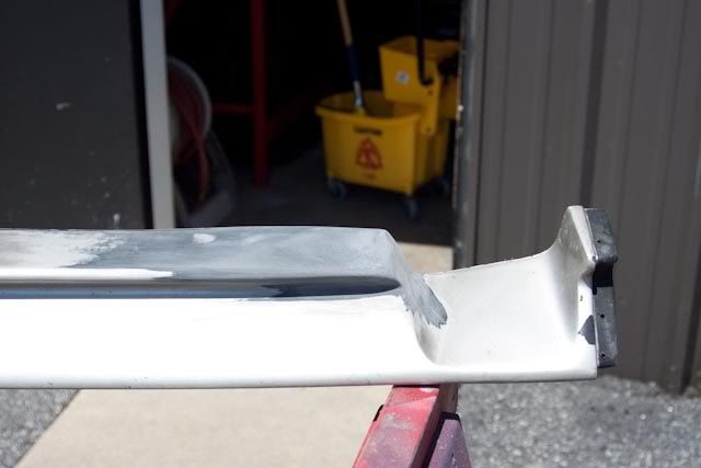

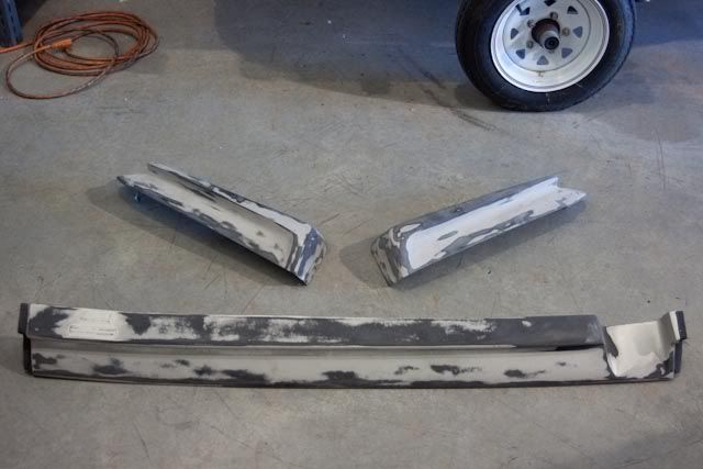

      The Zender rear valance had a spot that had been melted by the PO's exhaust. So I started working on that.
      3m bumper epoxy should do the trick.
      It's working nicely. Have another coat and some more sandind to do.
      But I decided to go ahead and start the sanding on the side pieces too.
      It was a good full days work. But I got a lot accomplished.

      Couple more updates, didn't get nearly as much as I wanted to get done this weekend. I partied way too hard. But I did get some more work done on the Zender. I think it's repairing nicely.
      I also got everything pulled ready for the new clutch.

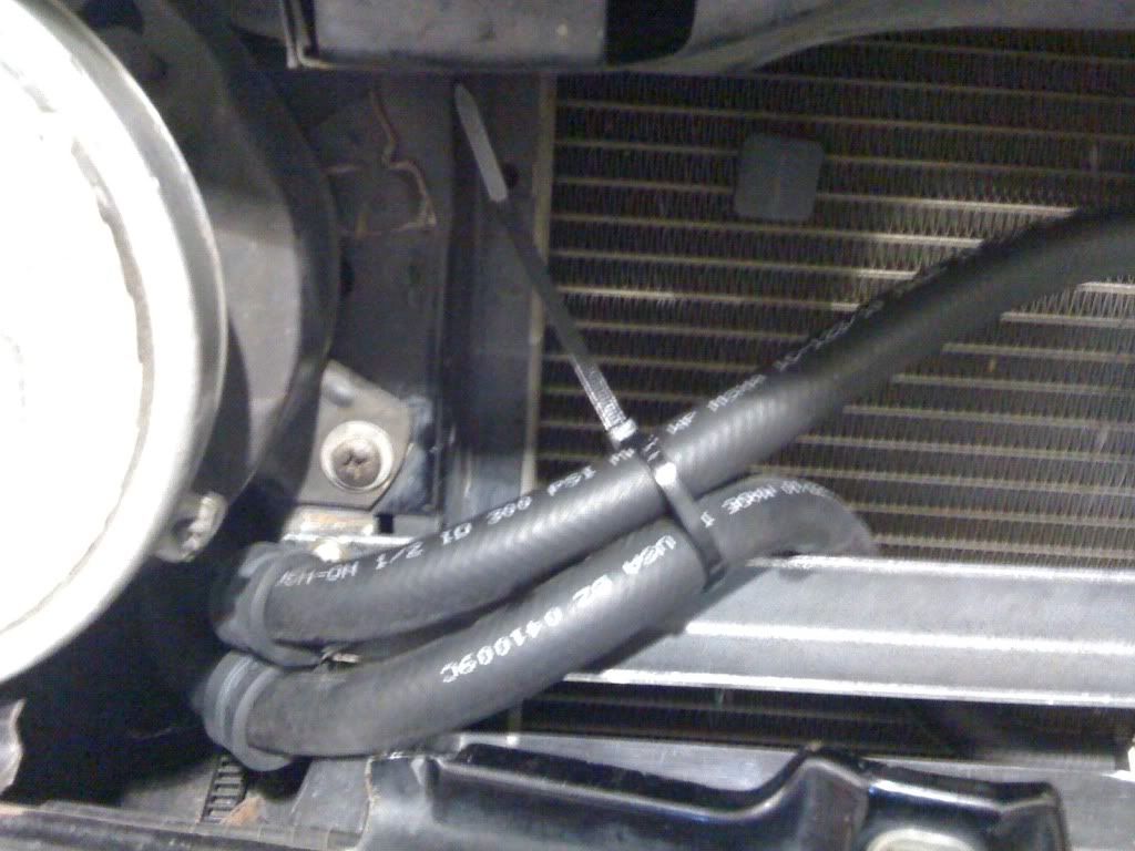

      Aftermarket oil cooler

        Well I finally just sucked up the heat and busted ass for a day.

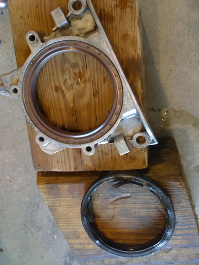

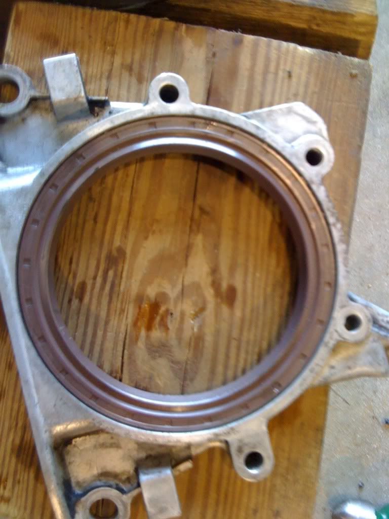

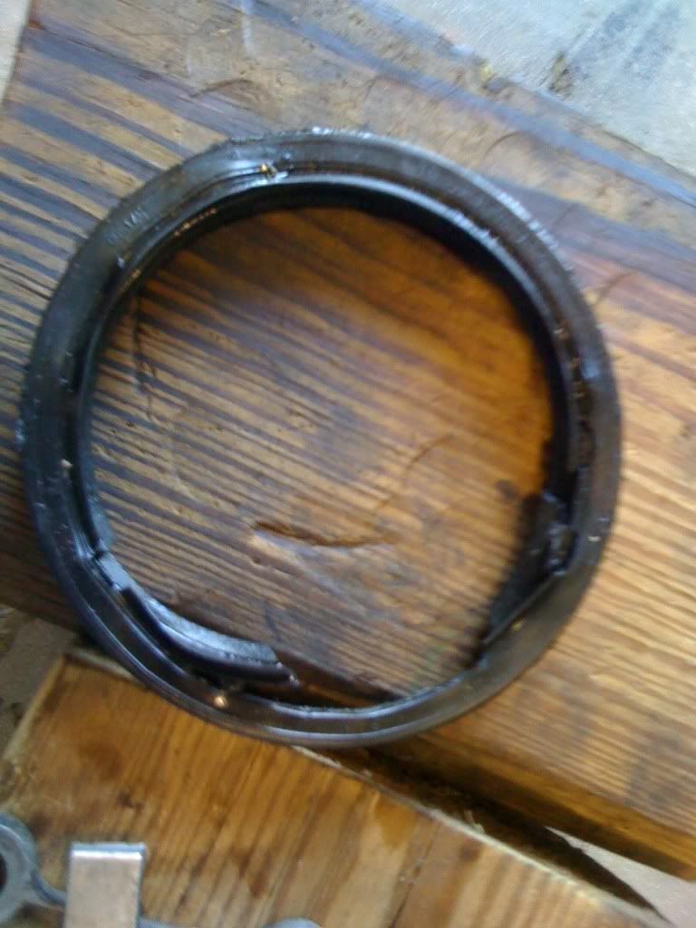

        I got the rear main seal changed out. It wasn't leaking bad earlier, but I figured why not while I'm there.
        It proved to be a pain to get the old seal out.
        The machined flywheel back on.
        Spec stage 3, sprung 6puck w/hd pp.
        She is back on the road now, for a grueling 500 mile break in period... It's hard to baby it, but at least its back on the road.
