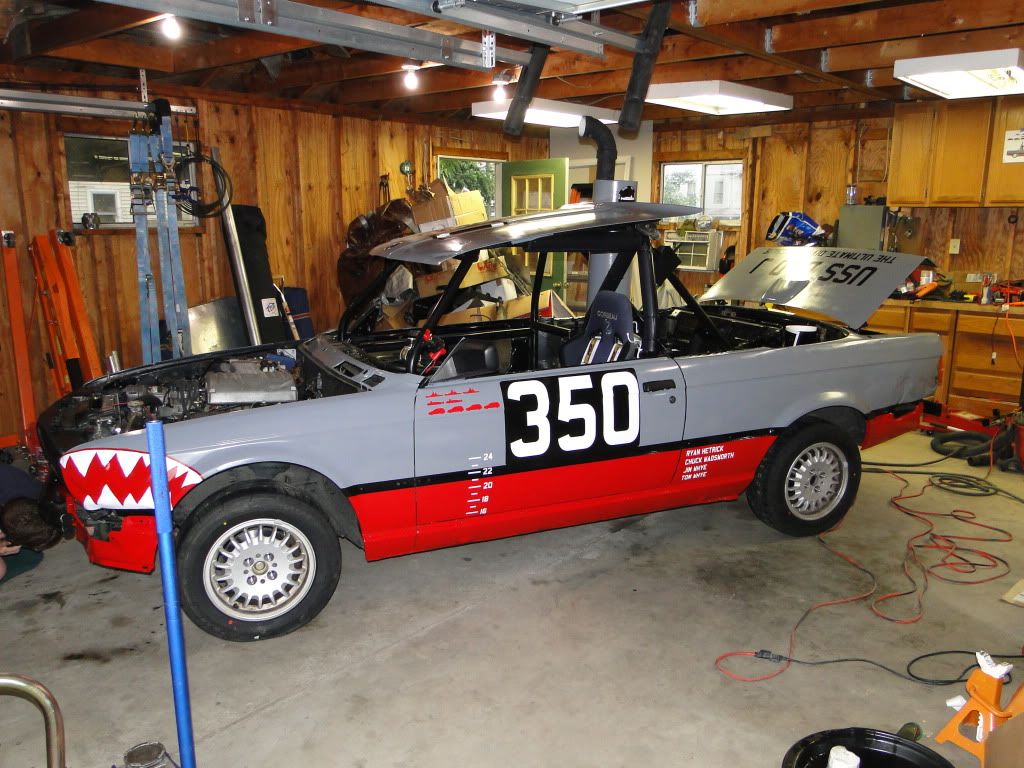

            June 11-12, 2011
            With the exhaust made we set about refitting the front bodywork. The hood was modified slightly to clear the plenum, and holes were drilled for hood pins. That was the easy work. The passenger fender needed a lot of massaging to clear the exhaust. We decided to go with a box flare of metal mesh to not only clear the pipes, but also allow some heat to escape.
            We only did it to the right fender because we like asymmetry, just look at Tom’s head.
            We roughed up the paint, and opened the door to let the car out for some test running with the new exhaust.
            So fast the camera can’t catch it, or maybe it was just the camera man (Tom)
            Street tested, neighborhood approved. Don’t worry there wasn’t anyone to hurt by driving the car. All that is there are a playground and a church.
            The exhaust works as promised, and the car was prepped for paint.
            The fender really is the crown jewel of this machine.
            With the bodywork complete, we set about making the car beautiful. During the first coat we thought for sure that we had ruined it. It looked much uglier than when we started.
            But after a few coats it was beginning to look presentable.
            While the parts were drying on the line…
            We enlisted the help of the future wives of Ryan and Chuck. At least they can’t say they didn’t know what they were getting into.
            Britt takes care of some of the lower painting.
            And Danielle gives the car some much needed dental work.
            Not too shabby.
            It’s starting to look like something now.
            A little black to separate the two tone, and it’s all pretty.
            A couple quarts of Rustoleum and some foam rollers can really do wonders.
            Like it was meant to be.
            Looking good on the “race rubber.” They look so little.
            Complete with the periscope.
            Danielle also did some rehab work on the emblems.
            This was our inspiration. We think we pulled it off pretty well.
            For more pictures, check out our album from this work day.

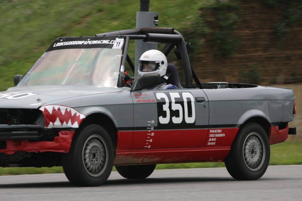

                  June 18, 2011 – Race Day 1
                  We woke the next morning to find that the kill switch was left on all night, and the car now had a dead battery. While we charged the battery with Ryan’s truck we performed checks on the car for what seemed like the millionth time. As the start of the race approached we attempted to start our Lemon, but had no luck. A push start and a few laps around the skidpad where our pits were, seemed to do the trick, and the car would stay running. This wasn’t a good way to start the day.

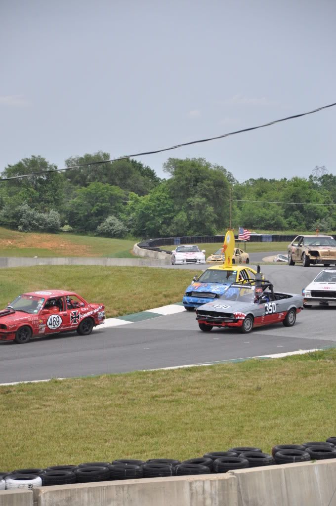

                  After an exciting driver’s meeting Ryan suited up to take the wheel for the first stint.
                  On track for the formation laps everything seemed fine. Everything was still attached, there wasn’t any smoke, and all gauges read normal. This was nice.
                  The green flag drops and all hell breaks loose, at least it sounded like it was from the cockpit of the BAD J. In any left turn there was a terrible racket that sounded like a tire rubbing. After a few laps Ryan pulled in to have things checked.
                  He couldn’t believe it when they told him that there was nothing rubbing, so they banged on the right front fender and exhaust with a sledge hammer just for good measure and to appease him.
                  Back on track again, still same horrible grinding noise in left hand corners. Ryan radioed to tell Chuck to suit up for his stint of troubleshooting behind the wheel.
                  Chuck took the wheel and immediately heard the same noise. A few short laps later Chuck was in the pits not only for the noise, but the temperature gauge was pegged. As he came to a stop steam billowed out of the car, not a good sign. After some investigation it was found that the radiator cap wasn’t sealing in the neck and all hot water was being sent directly to the overflow, and when that filled up, onto the hot bits of the engine.
                  Ryan was sent for a radiator cap that would fit a deeper neck, and the rest of the team set about removing anything from the front of the car that would impede air to the radiator. That meant our spiffy grille with the 5.0 emblem went on the parts pile.
                  After 2 hours of fighting hillbillies and drifter traffic Ryan made it back with a cap that was slightly longer, but still slightly too short. A genius plan was devised and the o-ring from one cap was removed and stuffed into the neck, that proved to be just enough to allow the cap to seal.
                  With the car ready to return to the track Jim suited up for the first time.
                  He made it onto the track just in time to lead a parade of caution laps. Many, many caution laps
                  Finally caution was lifted and Jim completed an uneventful first stint, as did Tom after him. This was the first track or racing experience either of them had ever had.
                  Ryan then got back in the car and felt right at home as the grinding continued, maybe even worse than before. After a couple laps it began to make the noise in right hand corners as well. Ryan yet again brought the car to the pits. A few laps around the skidpad with various team members hanging off the car, still found no solution.
                  The car was put on jack stands and Chuck crawled under only to find the transmission mount bolt holes stripped and the bolts no where to be found. The sound was actually the ends of the u joint rubbing the transmission tunnel. We were able to put longer bolts through the stripped holes and use lock nuts to make sure we didn’t experience a similar problem again.
                  Ryan returned to the track able to fully concentrate on the racing, and found the car to be much better than he thought it would be. He was able to pass (and some times be passed), the handling wasn’t bad for stock springs, and shocks of an unknown vintage.
                  After a longer stint he returned to allow Chuck a drive in the “new” car.
                  Chuck took to the track and like Ryan was amazed at how well the car behaved when you weren’t constantly slowing down to make sure something wasn’t going to fall off of it. Chuck’s elation would soon end as coming out of the final turn before pit in his right foot went to the floor and the car idled along. He coasted to a stop shortly before pit in. The shortened accelerator cable no longer possessed its much needed, but poorly crimped, stop.
                  After a short tow, the team set about fixing the now frayed cable. It wasn’t possible to use a conventional cable stop anymore. After a poor attempt at soldering (who really thought that would work?) the team resolved to fix it by using everything they brought with them. Washers of various sizes, electrical tape, a cable clamp, and probably several other items that we don’t know what their actual use is, were attached to the end of the cable.
                  That fixed that problem and Chuck suited up to return to the track. The only remaining thing to do was refuel. That is when the team realized that their poorly designed fuel jugs were going to take a very long time to refuel the car. With the right angle the fuel would flow without spilling. Thankfully there wasn’t much time left in the day at this point, so not much more fuel was needed.
                  Chuck returned to the track, but only a few laps later returned to the pits, radioing that he had no oil pressure.
                  Obviously this was cause for concern. When the car was brought in the engine was not making and knocking or tapping sounds, but the team looked deeper. They decided to test if the sending unit was working. They removed it and cranked the engine, and oil squirted. All good, get back on the track.
                  Jim put in a short stint to get the feeling of the new and improved car.
                  Then Tom got back in the car his turn behind the wheel. He put in steady laps, and dropped his times again.
                  Chuck took over with about 45 minutes left in the day. It was thought that he deserved some undisrupted time in the car. He put in steady laps, and was getting more comfortable in the car as he picked up his pace (this time ignoring potentially damaging news from non-functional gauges). His fastest lap of the day was the last one. When the flag dropped at the end of day one the team had completed 99 laps. Considering the time lost to the various issues throughout the day, the team was pleased with the result. If the car could hold together for the rest of the race there was no doubt that they could double the laps on day two.
                  Immediately following the end of the day one, and sucking down some much needed food, Jim and Ryan topped off the tank and went to get gas and a replacement oil pressure sensor. With that replaced, fluids checked, and race day fixes double checked, the car was put to bed for the night, and the team followed shortly after.
