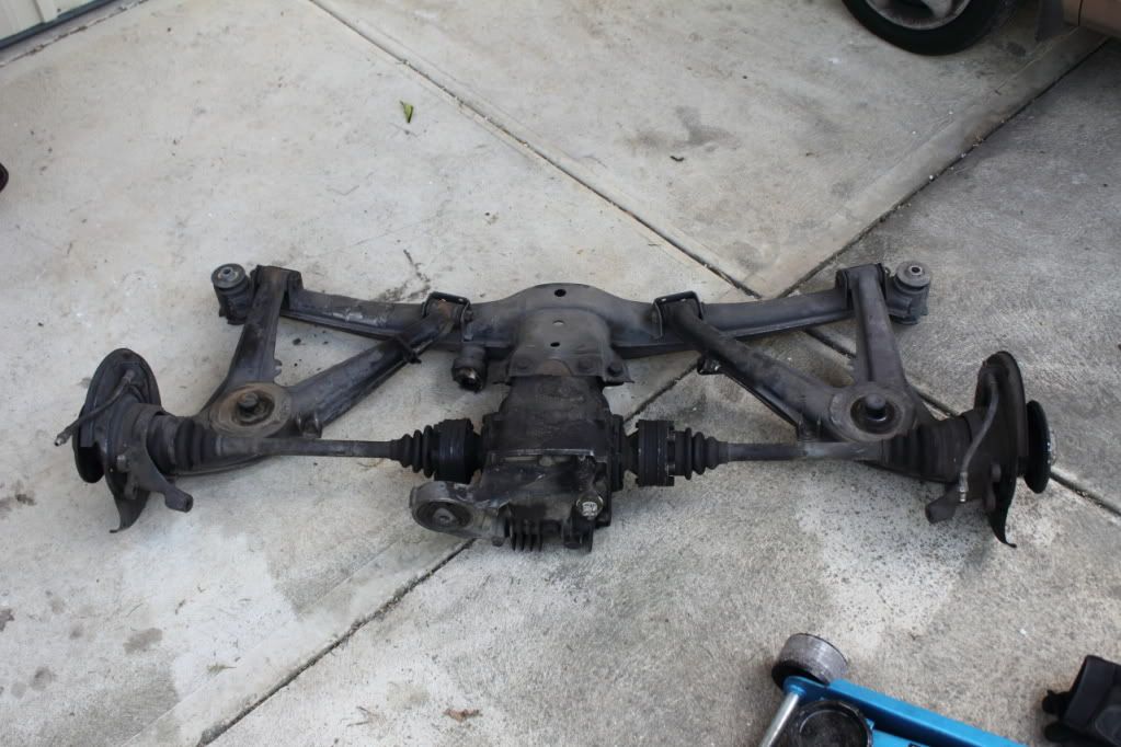

            So I finished the car up and have been driving her for a few weeks now.
            Anyways Got the rear subframe back together.

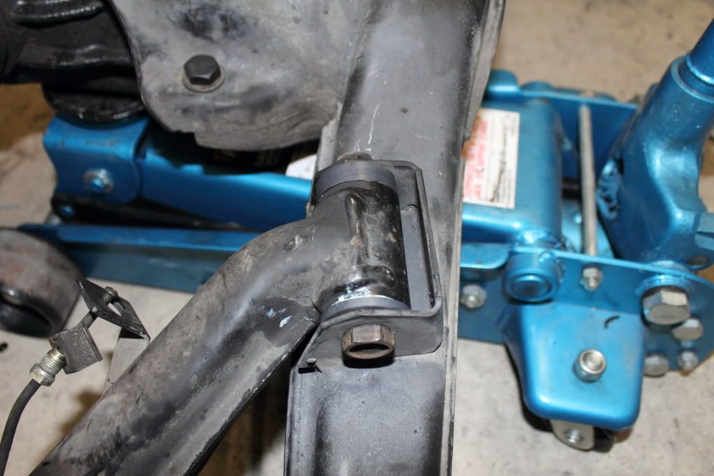

            Then in the process of putting the diff bush in this happened.
            That was a head ache as no one sells just diff covers here so I had to buy a whole diff, so now a have a 3.73 open wheel small case diff in the shed.

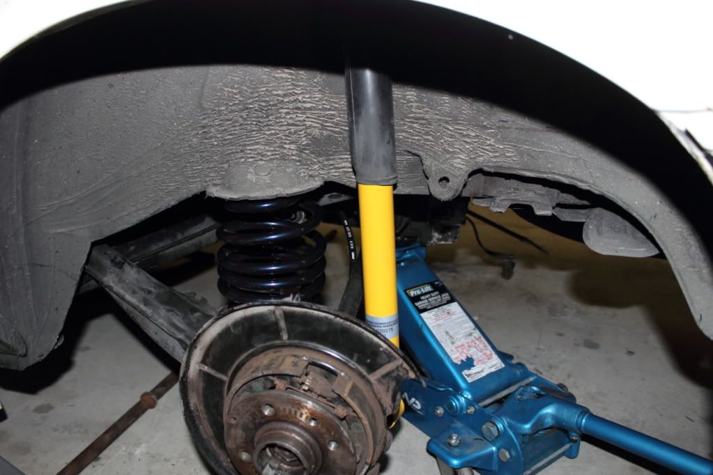

            Oh well might coming handy some day. Next was rasing the rear subframe back into the car that was a real pain in the ass I would highly recommend two car
            jacks as doing it with one is hell. So after a few hours of swearing and beer breaks I had it in.

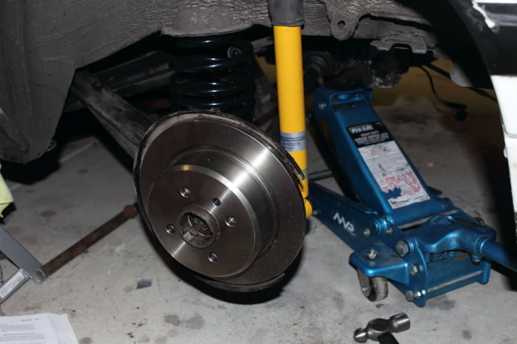

            Hand break and shocks and springs back in.
            Rebuild break calipers.

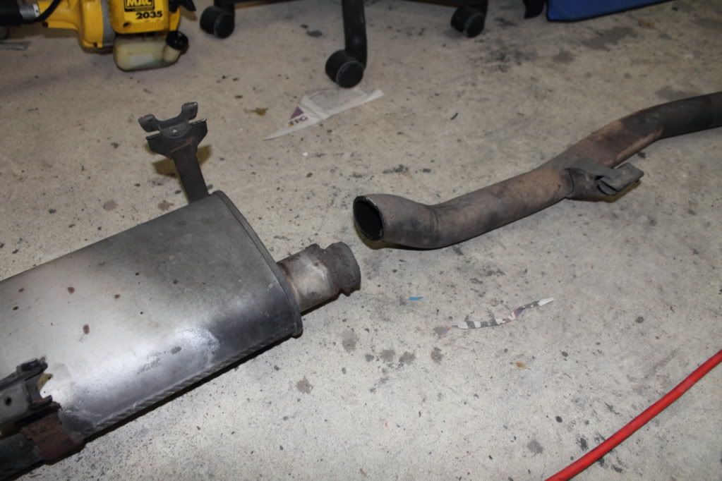

            There was also an issue with the exhaust as you can see the hangers were welded on to the muffler, making it impossable to get on. So chop chop lol.

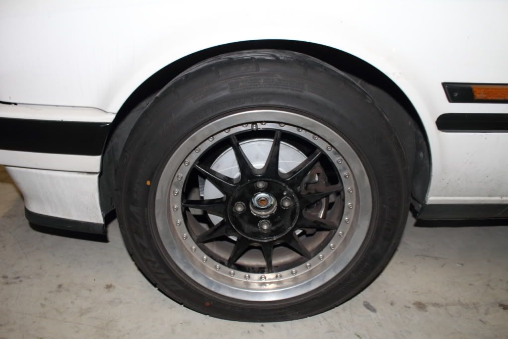

            Then the final issue. Went and put the wheels back on, and oh look.
            So the angle grinder came out
            And all is good now.
