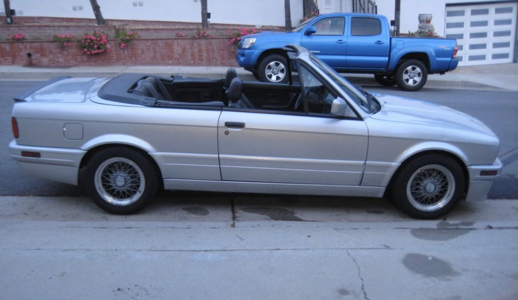

          I scaled back my plans for this car. I decided that all I really need is for it to be reliable and presentable. Just in time for the first weekend of spring...

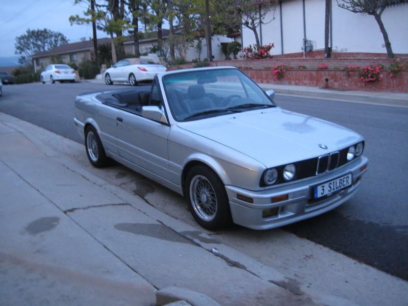

          Cleaned up the front with new lights and a euro plate.
          Stance might actually be higher than original M-tech height :( but I like it. I'm running Koni shocks/struts and Dinan springs; a 14mm Dinan rear swaybar, and stock 21mm front swaybar mounted m3-style; m3 offset CABs and IE subframe and RTABs. The freshened up suspension together with the quicker 95 m3 steering rack and 4.27 torsen diff. makes the car so much fun that I don't mind the autotragic ;)

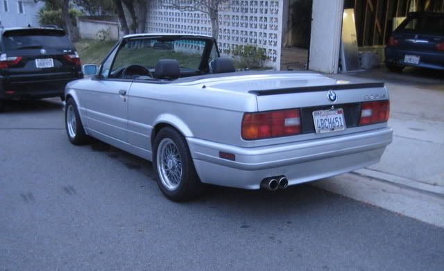

            Cleaned up the rear. No more 3rd brake light and holes from previous spoiler. Also added a euro plate filler.

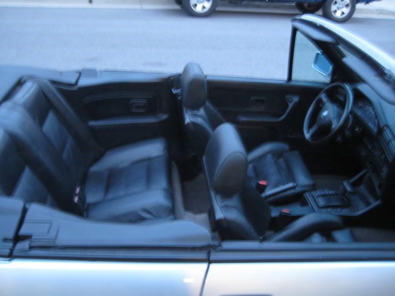

            No more ripped up seats. I fixed/replaced my original leather.
            It's got it share of blemishes, but I can live with them. I feel good knowing that I saved this M-tech from being parted and sent to the breaker.
