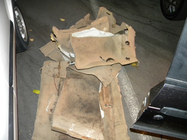

    We've cleaned a lot of carpets, spray nine is the best, even better then simple green the problem is this cars carpet is trashed.
    I have other carpets in stock just didnt want to deal with taking the carpet out. At this point I think I will just remove, this will also let me check to make sure no rust spots in the usual spots under the carpet.
    No Rattle cans on Guten Projects... Ive seen sprayed carpets, in a matter of months it wears off. I also want to keep the tan interior.
    I actually used a concoction of simple green and castrol purple degreaser. you should have seen my carpet.. Looked like a family of badgers lived in there

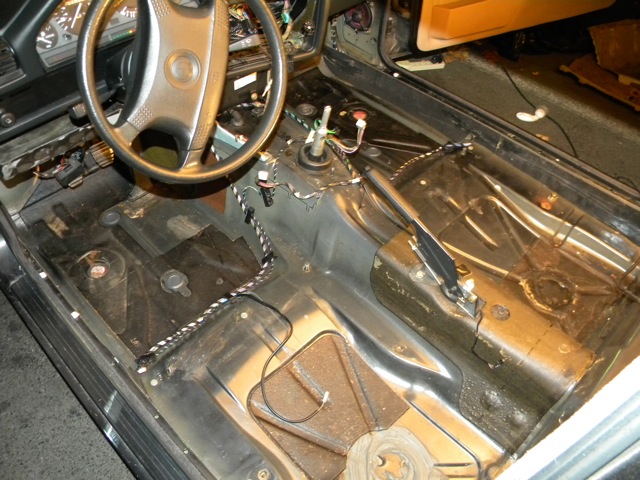

        Ok, so Guten 1, carpet 0.
        Decided to remove altogether. Not sure how but there were bleach stains on the carpet which would never come out. Also removing the carpet allowed me to inspect for rust under the carpet and address if needed.

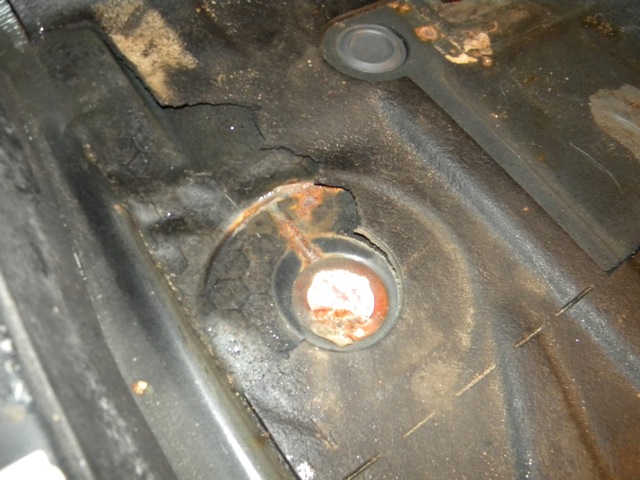

        Gave her a good vacuum and inspection for the common rust spots.
        Only spot is some surface rust, which will get cleaned out and get POR15.
