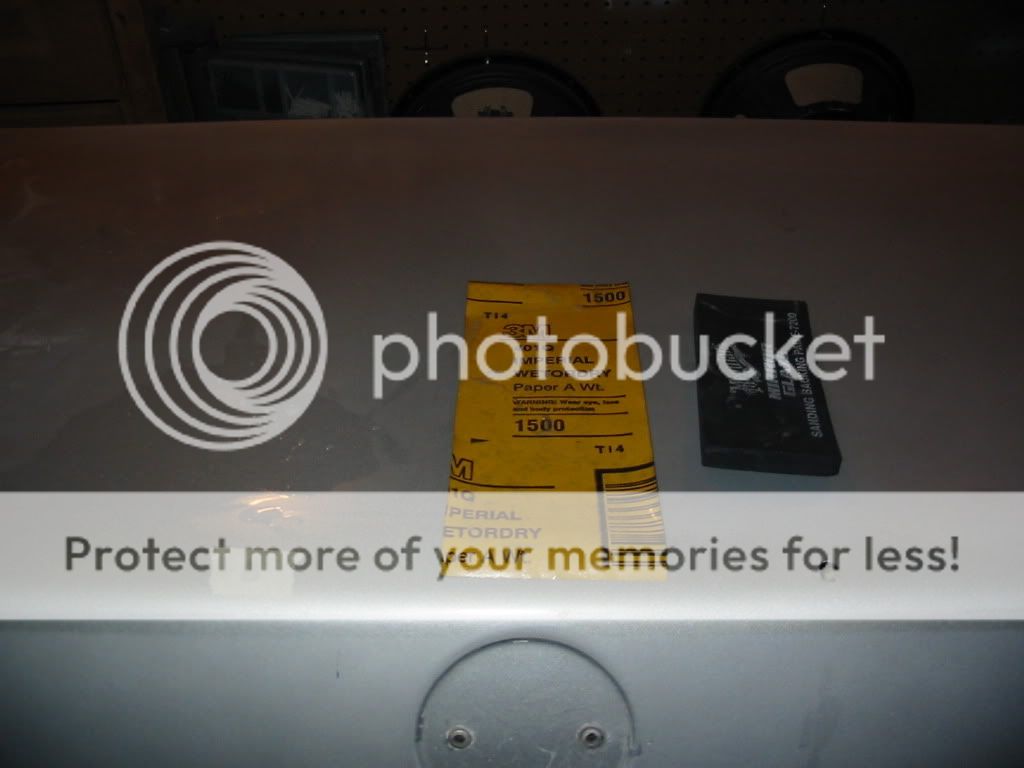

        My first step was to clean the surface. Then I soaked some 1K sandpaper in water with a bit of dishsoap. Then I used a spray bottle with the same liquid. I used a sanding block to help with high/low spots.
        I sanded in a circular motion with constant lubricant. I only did half of the trunk so I can see the difference between the two.
        Then I went with 1.5K paper.
