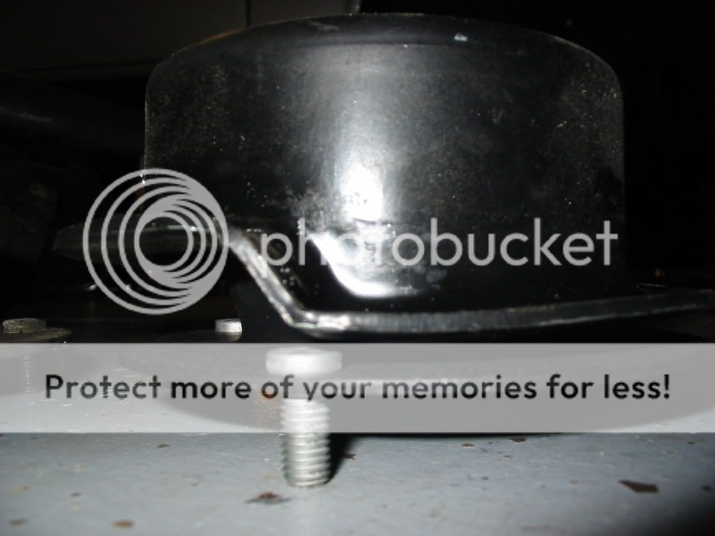

            Trans brace. I need to get mor bolts as the e21 mounts are larger than the e30's
