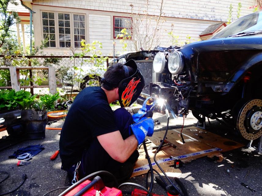

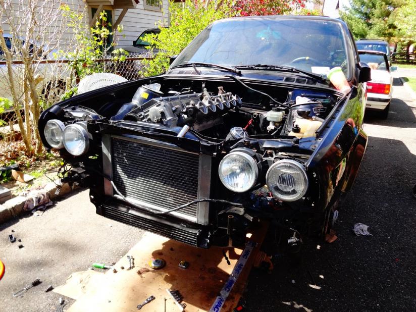

        I focused most of my attention today to getting the radiator and the oil cooler in place. The radiator was bolted in easily since I did most of the work the day before. Ive read that people have used the M20 oil cooler. I decided against this because the s38 cooler is larger and the hoses that come from it are set up to go to the oil filter housing on the driver side of the engine. This was the final position where I wanted to mount it.

        Welding the brackets to hold the cooler.

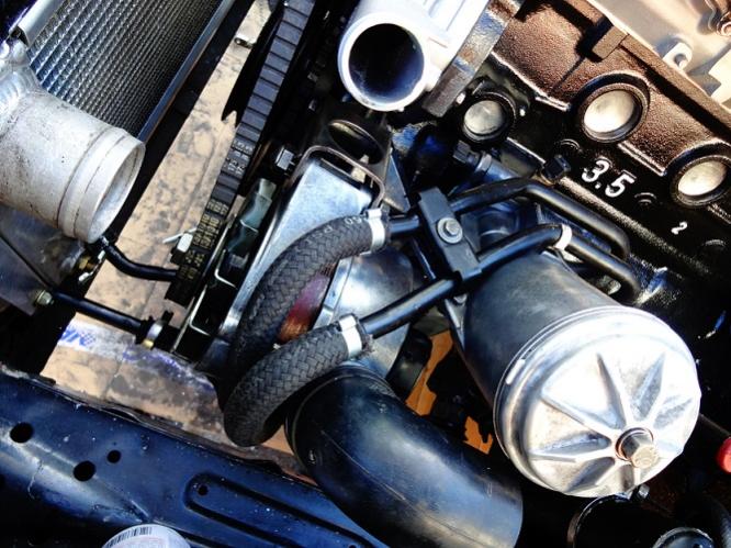

        Fits like a glove. The lines were snaked under the radiator and along the side of the alternator.

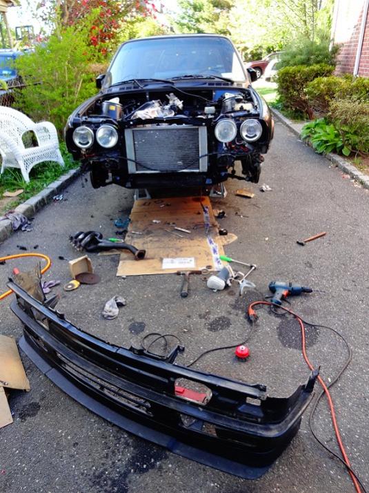

        Looks mean without the front bumper and valence. May run it without those parts for a little.

              Nice weekend update. Those oil cooler lines and clamps do not seem adequate, did you end up using the s38b36 cooler?

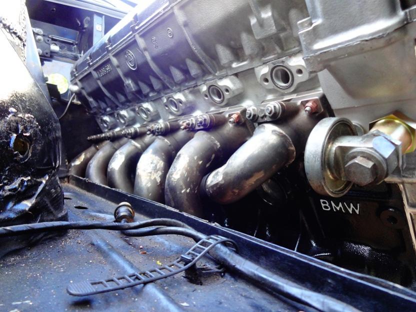

                Closing up holes on Tom's headers. Came out great, got a ton done this weekend. I think he is at a good place now to be done in a week or so.
                  Everything was from the s38b36. The crimp clamps and lines are stock.

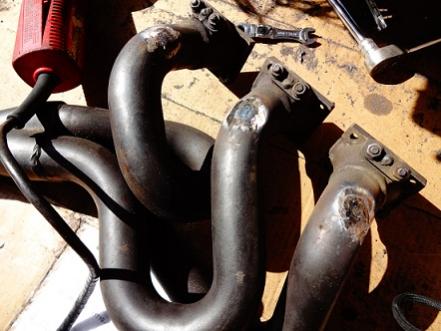

                  I was grinding the header smooth and one of the blanks you used to fill the hole fell into the header. Need more amps on those welds grasshopper:p Seriously thought you helped me out big this weekend.
                  Spent several hours just trying to get the headers to fit. After some serious frustration, I decided to chop the extensions that used to go to some exhaust/emissions system to get them to fit better.
                  To finally get them to fit i had to bring the forward set of headers in from under the car then the rear set had to come in from over the top. The corner of the floor on the passenger side had to be hammered up about and inch. Several of the studs had to be removed to get it to all fit. Pretty pleased with how they look.
                    those crimp clamps are not stock. This is stock:
                    I spent a fair amount of time and money on that portion of my swap to safely connect the M3 oil cooler to the s38b36 oil filter housing and know it would be a serious mess and possibly cost your engine if it blows.

                      #235
                      ahh I wrongly assumed that it was stock because that is how I received it when I bought the engine. I will look into other options then clamps. Any ideas on how I can use the threaded connection to the cooler and still maintain the same connection to the filter housing or how I can thread it into the filter housing? Aftermarket setup?

                        I was grinding the header smooth and one of the blanks you used to fill the hole fell into the header. Need more amps on those welds grasshopper:p Seriously though you helped me out big this weekend.
                        That is what friends do when others are in need :)
                        In my defence first time welding with that style wire and no gas. I had it turned up to try and get it to sink in but it was blowing through the tubing. That other one you ground down needed slight bead on the middle plug after grinding. I think it came out a lot better than trying to flip in the flaps and weld those up.
                        Good job on getting those on.
                          I ended up having ~6" extensions welded to the s38b36 hard lines and threaded to connect with the e30 M3 lines rubber lines which uses a nut to attach.
                          Or you can buy VAC's adapter to run custom AN lines: http://www.vacmotorsports.com/catalo...pter-plate.htm
                          If you are using the s38b36 oil cooler, the easiest solution is to source the stock lines which is also the safest.
                              [ATTACH]70478[/ATTACH]
                              If you have the correct fittings, hose and hard lines and all that's "wrong" is the type of clamps, you can have the crimp ferrules installed.
                              CarQuest (or any shop that has the "Gates Hydraulic assemblies made while you wait" sign) can do it.
