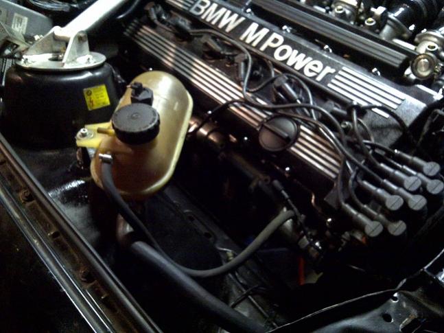

        I welded the tabs to hold the coolant bottle the other day. I'm happy with this position. Warmed her up and began to bleed. After She came up to temp and it seemed like the engine was bleed, I decided to take her out for the first break in run.

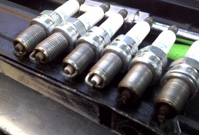

        Unfortunately after making it around the block the engine sounded like death. Backfiring and no power. Pulled the spark plugs which I just bought today. You can see a pattern, where they are the same in pairs. I am guessing it is because the 3 pairs of throttles aren't sync to each other. I also think the injectors could use rebuilding. They were very nasty when I got them and I regretted not having them sent out and flow tested. The tops of piston 1 and 2 were wet with fuel.
        The AFPR was set to the stock 3 bar.

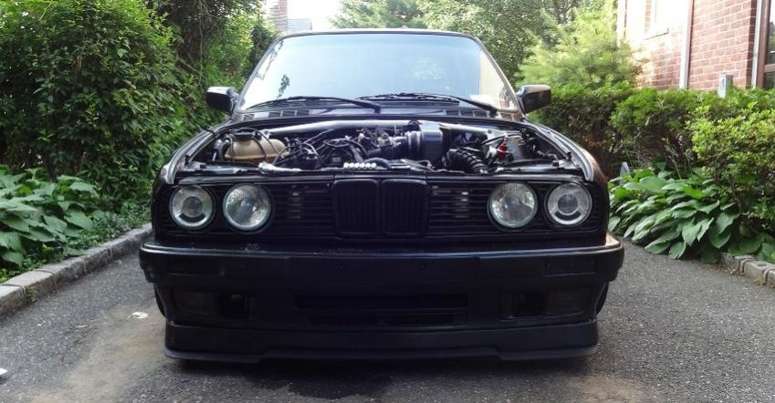

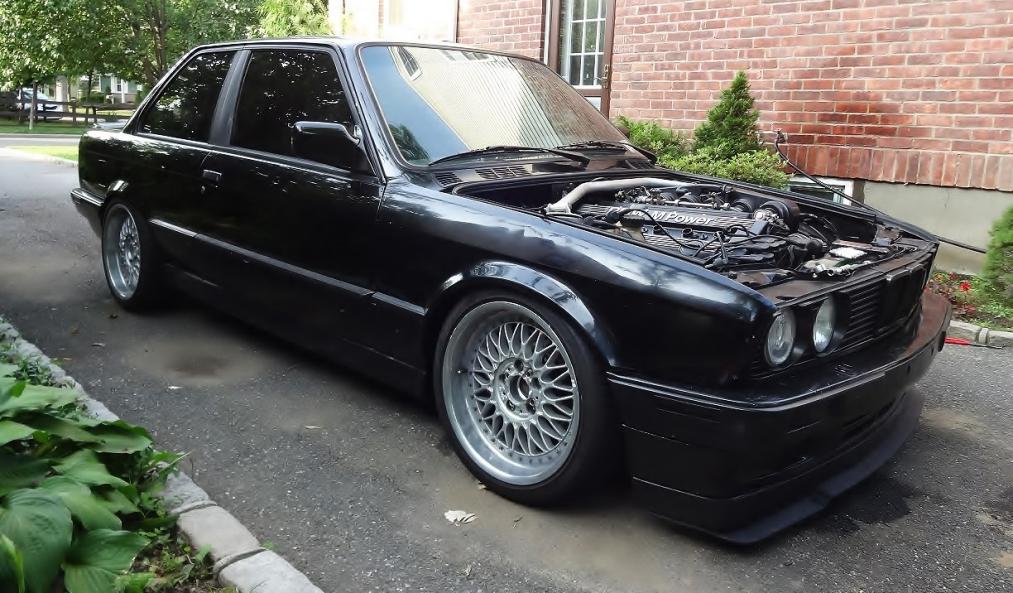

        Some recent pics...

              Should hold for hours...
              Can you hold the throttles open when you prime the rail so that you can see if any of your injectors are leaking? Maybe use a dye leak test kit?
              Although if it holds pressure that long, that's a very slow leak. It would drop immediately if you had an injector stuck open.
                        How's your intake air temp sensor doing?
                        When I had the plenum off during the first starts I didn't notice any fuel leaking out of the injectors after shutdown. I took the injectors off and sent them out to VAC. Ill post the results I get back from them. The vacuum gauges to sync the throttles are on the way as well. I have a feeling that the vacuum in each runner will be very different. I will also post those results and explain how to sync them.
                        I tested the resistance of the intake air sensor. At about 80F I read 1.84kΩ and as I held the sensor in my hand and warmed it up, the resistance dropped to about 1.6KΩ. I'm not sure what the resistance should be for a given temp but since it does change I assume it works.
