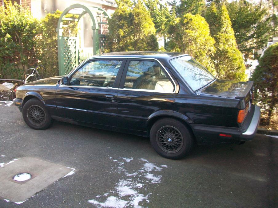

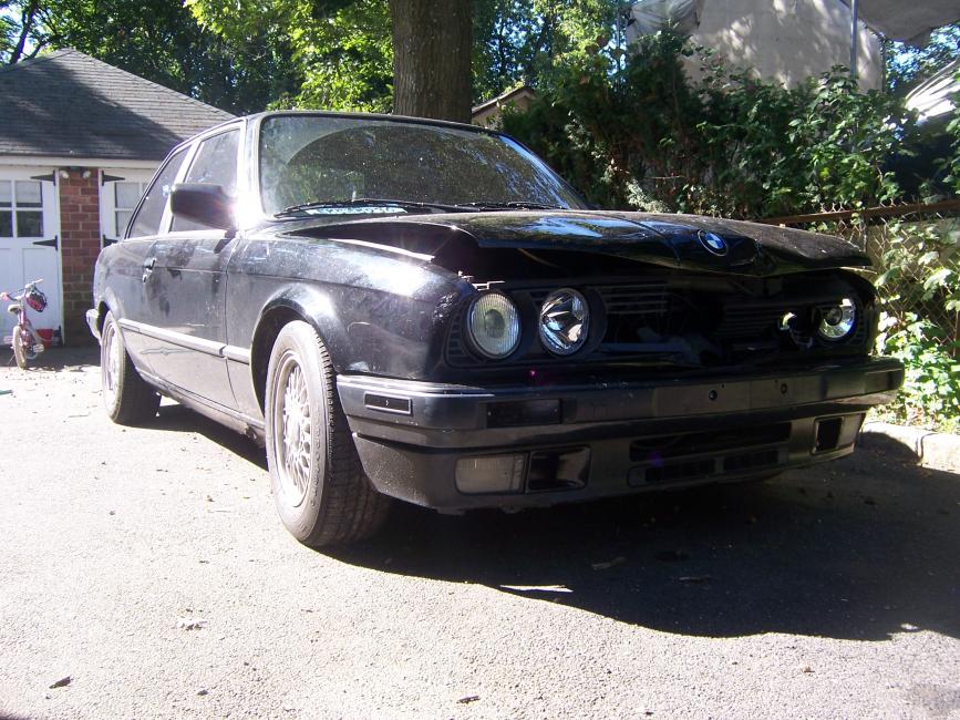

          After everything cleared with insurance, and i convinced my parents that keeping the car was a good idea, I begain looking for a parts car. I could have bought new bearings and the body parts i want, but i was pretty ignorant as far as cars go at this timeso i figured getting a parts car was a good idea.
          October 2009- Since i commute to college i needed to get a new car and fixing the 89' would have to wait till spring. I found this on craigslist. I originaly intended to use this as the parts car but it was way to nice to part. Anyway heres what I picked up in Brooklyn, 1990 325i for $1800. 105K

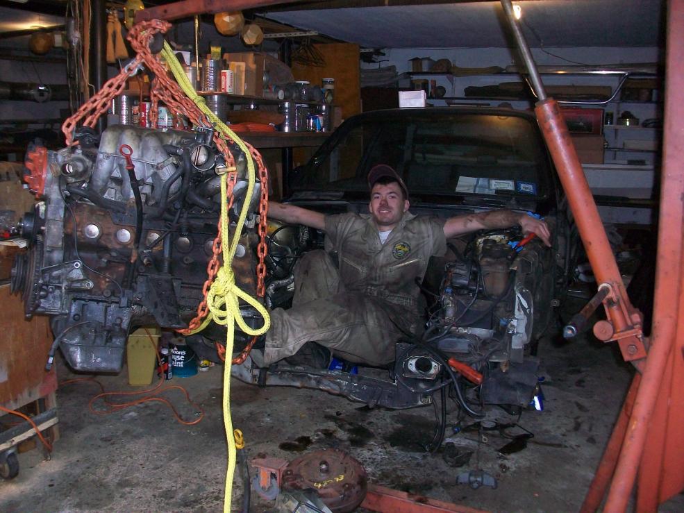

                My grandparents came in clutch and allowed me to use their garage for the part out. In two months, it would go from a car to a worthless shell. Well let the part out begin...

                    Part out cont.
                    Some more pics of the part out.
                    Eventually it became a worthless paperweight. Gave the shell away Tiago (toointoxicated60). Little did I know at the time, Tiago and I would become good friends a few months later.
                    Now that the shell was gone, i had a shit ton of parts that had to be brought back to my house on the south shore
                    It took two trips to bring all the parts back. heres the engine in all her dirty glory.
                    Time for the M20 teardown and swap.

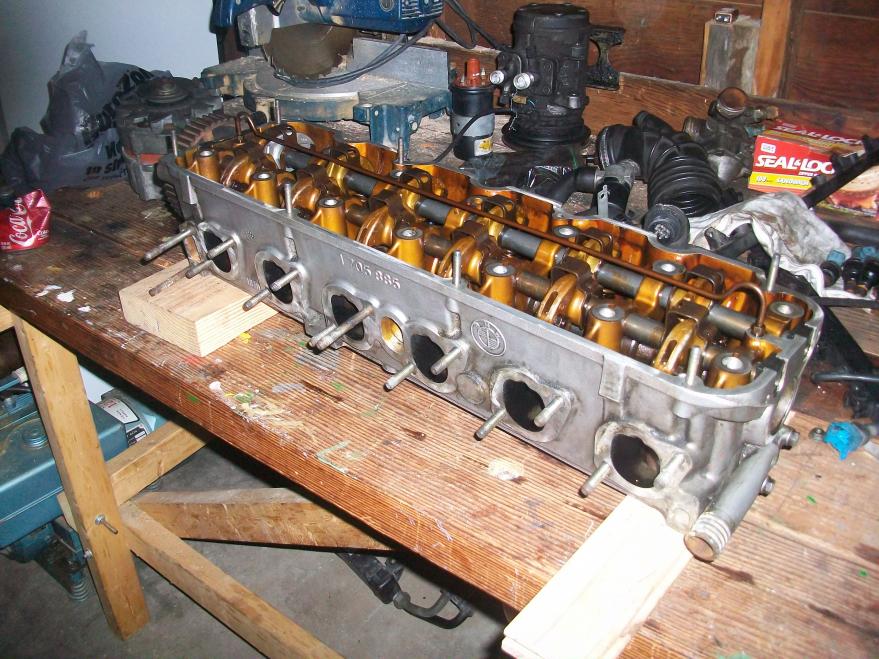

                      Now that the part out was complete, I could turn all my attention to the motor. New goodies..Block and head gasket set, water pump, timing belt.
                      Breaking it all down

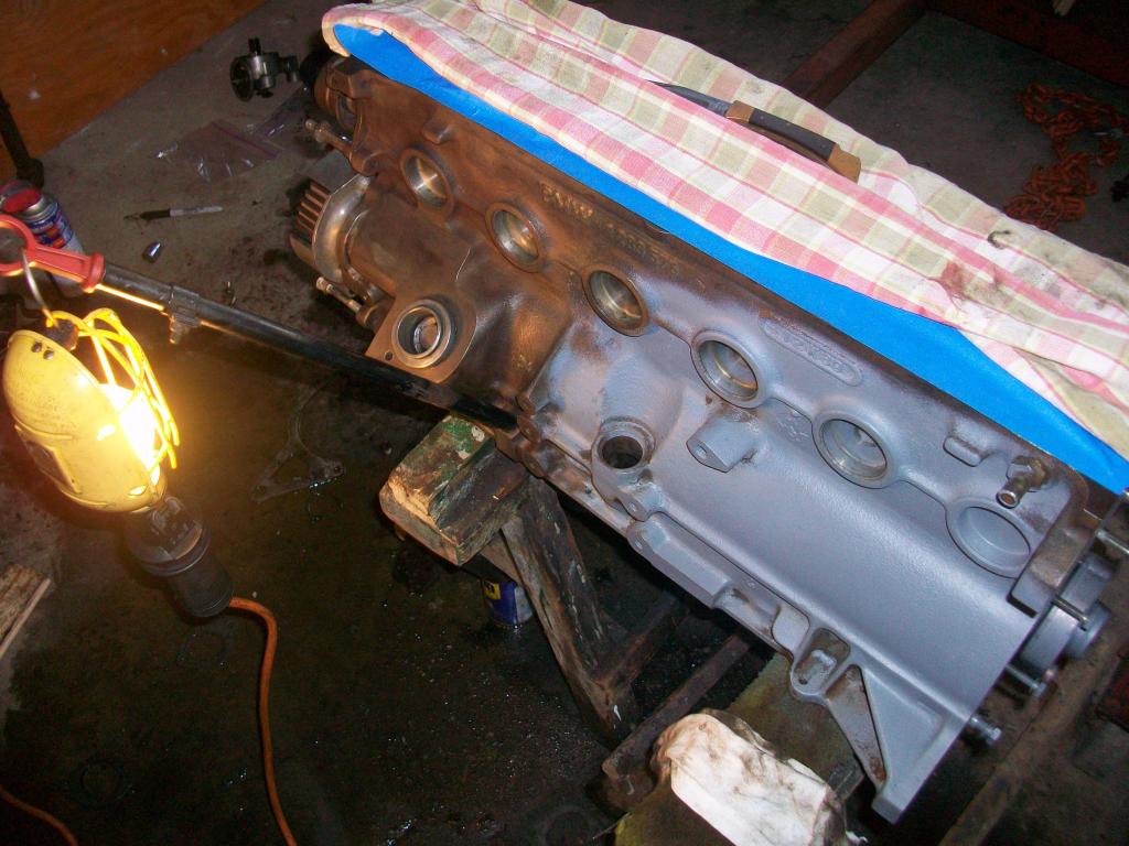

                      The hardest part was preping everything for paint. All the parts were covered by a layer of grease. Started out using engine brite but found out that pure gasoline worked alot better as a degreaser plus i had a shit ton of it.
                      The Build:
                      • ttrousdell
                        • Nov 2009
                        • 1770
                        m20

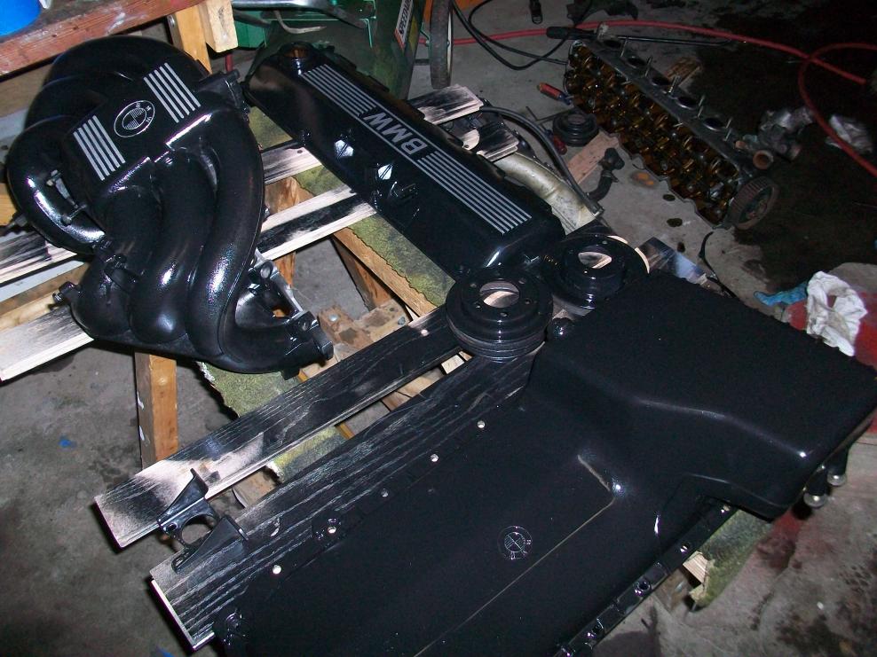

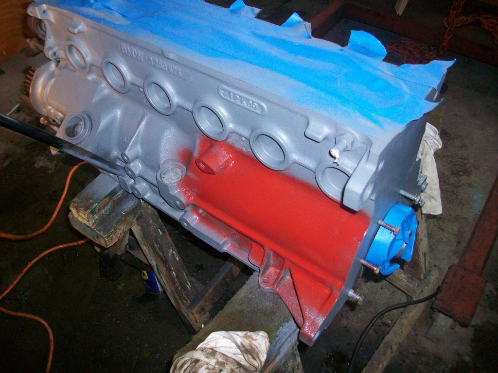

                        Now that it was all degreased, i could proceed with painting.
                        I used $6 dollar 500 degree paint from autozone which has stood up well so far. For the block i used a few coats of primer and then the fire engine red. I think its a nice color for the block.

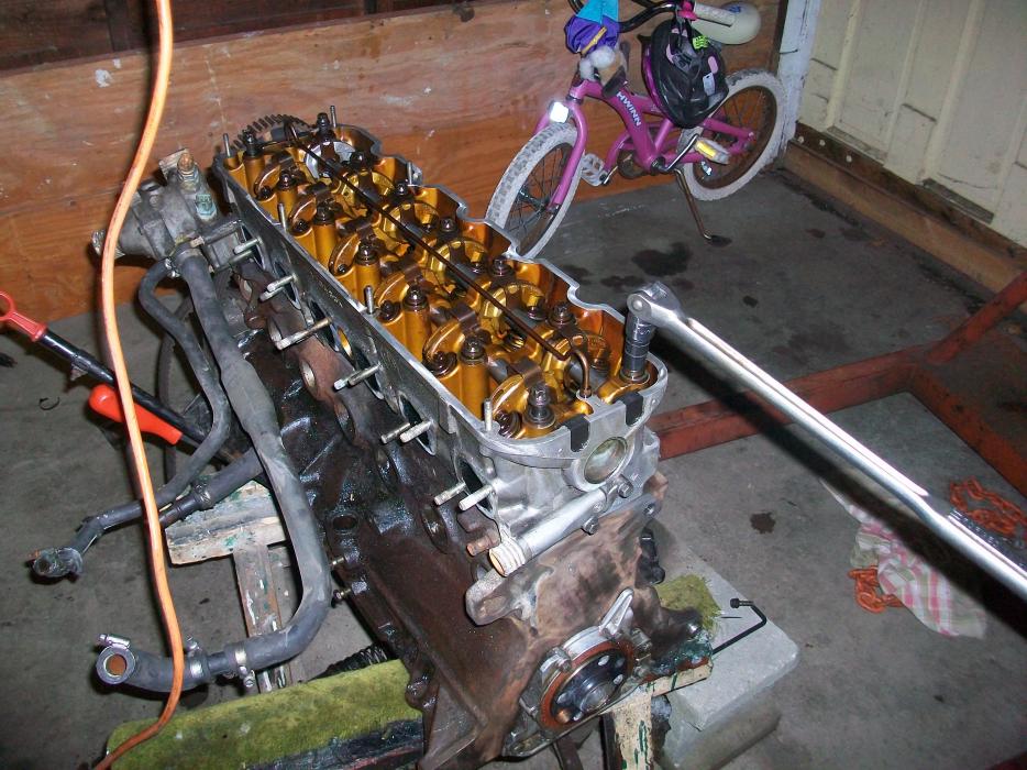

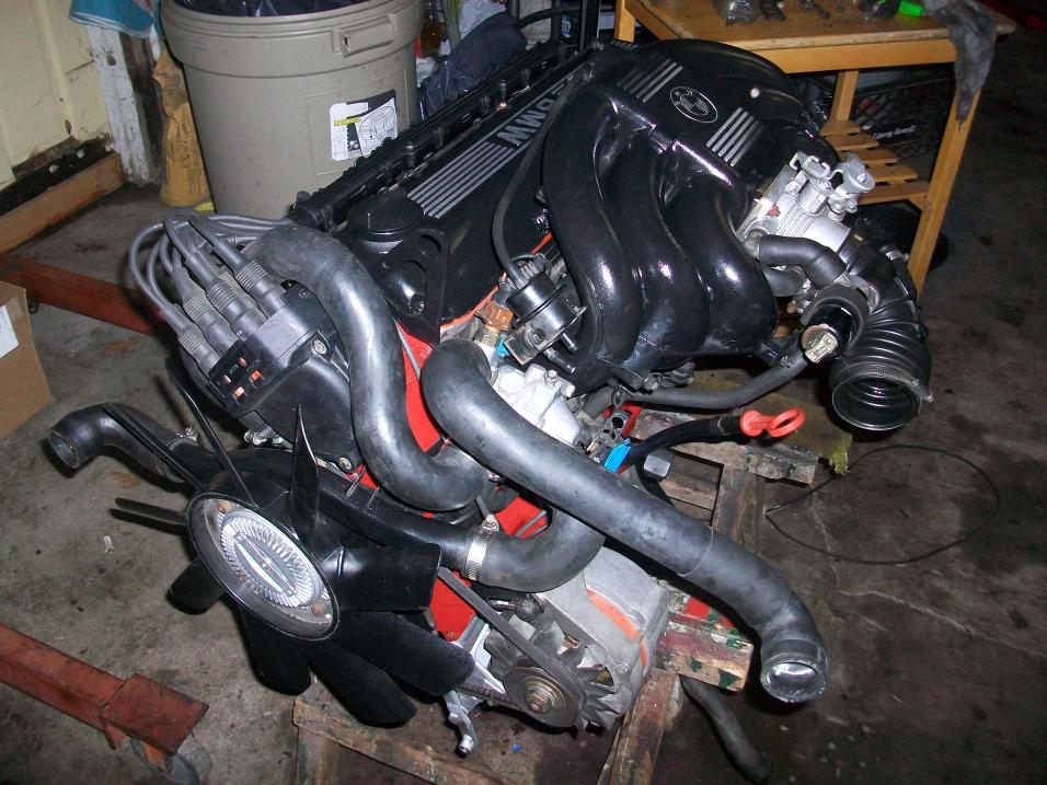

                          M20 Teardown Complete
                          By April, the engine was done. I chose to use the same clutch and pressure plate since it was in good shape. I had the flywheel resurfaced and a few pounds taken off. Cost me about $130 at the local machine shop.
                          Coming up the M20 to M20 swap then the M30 to M20 swap

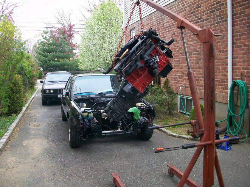

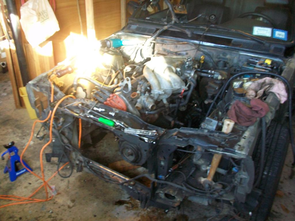

                            • ttrousdell
                              • Nov 2009
                              • 1770
                              M20 Swap

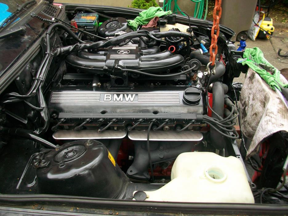

                              March 10' removed the fried M20B25

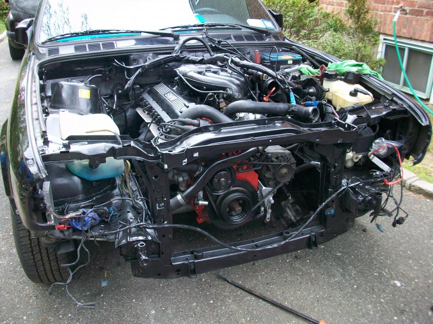

                              April-time to drop the new M20 in.
                              Finally in...
