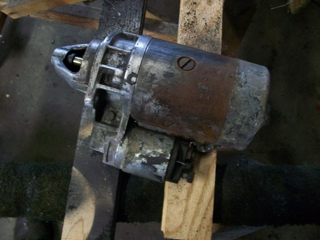

    starter
    Decided to throw a new coat on the starter since it was greasy and covered in a shitty silver paint job.
    Opened up the back cover. To do this remove the two large flathead and two small phillips screws which strip easily so use caution. The commutator and the brushes seemed to be in good shape.
    Gave it a nice gloss paint job

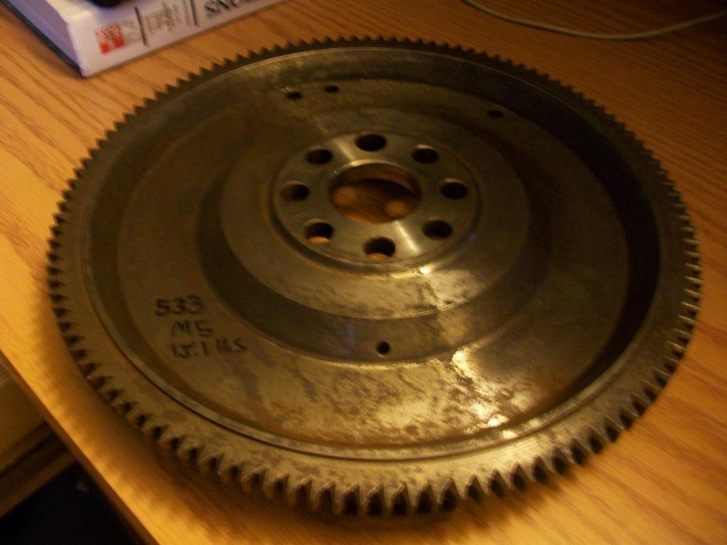

    flywheel
    Pulled the flywheel off and cleaned some of the surface rust with a wire brush. As I said earlier its a 533i flywheel which is the same as the e28 m5 flywheel. I dont plan on lightening it anymore but I will get it resurfaced. I'm also going to order the clutch kit. From what i got from researching the internet, a e28 M5 and e28 535i kits will work with my 260/6 tranny. Going with the 535i kit because it is cheaper. Going with e28 535i flywheel bolts too.
    *if anyone finds any errors in what i just said tell me, i am new to the e28, e32 world. Also if you have any advice please feel free to tell.
