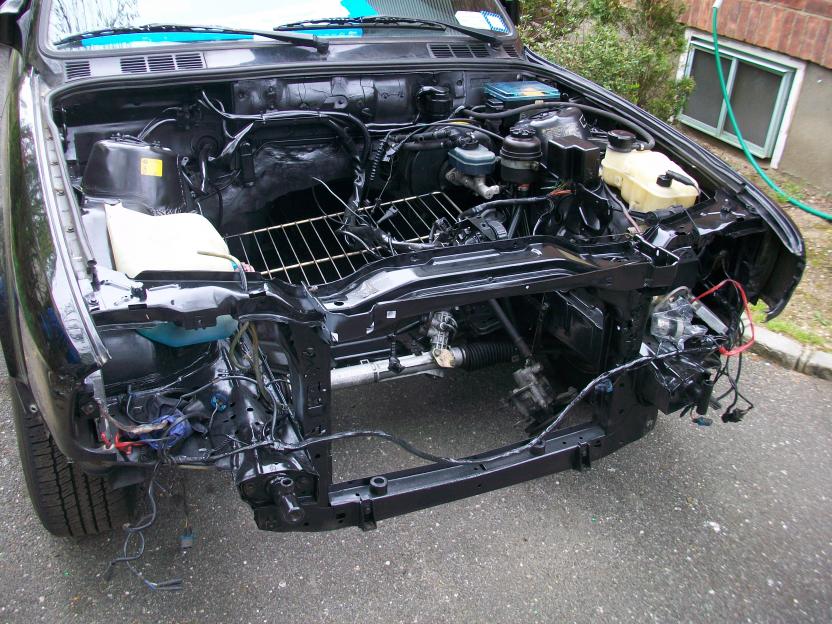

  • ttrousdell
    replied

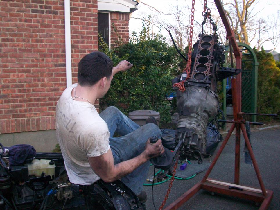

    M20 Swap
    March 10' removed the fried M20B25
    April-time to drop the new M20 in.
    Finally in...

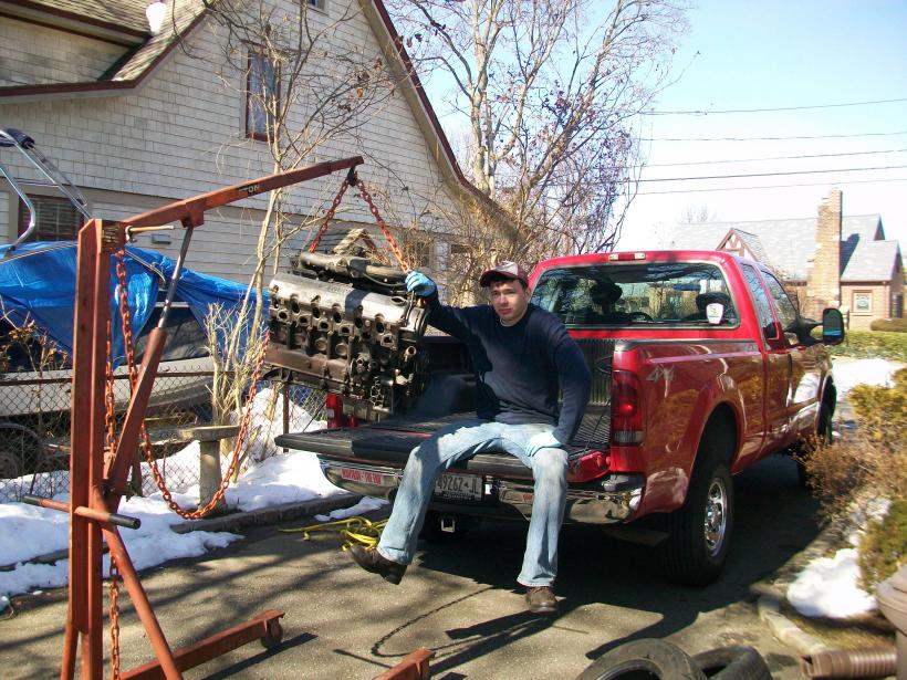

  • ttrousdell
    replied
    M20 Teardown Complete
    By April, the engine was done. I chose to use the same clutch and pressure plate since it was in good shape. I had the flywheel resurfaced and a few pounds taken off. Cost me about $130 at the local machine shop.
    Coming up the M20 to M20 swap then the M30 to M20 swap

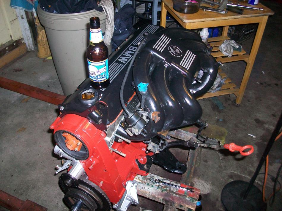

    m20

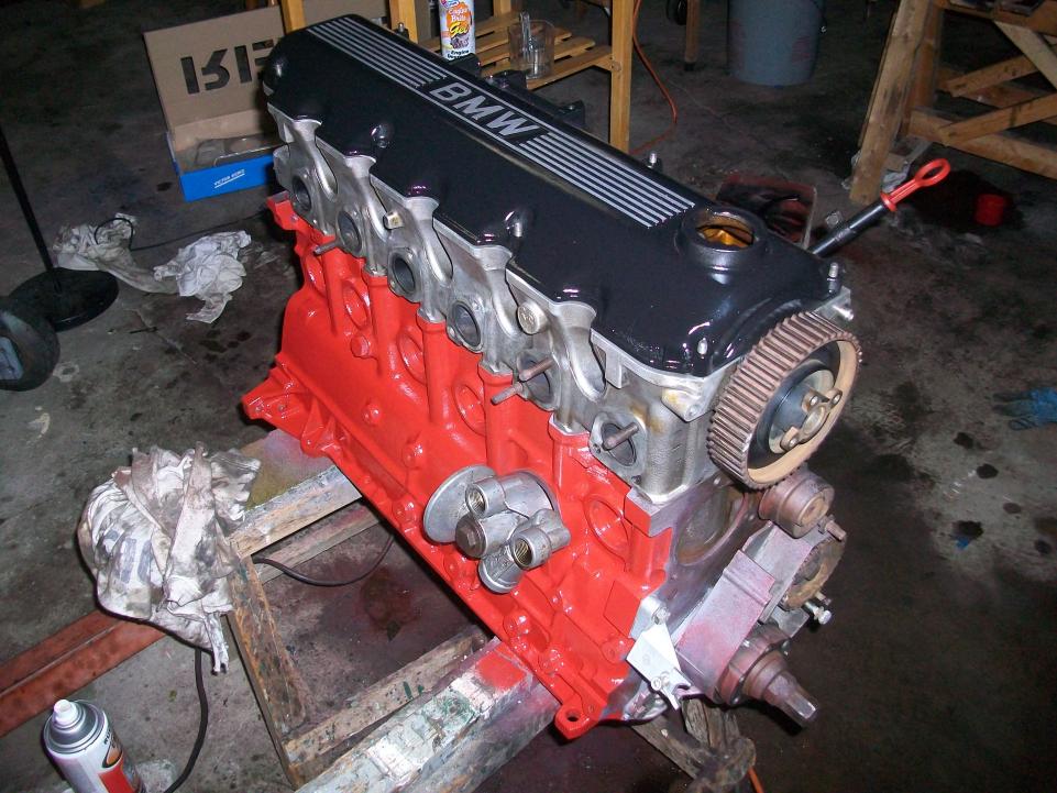

    Now that it was all degreased, i could proceed with painting.
    I used $6 dollar 500 degree paint from autozone which has stood up well so far. For the block i used a few coats of primer and then the fire engine red. I think its a nice color for the block.
    Moving along. Think it was early march of 2010 when this was taken. Click image for larger version
    Blue Moon is the best beer i have ever had.

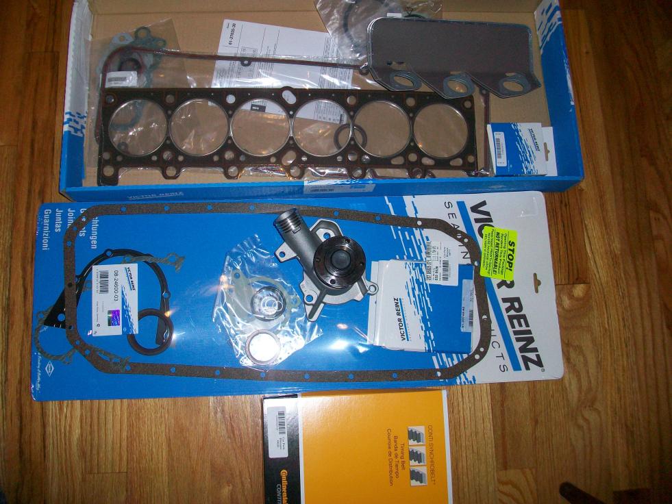

  • ttrousdell
    replied
    m20
    Now that the part out was complete, I could turn all my attention to the motor. New goodies..Block and head gasket set, water pump, timing belt.
    Breaking it all down
    The hardest part was preping everything for paint. All the parts were covered by a layer of grease. Started out using engine brite but found out that pure gasoline worked alot better as a degreaser plus i had a shit ton of it.
    Leave a comment:

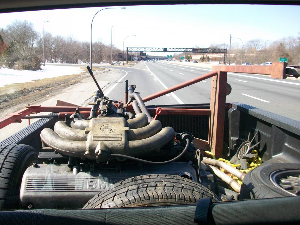

  • ttrousdell
    replied

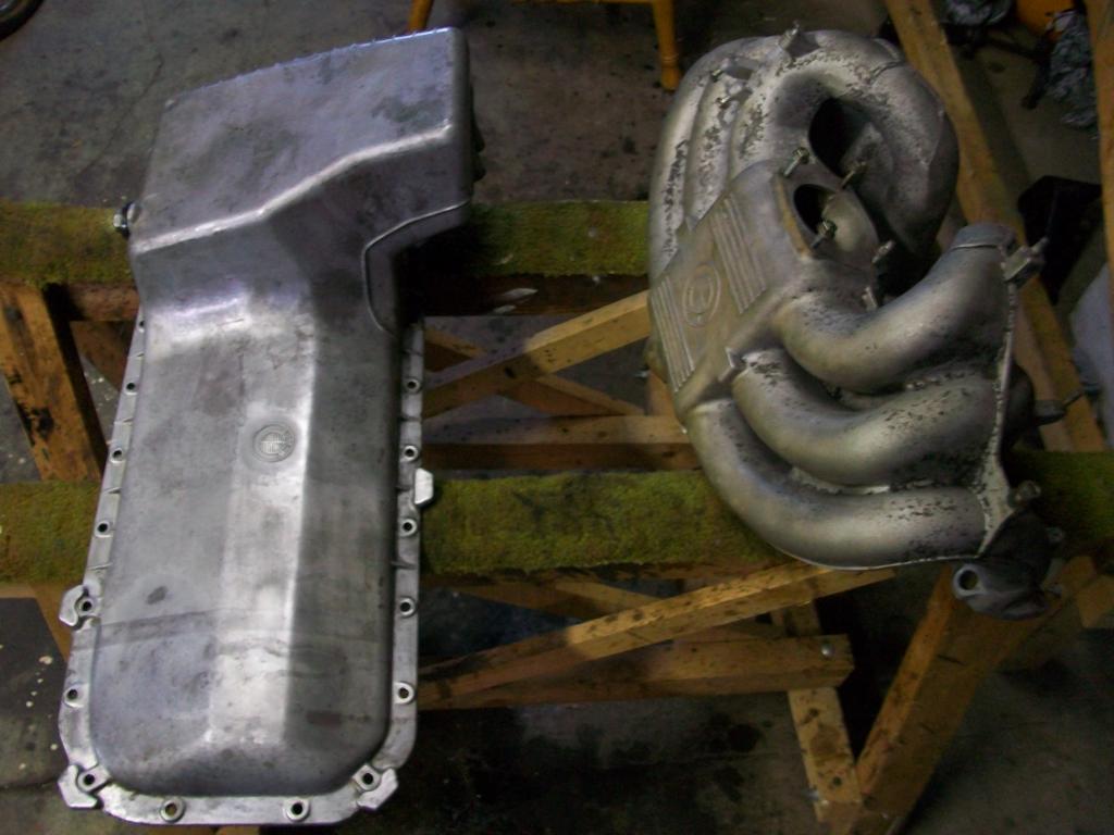

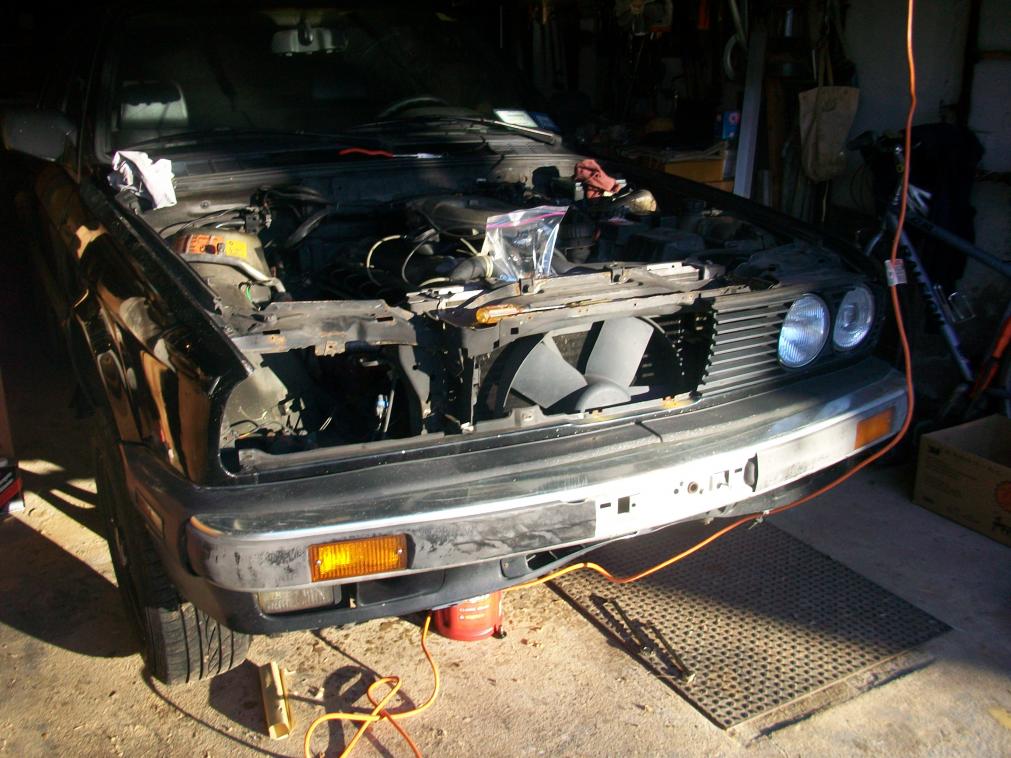

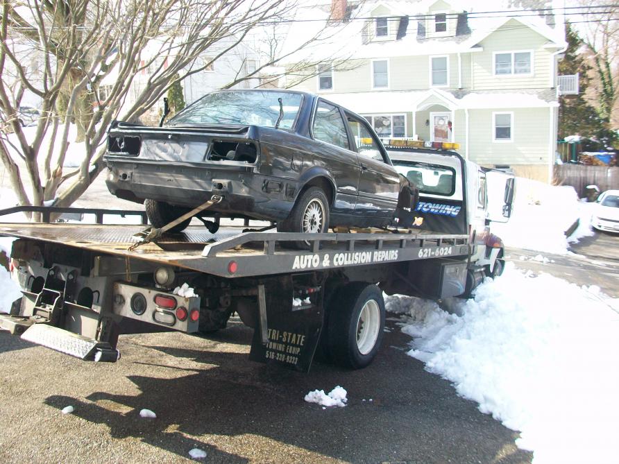

    Part out cont.
    Some more pics of the part out.
    Eventually it became a worthless paperweight. Gave the shell away Tiago (toointoxicated60). Little did I know at the time, Tiago and I would become good friends a few months later.
    Now that the shell was gone, i had a shit ton of parts that had to be brought back to my house on the south shore
    It took two trips to bring all the parts back. heres the engine in all her dirty glory.
    Time for the M20 teardown and swap.

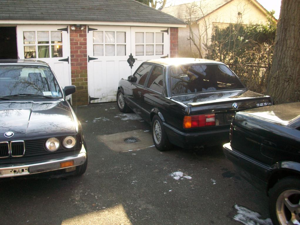

    The parts car in all her glory
    January 2010- Parts car: 1988 325is. Picked up this peice for 1400+ the head from the 89' 120k auto.
    All 3 of my cars..this is getting kind of rediculous.
    My grandparents came in clutch and allowed me to use their garage for the part out. In two months, it would go from a car to a worthless shell. Well let the part out begin...
