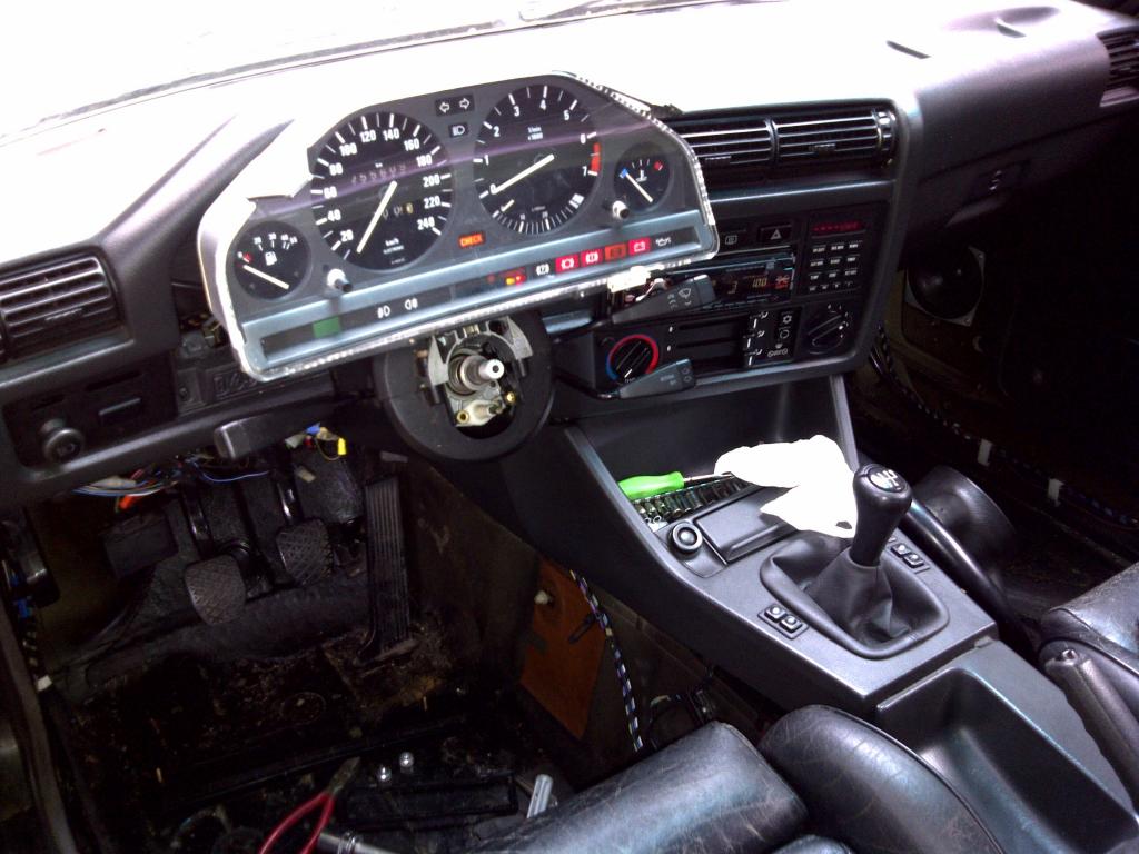

    For the last 45 days I had been working aboard a ship traveling around northern Europe. During my time in Latvia, I was able to meet up with a few BMW enthusiasts and buy some euro parts. Purchased all these items for a steal.
    Ive only been home for a few hours but i had to install the new gauges. So far so good.
