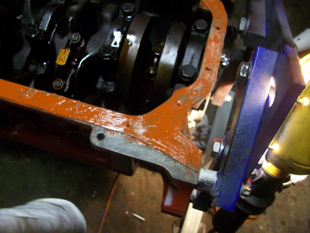

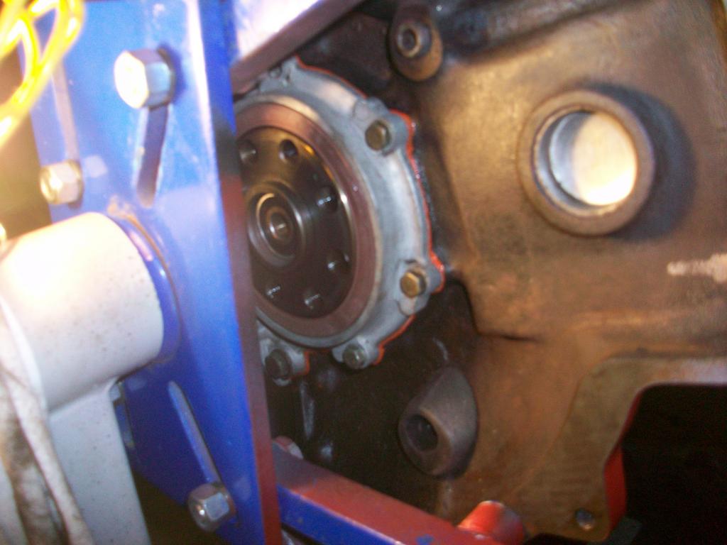

      Now that i had my gaskets, it was time to put it all back together. New rear crank seal. Threw a little oil around the inside and it slid on without too much trouble.

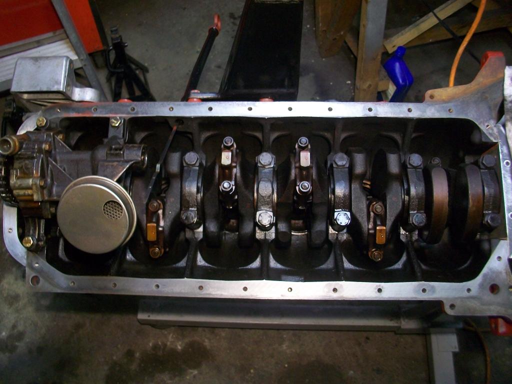

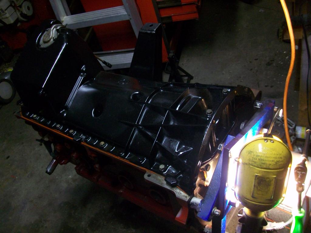

      Next up was the oil pan. Cleaned the sealing surface with a razor first to remove the heavy stuff, then scotch brite for a nice finish. Also took the time to clean the screen filter on the oil pump which was full of old gasket peices and crap.

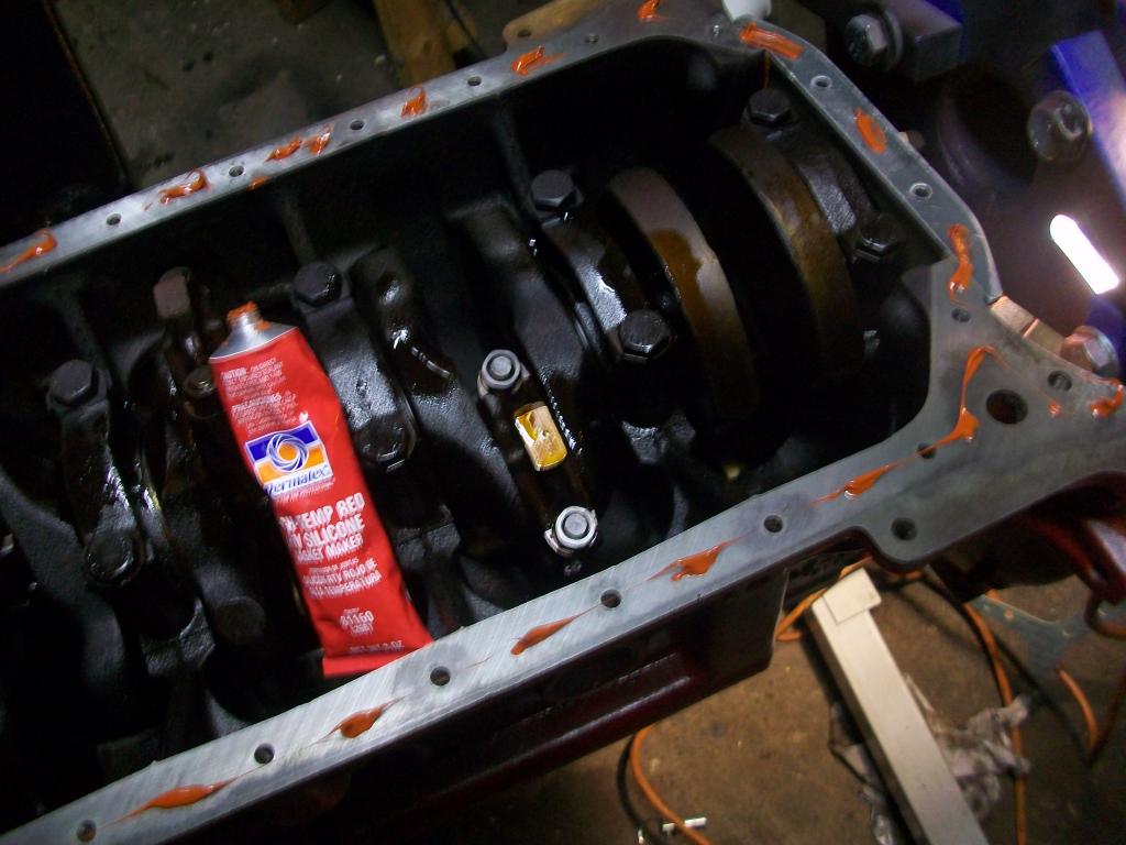

      This is how i do all the seals except the intake and exhaust gaskets. I put a small coating of rvt on both sides of the gasket. You may do it differently but this method has been working great for me.
      Gasket on with the light coating on top. You should kinda be able to see the color of the gasket below the layer of rvt. Putting too much will make it look like shit when it spews out the sides later when you tighten everything down.
      Done...

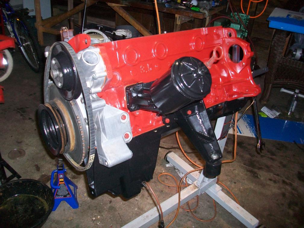

            Bottom End Back together
            Continued progress. The bottom end is mostly back together.

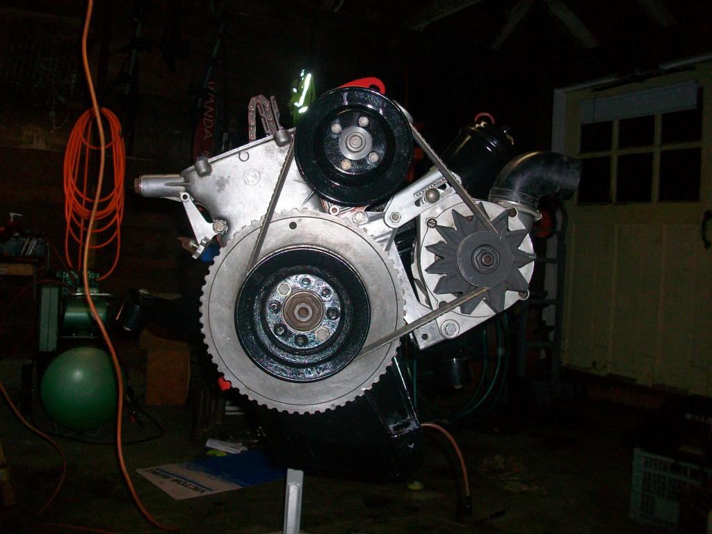

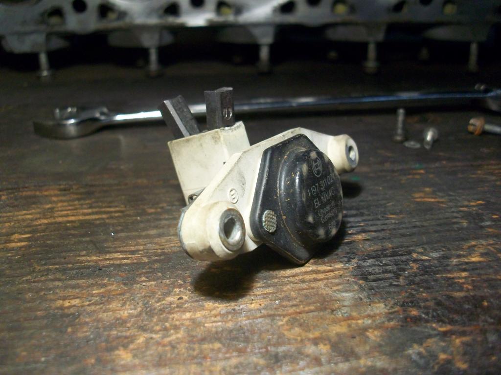

            Cleaned up the alternator. Instected the brushes and they looked ok. The black peice on the back of the part is the voltage regulator. Usually the main reason of alternator failure is because this part is worn.
            Alt. Back where it belongs

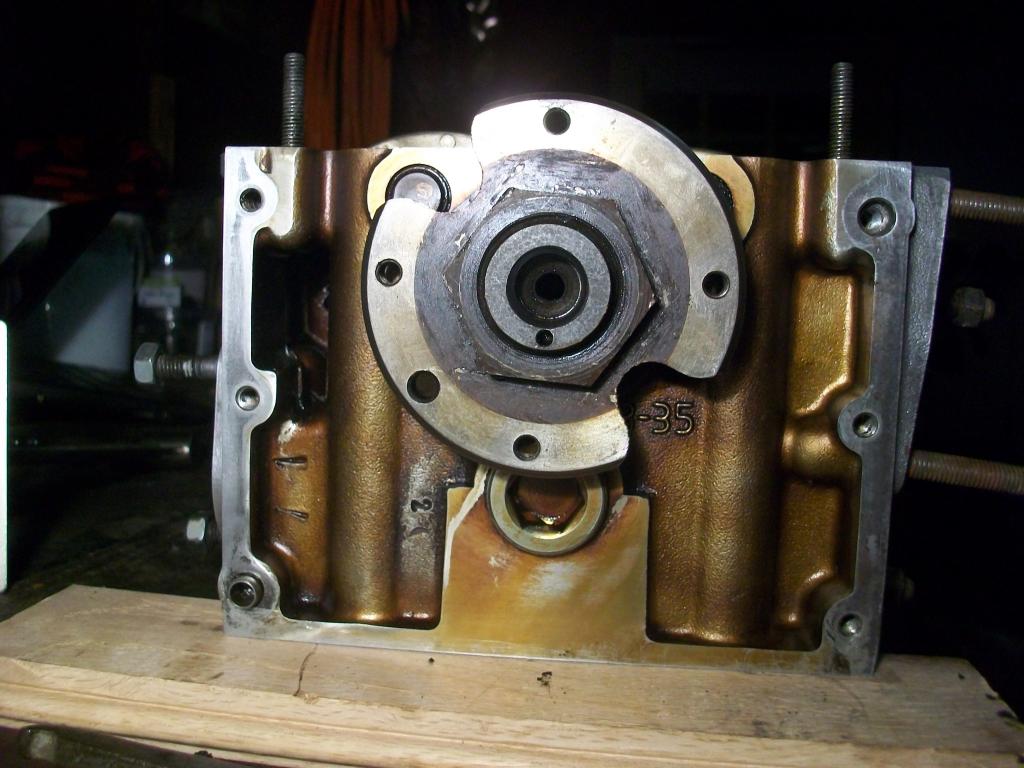

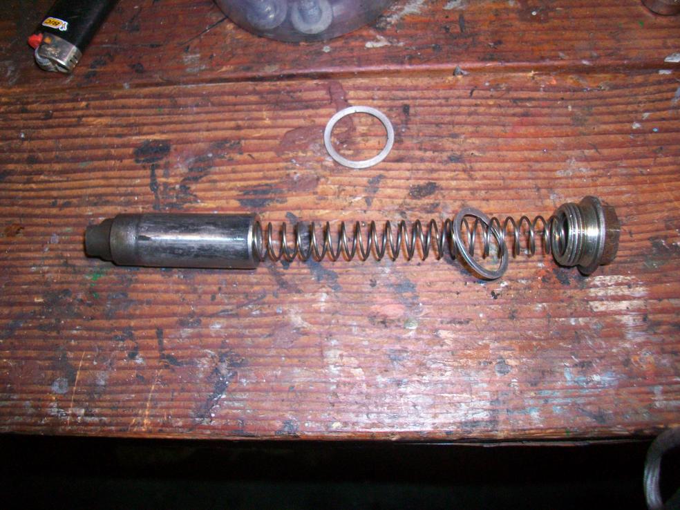

            Chain tensioner assembly. New spring and crush washer.

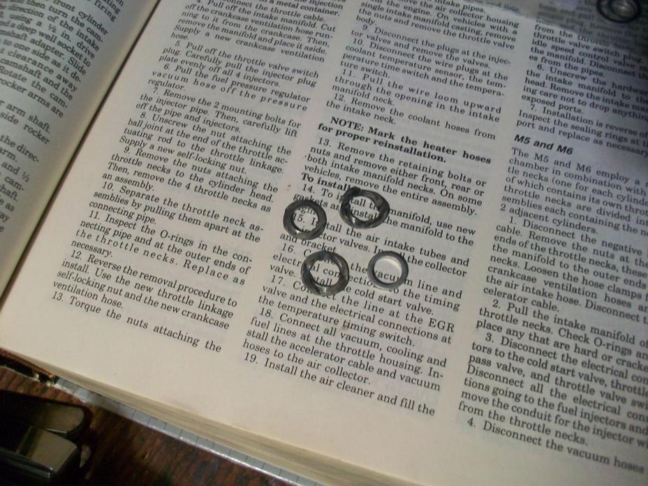

                                Continued to clean the head. Removed the oil spray bar to make cleaning easier and replace the crush washers.
                                [ATTACH]36742[/ATTACH]
                                Think these banjo bolts were overtightened....Ive never seen crush washers this mangled. These only have to be tightened to 8-10ft.lbs. Threw a little thread locker on mine and torqued them down.

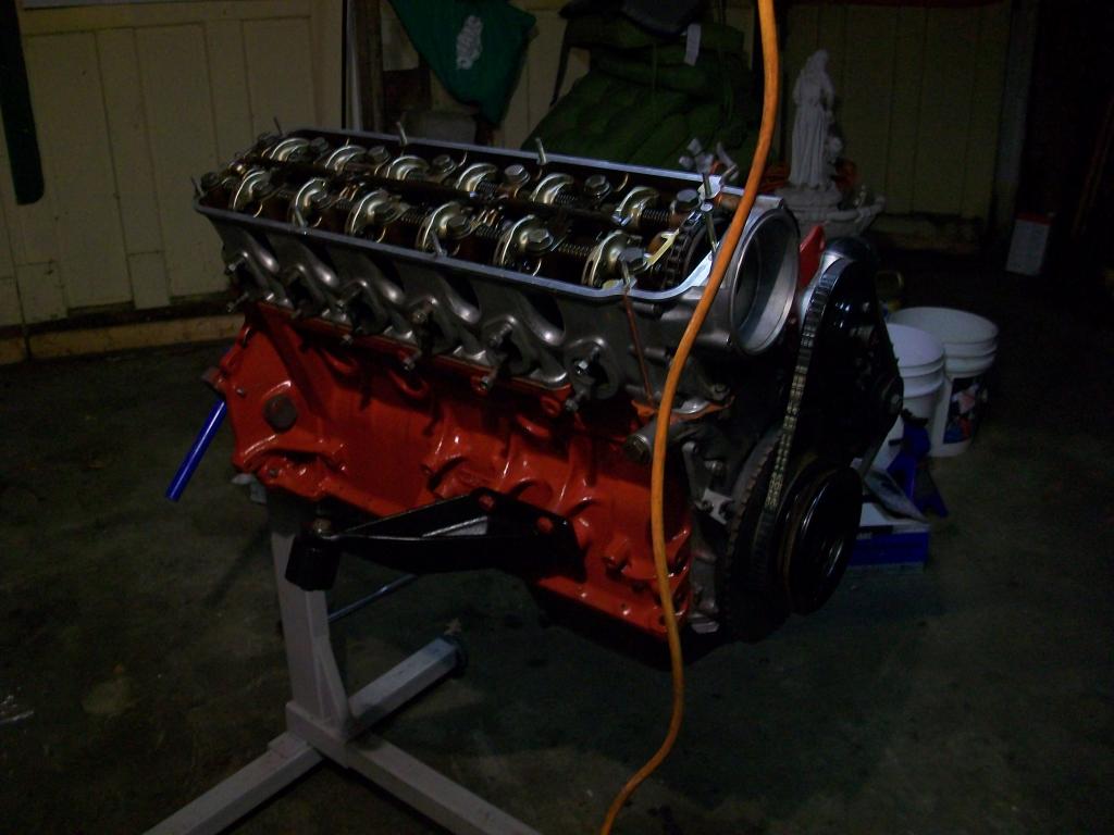

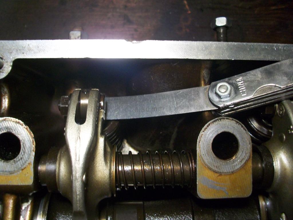

                                Adjusted al the valves. The gap for m30 engines is .012" and .01" for m20.
                                TDC
                                Threw the head on. Think its coming together quite nicely. Turned it over a few times and the timing marks lined up perfectly.
