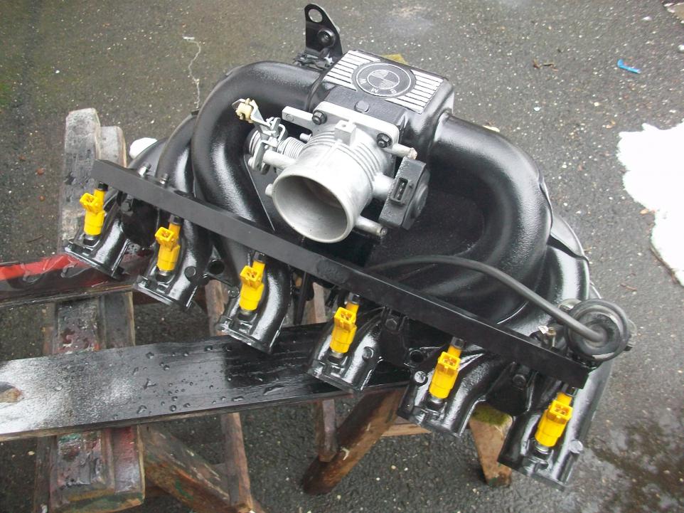

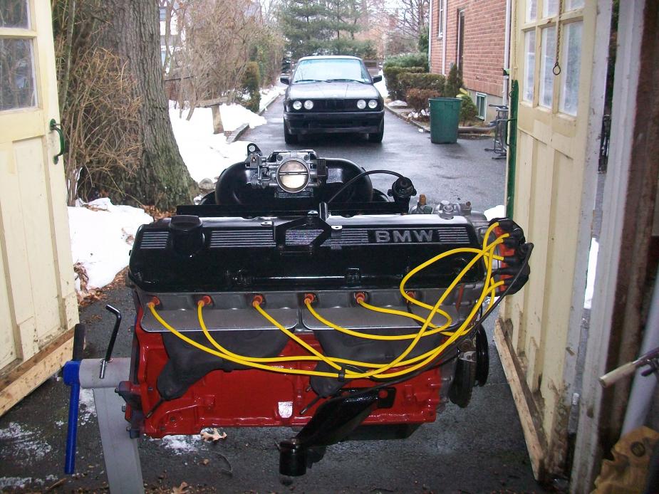

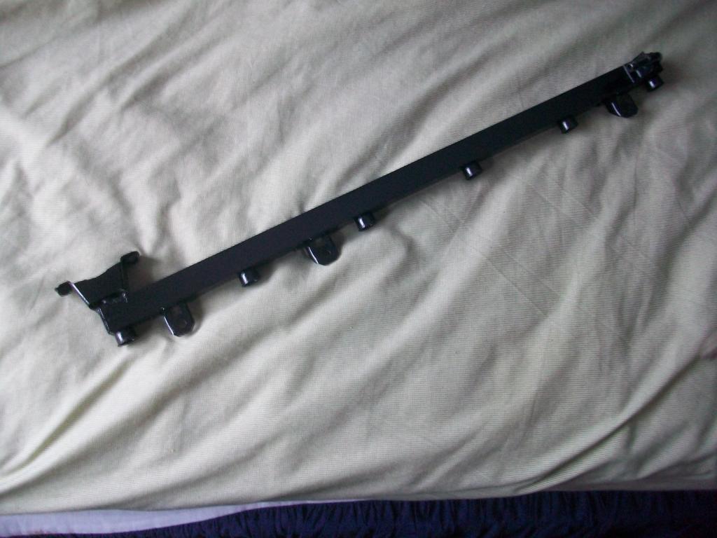

      Motor Done!!
      Spent the last few days finishing up the motor. Fuel rail wire brushed to remove the surface rust and a new coat of paint.

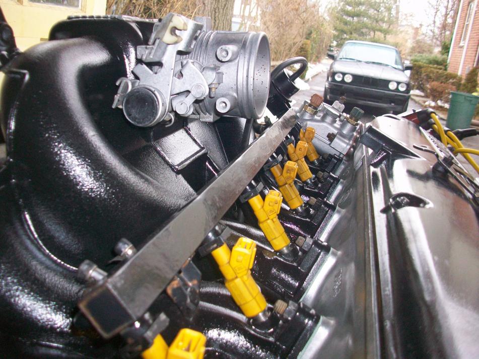

      Whole intake back together. Relaced the fuel injector o-rings which came with the head rebuild kit. I purchaced the motor with yellow Ford 19lb injectors. After doing some research, i found out the the Ford injectors deliver 2.5% more fuel flow then the stock m30 injectors.

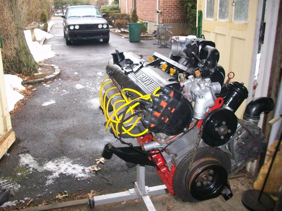

      Few shots of the motor and the car. I go back to school in a few days so this will be the last progress for a while. I hope you have enjoyed it so far.

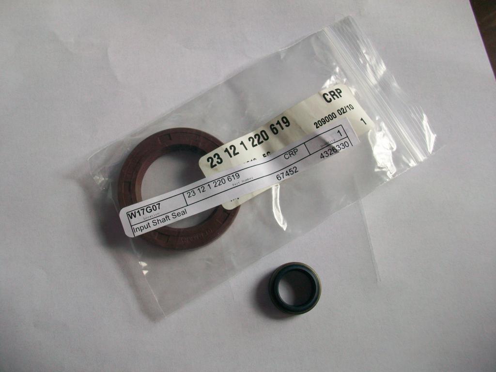

        tranny

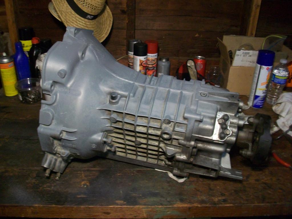

        Hello again for those who have been viewing my build. Not too much work has been going on due to the cold. Ive just been cleaning up the tranny.
        New seals from partsgeek. Im goin to change out the shifter rod seal, and the input and output seals.

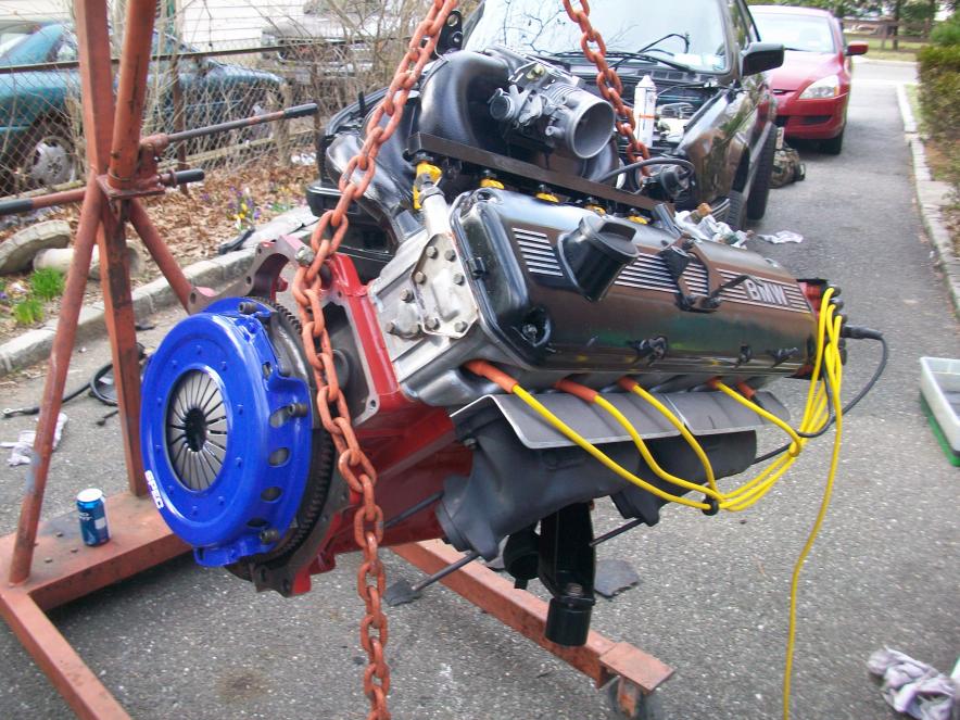

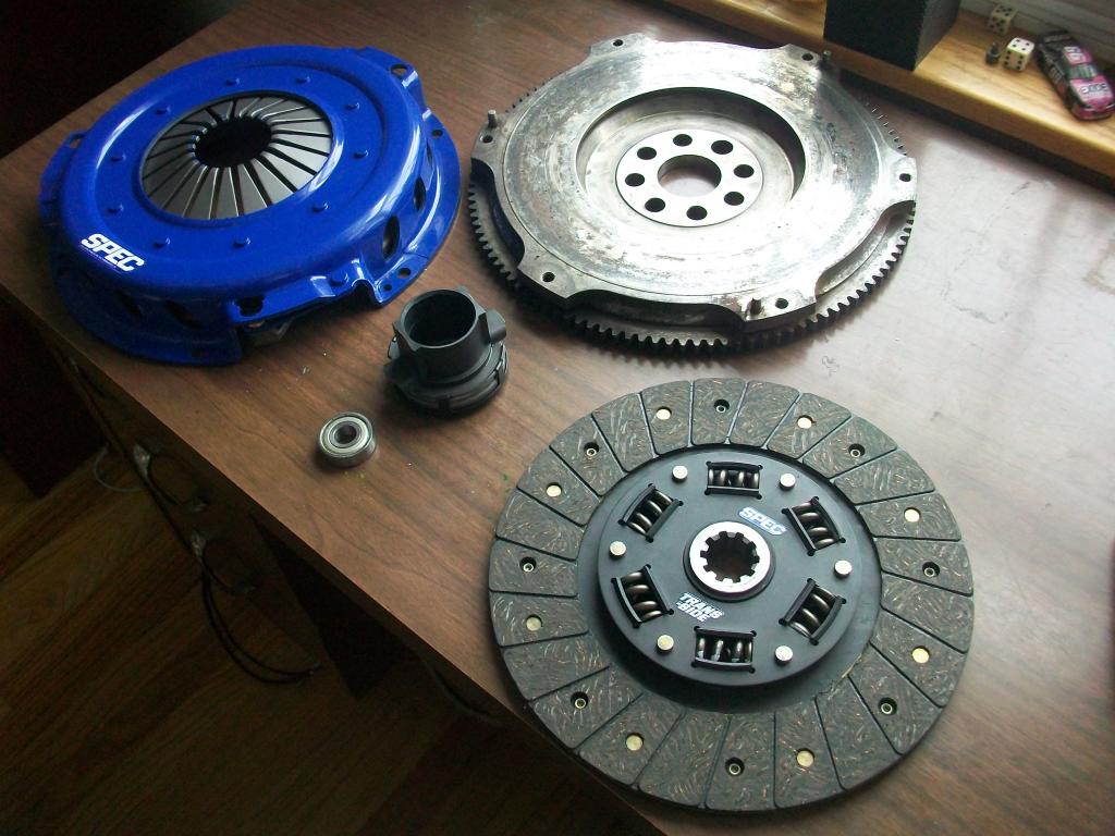

        Stage 1 e28 535i clutch from spec clutches. It took over two weeks to get here so good thing I wasnt in a hurry. M5 Flywheel not included obviously.

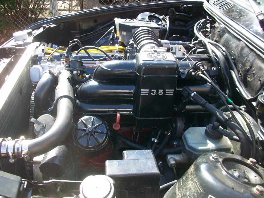

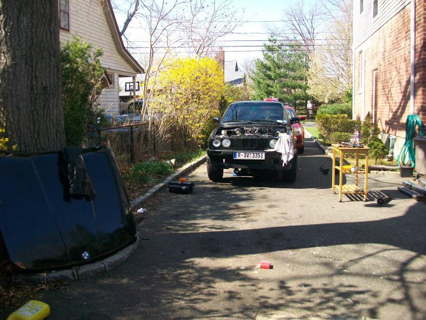

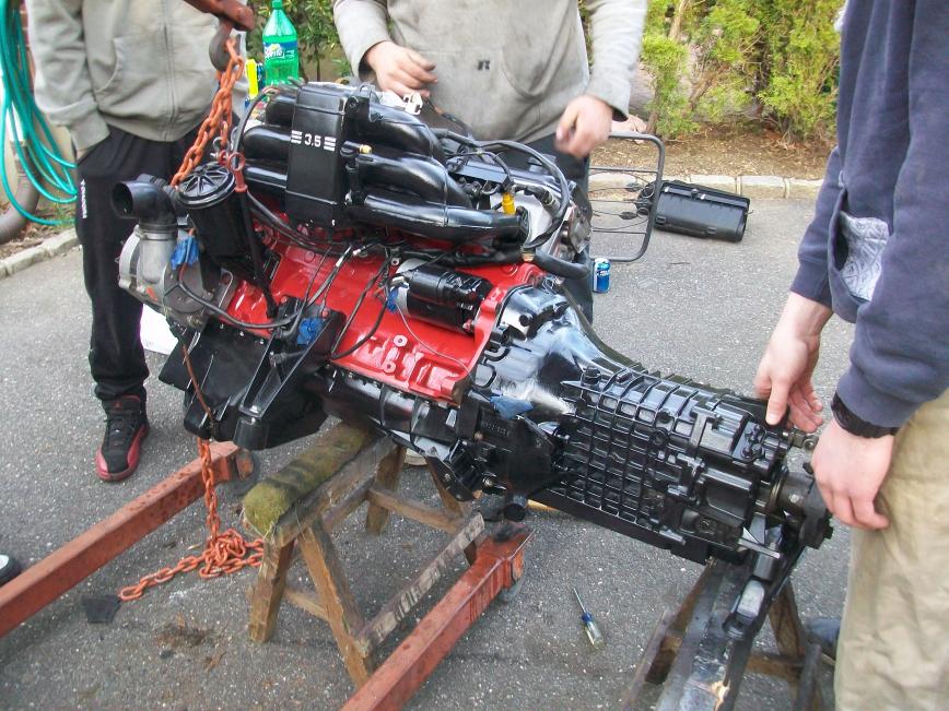

            M20 Finally Out

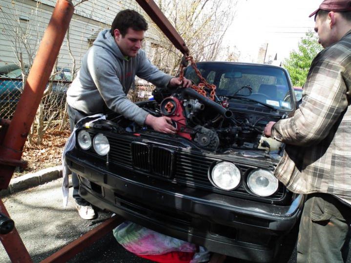

            I drove my M20 for the last time yesterday. My friends and I started to break it down and with in two hours we had the engine out. Enjoy the pics.

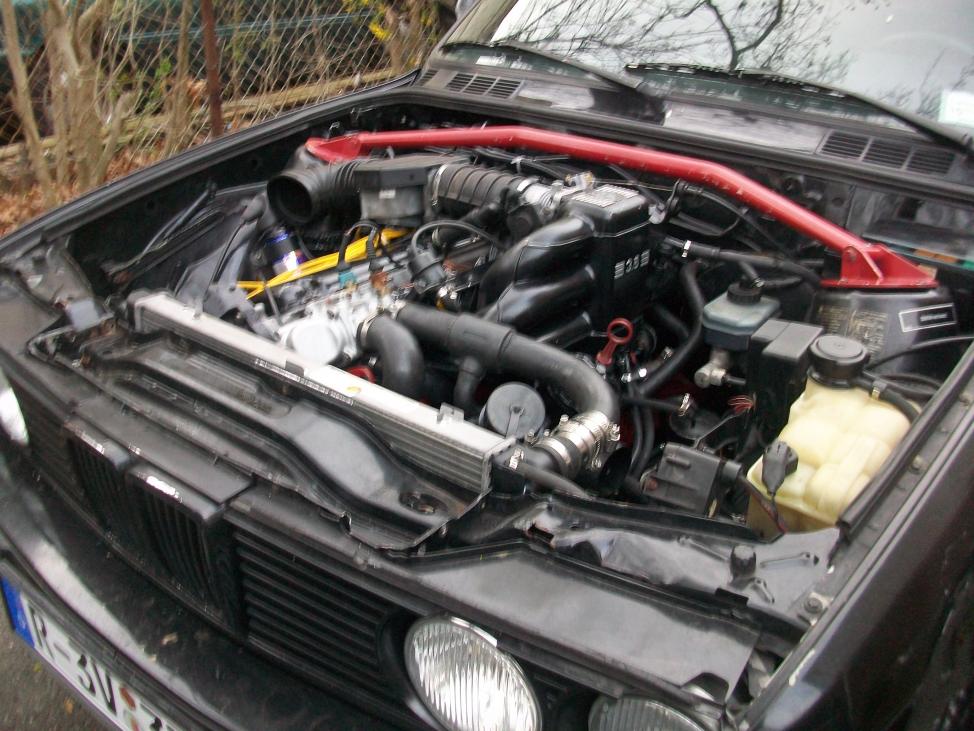

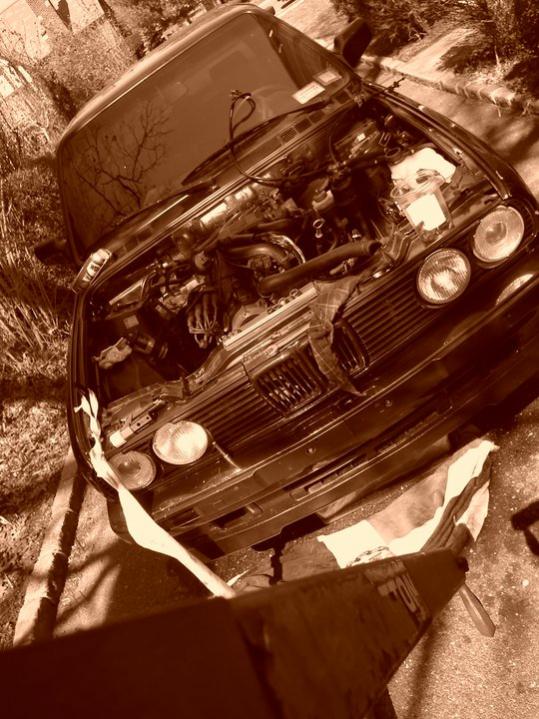

              335is

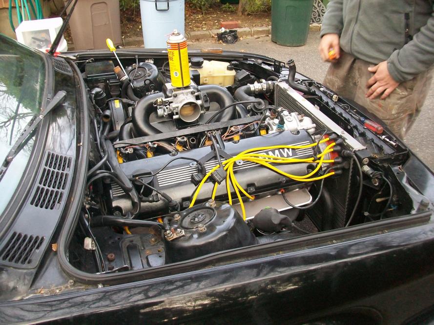

              Made some good progress with the swap. I had the M30 in the car by yesterday afternoon. Today progress was slightly slower. My original plan was to use the wire harness that had come with the swap, but it turned out that the harness had the early model round c101. The next option was to use my m20 harness. By afternoon, all the essentials for start up were done. Finally turned the key and crossed my fingers and it started right up. It runs like crap since there is no exhaust, intake sensors connected but the hardest part is over.
              Almost in
              Things to do Still
              *Lengthen/modify some of the wire sensors for intake
              *Exhaust
              *Put in coolant system, make a support for radiator
              *put in driveshaft

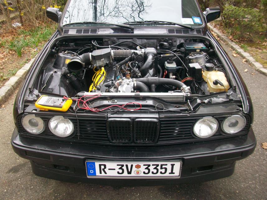

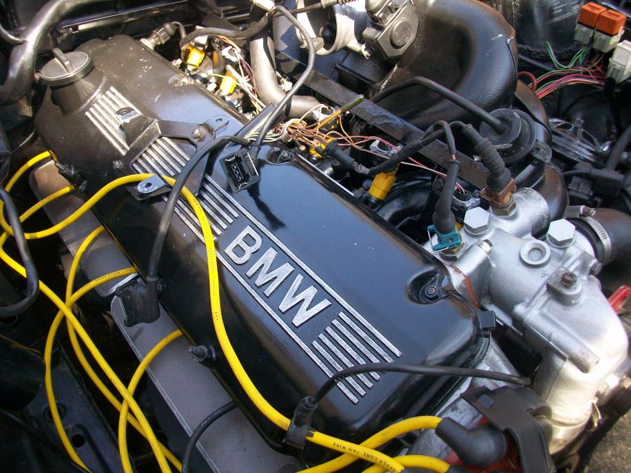

                Wiring
                Continued to wire up the engine with my late model m20 harness. Surprisingly all the injector connections fit altough they had to be taken out of the plastic holder. The insulated wrapping on the harness had to be cut in places so I could get more lenght from some of the connectors. This was especially the case for the intake connectors (maf, throttle, icv) since they had to be stretched to reach the other side of the engine.

                        #56
                        She Runs
                        It took about four weeks but I was finally able to take the car out again for a spin. I hit some trouble with the wire harness, and wrong size CSB but I think most of the kinks have been hammered out. It still has no exhaust so no real driving fun till this weekend.
                        Things To Do
                        • Better solution to break booster breather
                        • Exhaust. Running 2 magnaflow mufflers
                        • Fit air box
                        • Machine PS delete piece
                        • Electric Fan (prob a good investment for summer when in traffic)

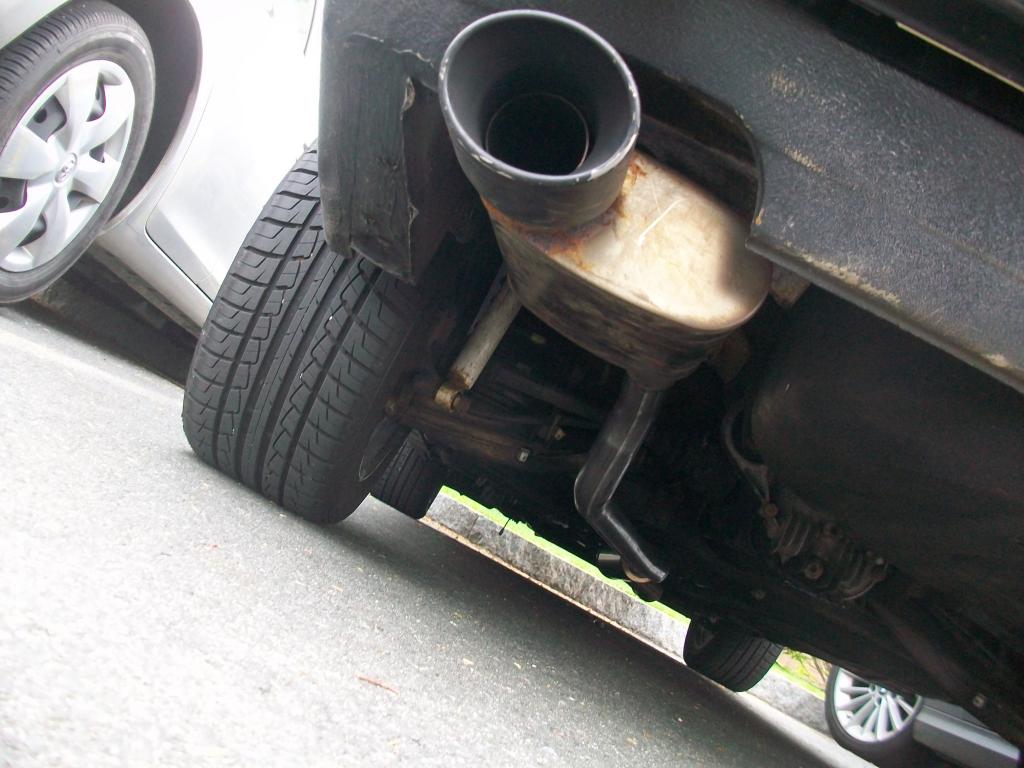

                                Exhaust
                                The exhaust was finished yesterday. I decided to go with two 2.5" magnaflow mufflers that give it a sound that I'm pretty pleased with.
                                50 bucks for the muffler on craigslist....score!

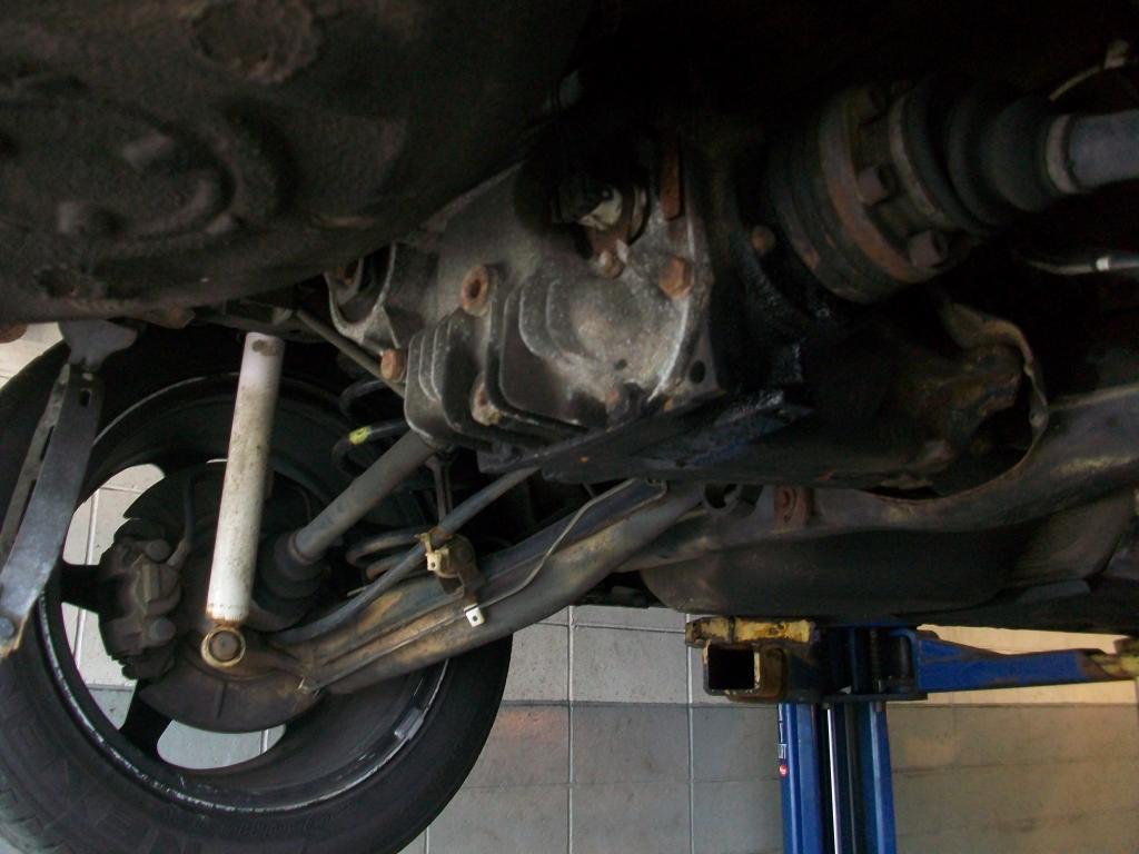

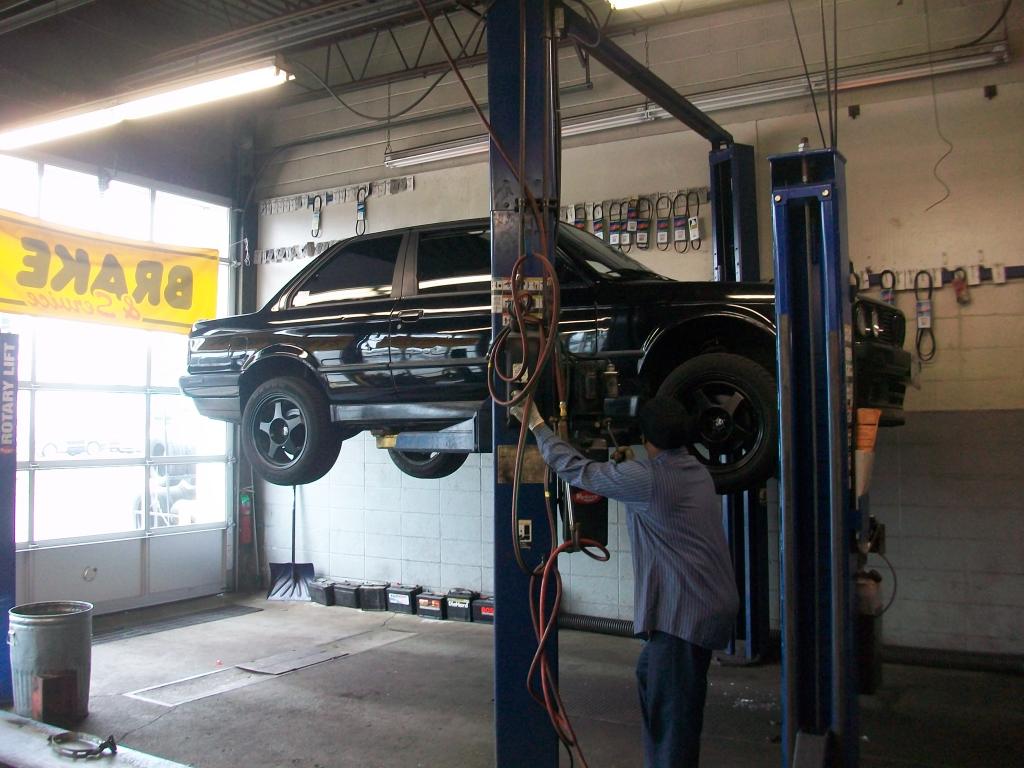

                                Putting the car on the lift told me a lot about the state of my suspension. Turns out one of my front shocks blew and left its oily goodness all over the strut and rim. I was also reminded of how shitty my bushings look, brake lines are pretty rusted and that the seal on my diff is leaking too. To top it all off my heater core started to leak by the accelerator pedal after leaving the shop so I definitely have some work ahead of me.
