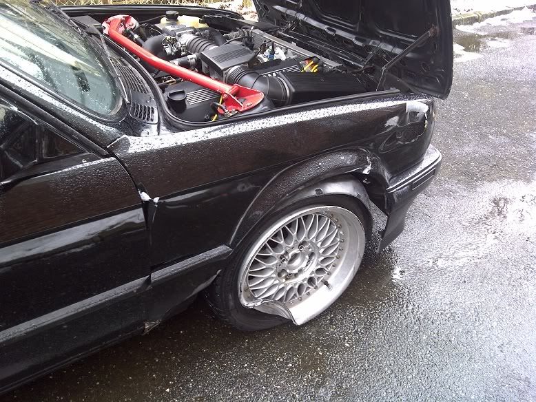

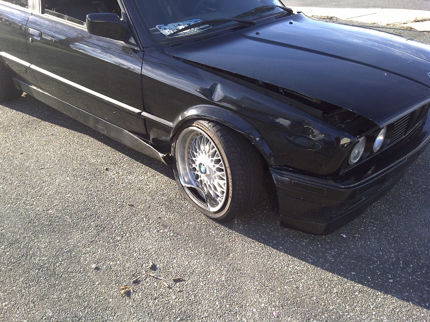

    Some of you may remember that my car was hit about a month ago.
    Insurance settled at $2200 which was a little less then though but ill take it. I ordered the suspension parts weeks ago but dealing with graduation and finding a job has taken up a good portion of my time till now. I also bought an e36 around the time of the accident which I was able to flip and sell for a 800 dollar profit.

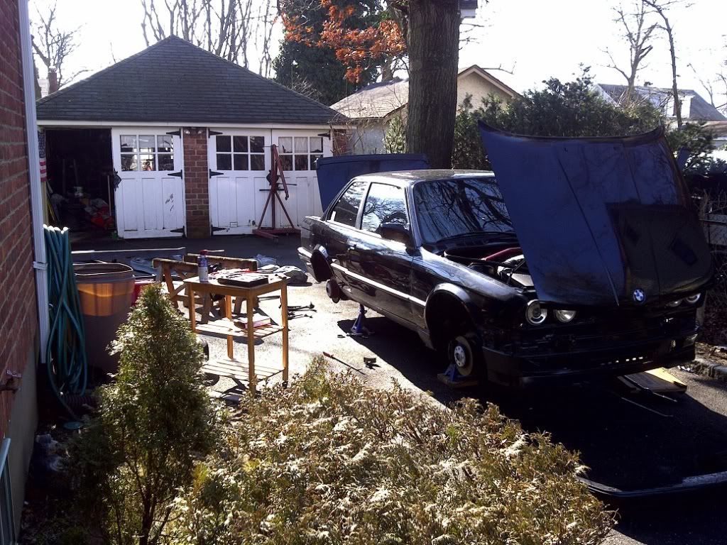

    Back to the matter at hand. We finally got some warm weather so it was time to get to work on the e30.

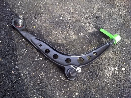

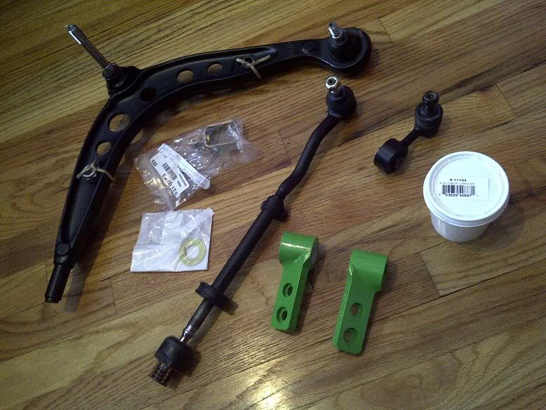

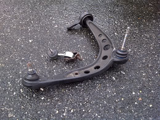

    Old control arm and link out. Notice the distortion.
    New Parts (control arm, tie rod with lock plate, end link, treehouse CABs, polybushing lube)
    All ready to go on the car

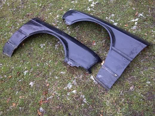

    Picked up a fairy decent set of fenders which will be going on the car.
    Fenders about ready to go on.

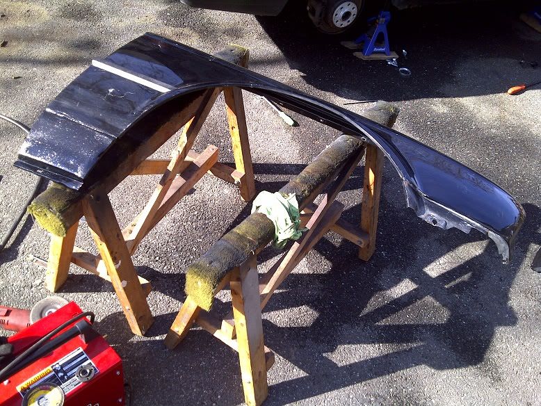

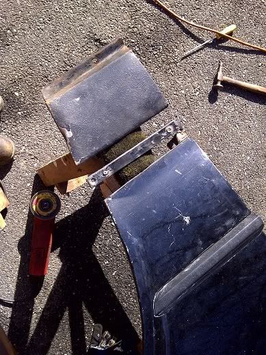

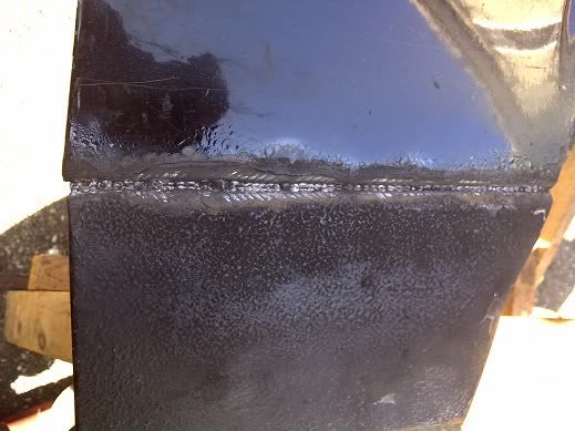

    Fender on but wait whats this. They are too long. Vert fenders F*!k.

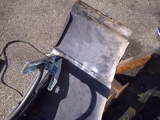

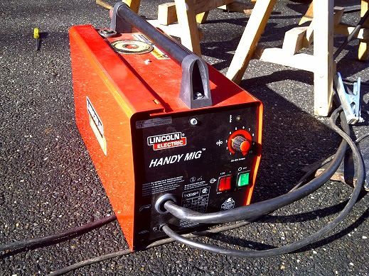

    Breaking out my old friend I bought this summer for around $350. Great little 110v welder with gas option.
    I cut the inch or so of extra length.
    Next weld two sections back together. I tacked it and made sure it fit then went back and finished up the rest of the seam.
    Back together again.
    With the Guten side skirt back on you could never tell the fender was cut. Even without side skirts it definitely looks presentable.

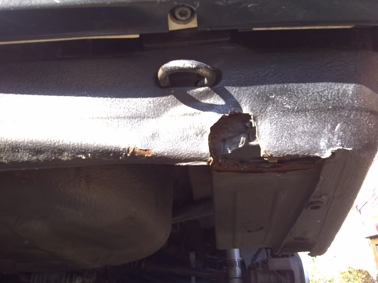

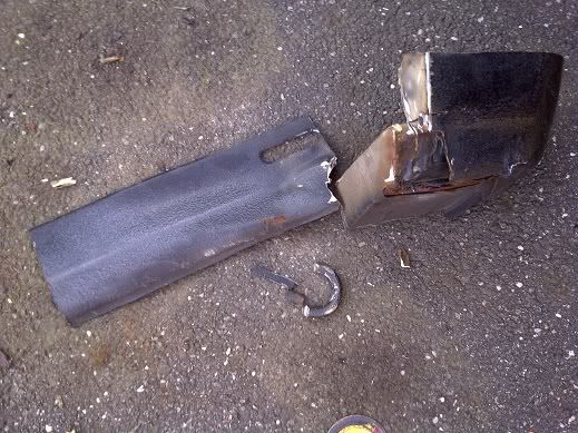

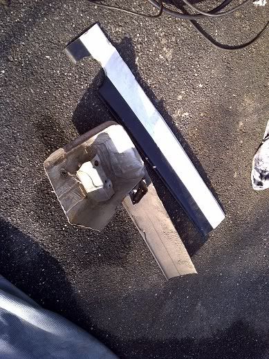

    Moving on to something i've been meaning to tackle for a long time. Unless you live in the southwest chances are you battery box is less then perfect. I will also be doing a tow hook delete.
    Luckily I was able to source some good replacement pieces from a 318.
    Cancer removed
    No turning back now
    New battery box in.

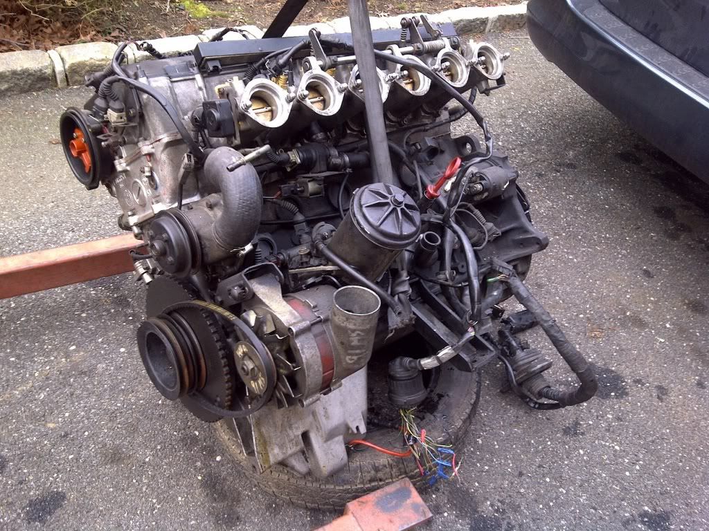

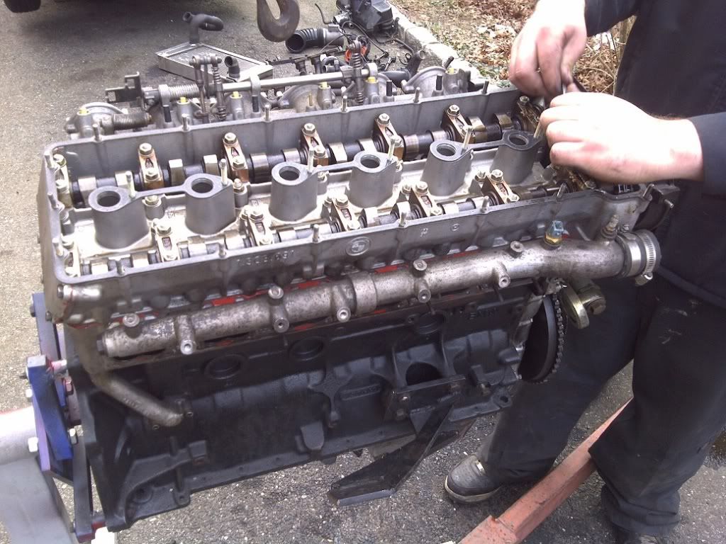

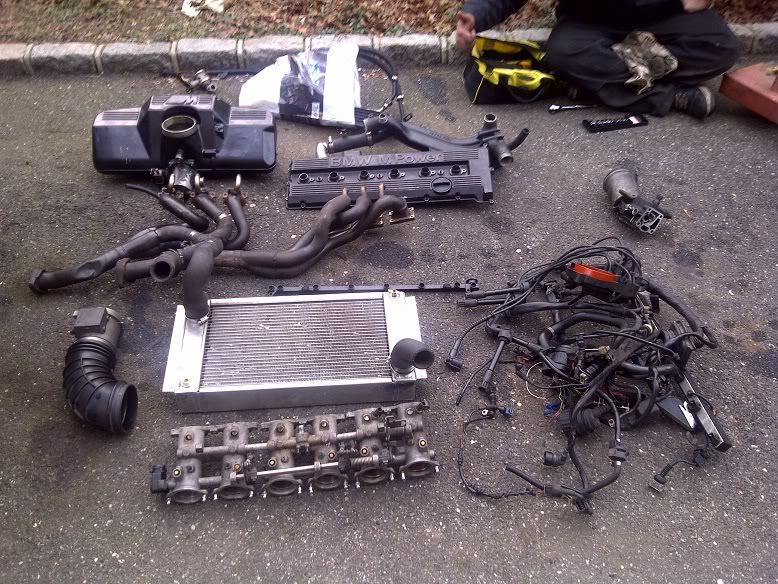

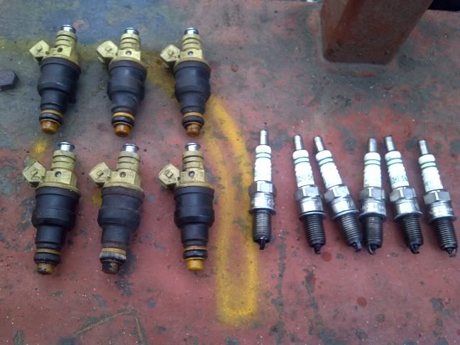

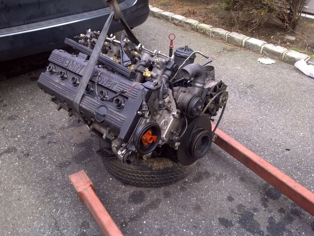

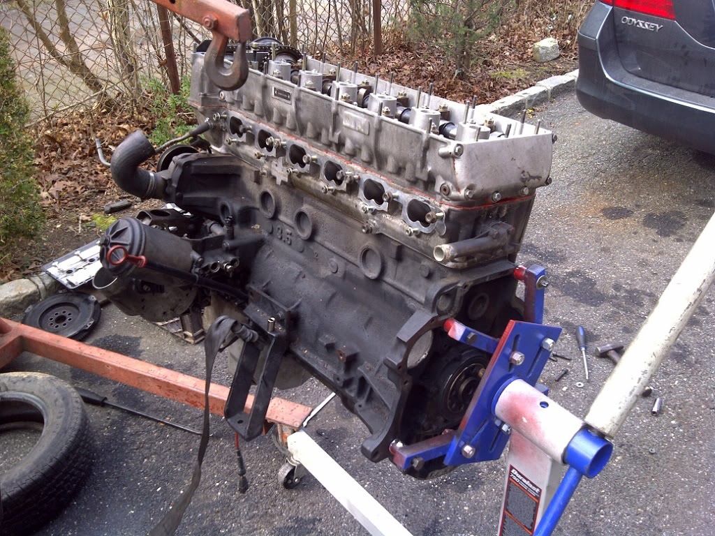

                  So I finally got out of school and it took me probably a day to find a kickass job working as an engineer for a tugboat company out of Philly. That being said I felt that I was finally in a economic position where I could finally afford an M/// engine. Intill now I have looked at S38 swaps with envy. Picked up a complete S38B36 today with, e30 motor mounts, harness, ecu, and custom radiator. I will be using the tranny from my M30 swap with the engine. All of this was picked up for a cool 1100. Why so cheap? The shop I bought it from said that there was no compression in cylinder #6. I took a gamble and brought it home. Here is the teardown.
                  Accessories that were included
                  19lb. yellow tops. Spark plugs were undamaged and clean with the exception of 5 and 6 which were pretty oily.

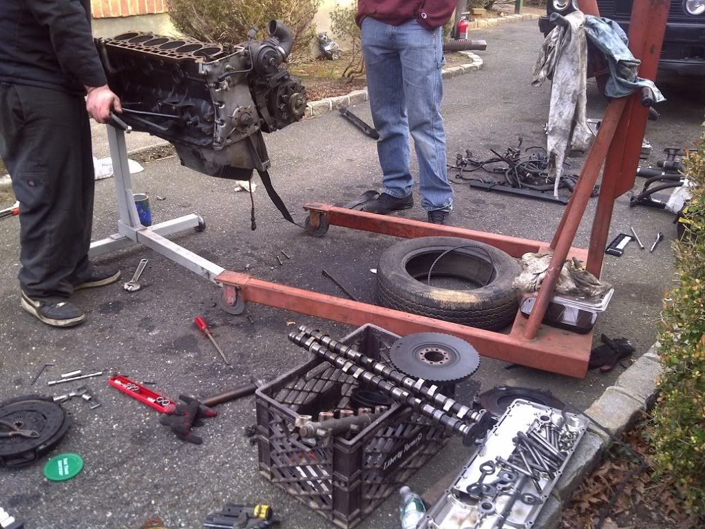

                  Looks clean so far

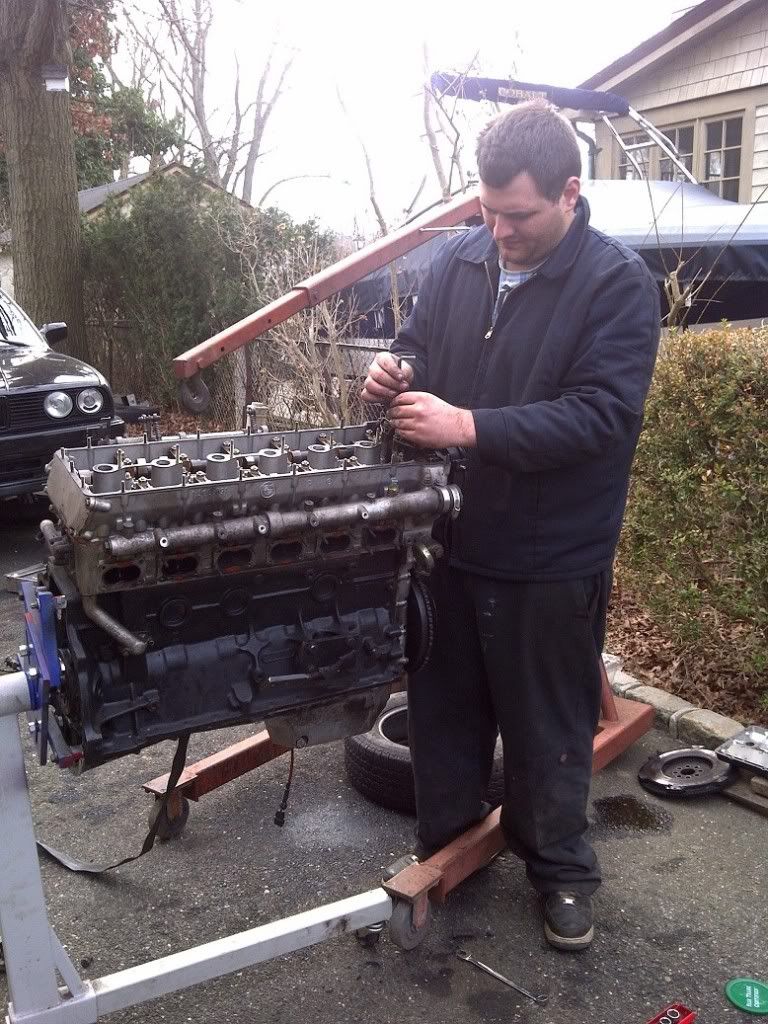

                  Getting some help from my friends.

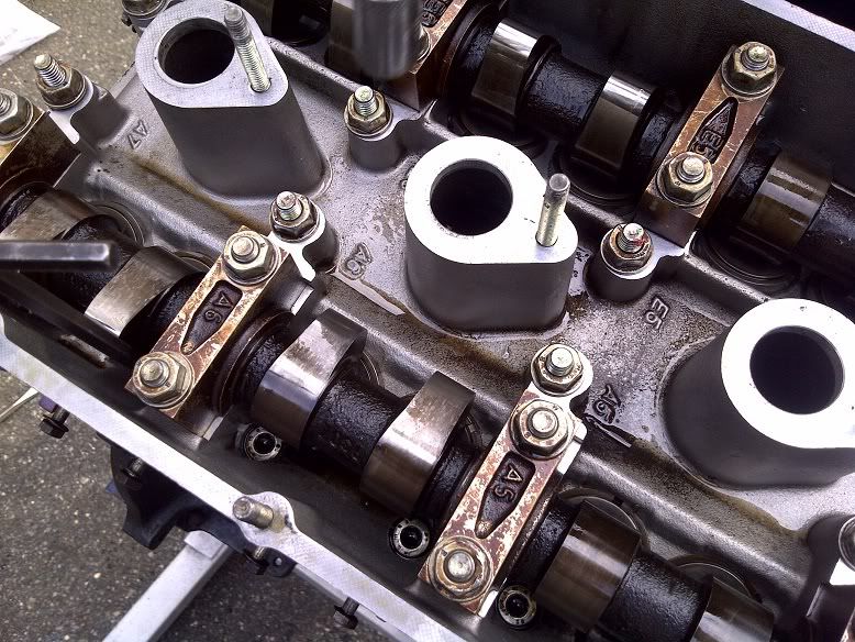

                  No sign of wear on the cams at all.
                  They got a little to crazy with the RVT.

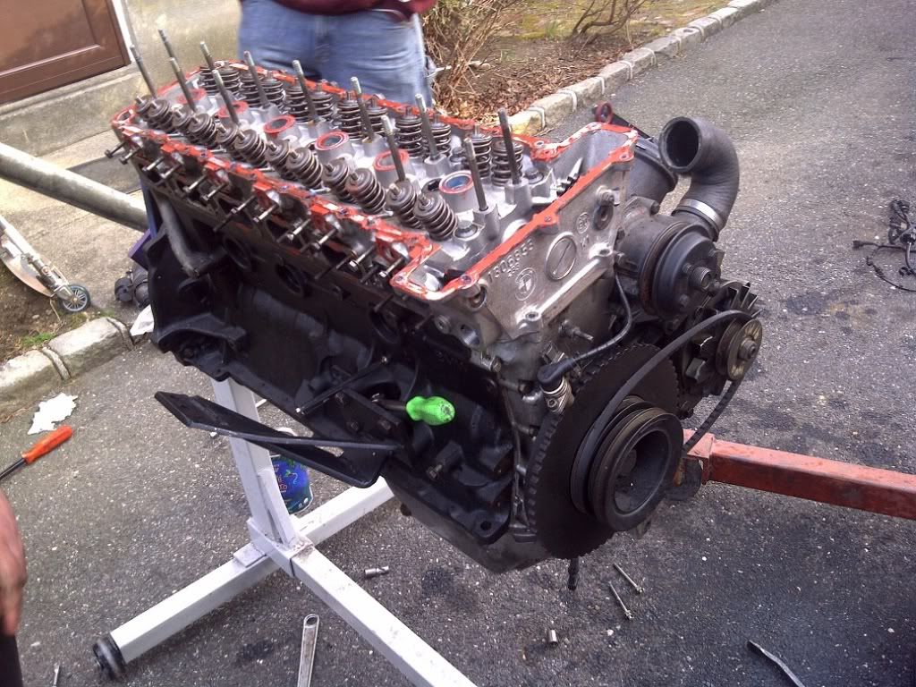

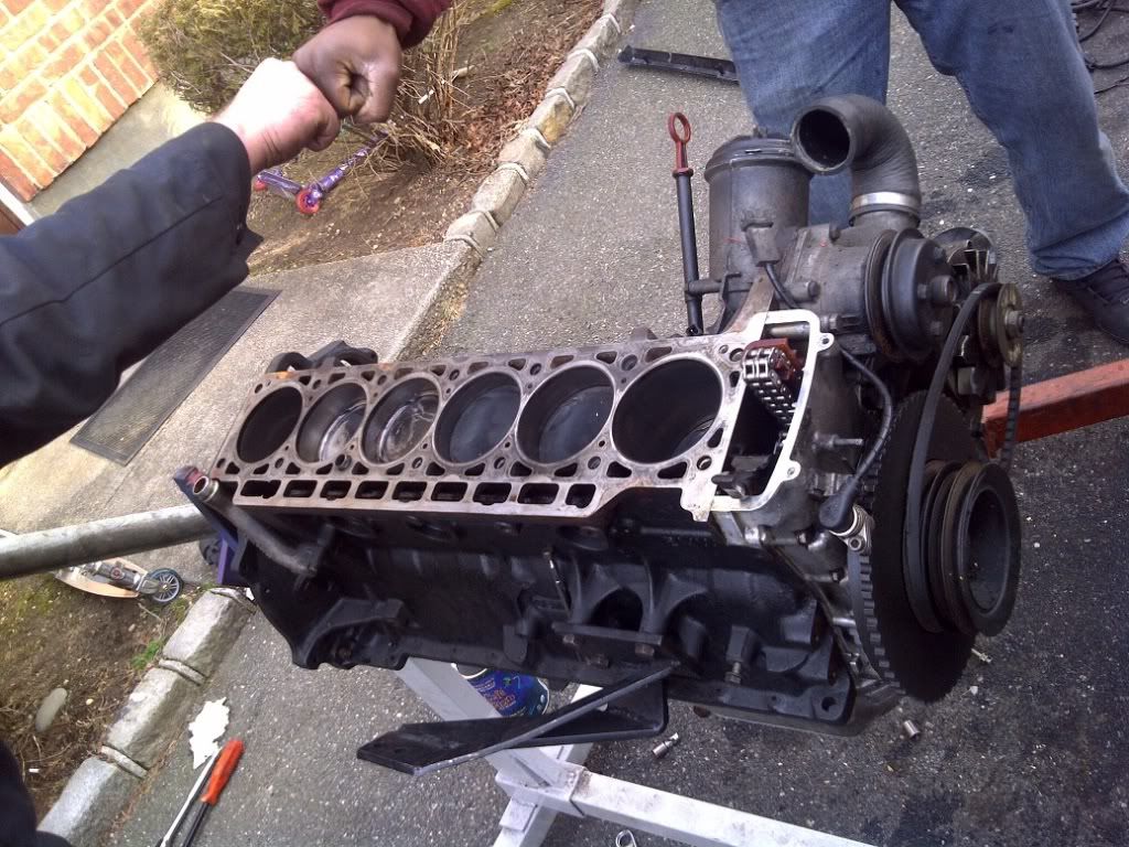

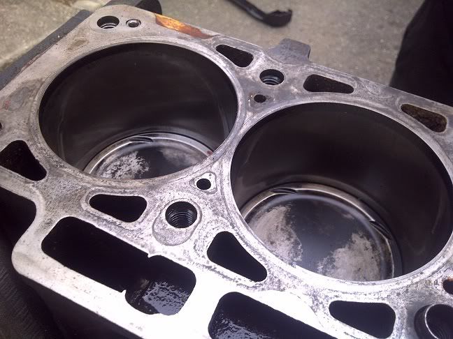

                  Head off. Looks super clean. All cylinder walls looks great. Underside of the head not too shabby. Celebratory fist pound!

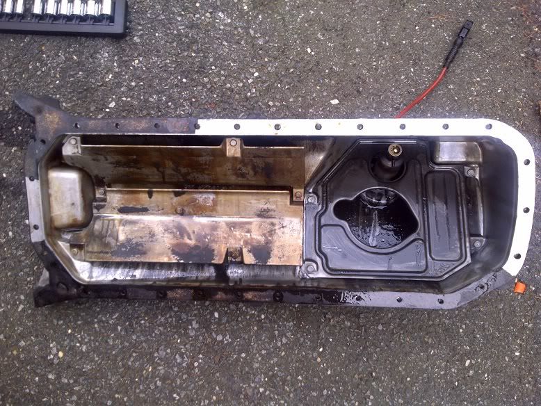

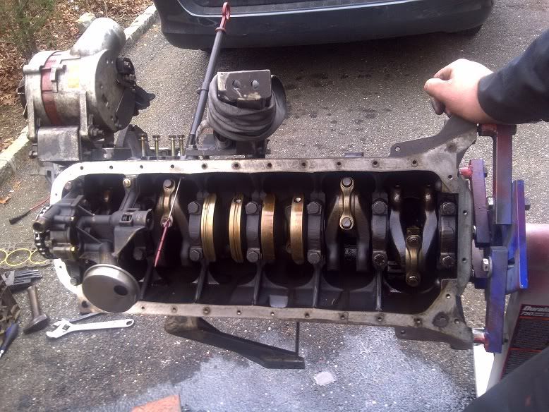

                  Pan off and oil drained. No metal specs in oil. Turns over great. Relatively clean
                  Little sludge in sump.

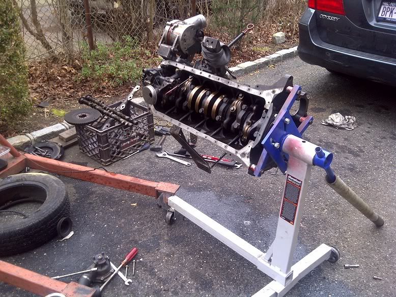

                  This will be a slow build but I will document everything from the rebuild to the install in the car. stay tuned.

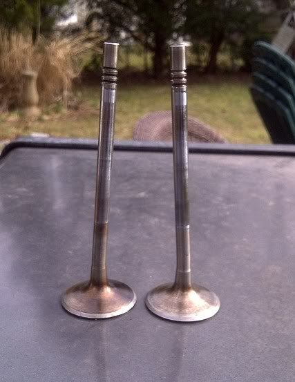

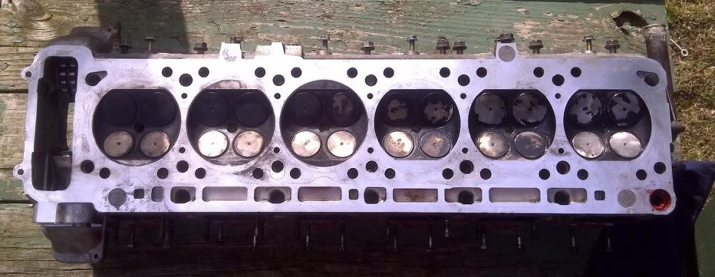

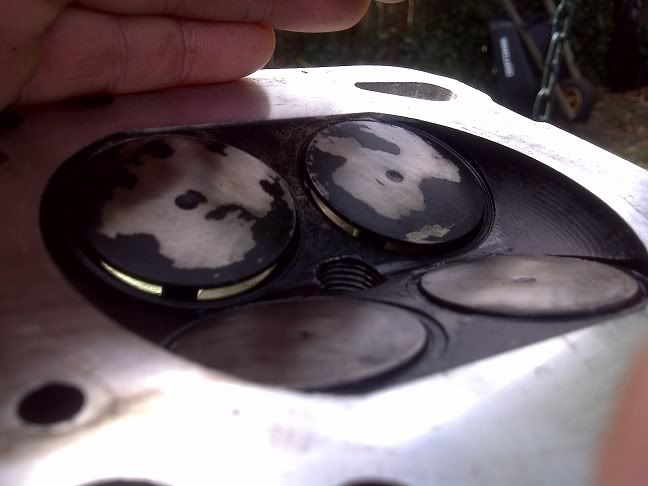

                      Took another look at the head today.
                      Cylinder #6. The reason for low compression is clearly evident.

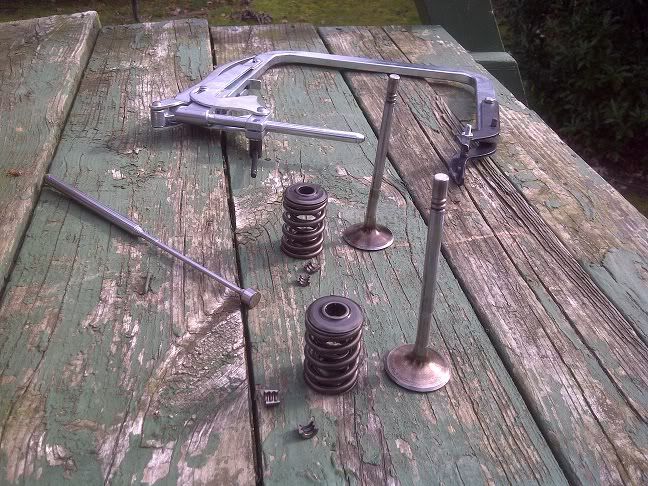

                      Valve spring compressor and magnet tool for removing the keepers.
                      Just as we suspected, bent valves. Now how did they get bent in the first place especially when the shop told me the head was just redone and there was no evidence of piston to valve contact?
