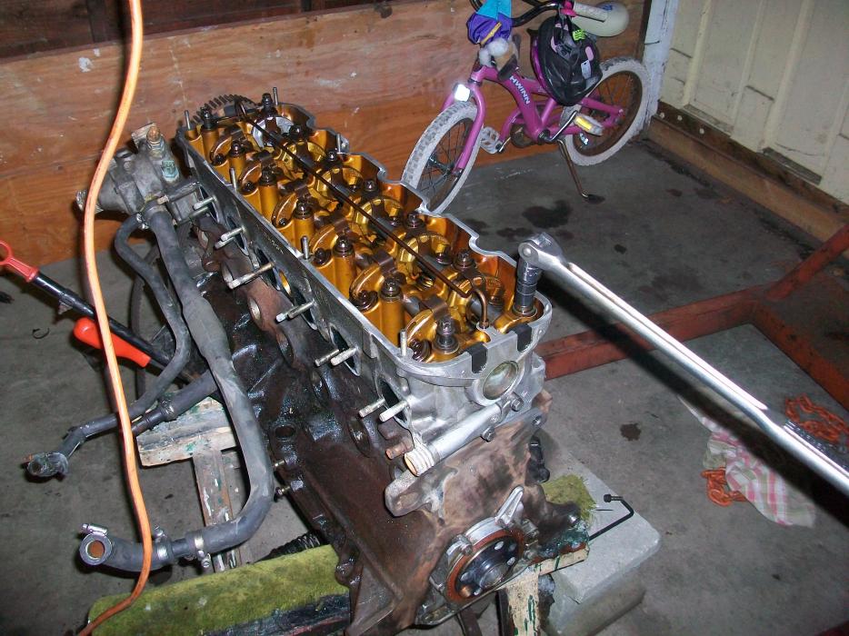

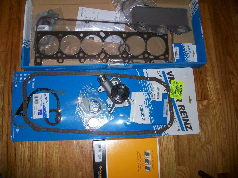

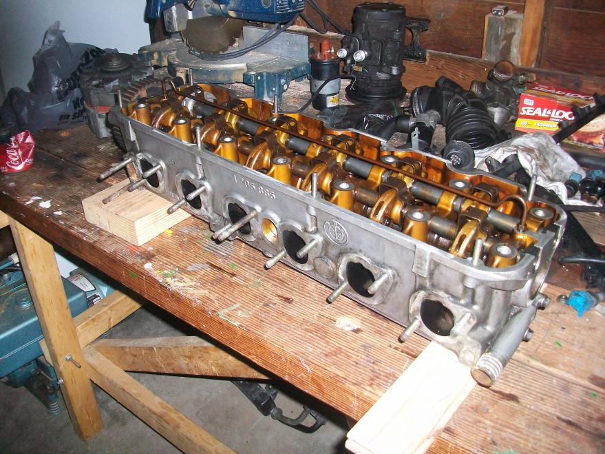

                      Now that the part out was complete, I could turn all my attention to the motor. New goodies..Block and head gasket set, water pump, timing belt.

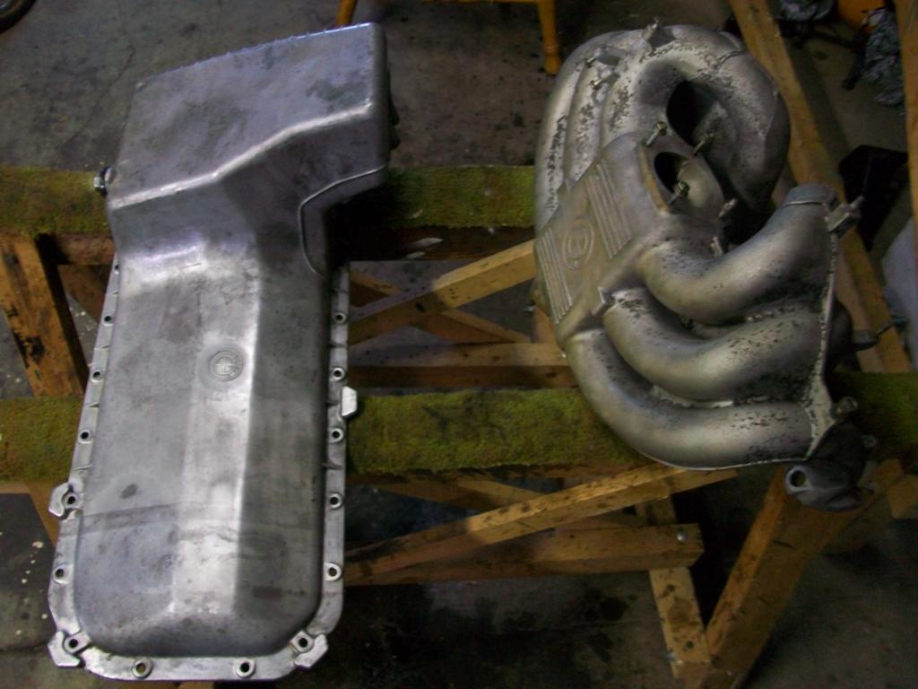

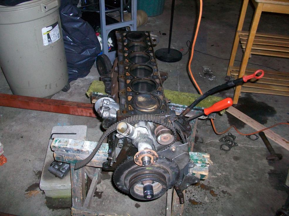

                      Breaking it all down

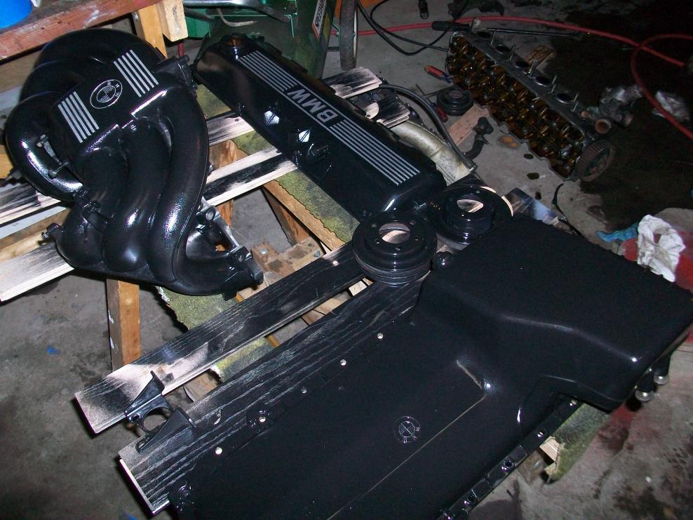

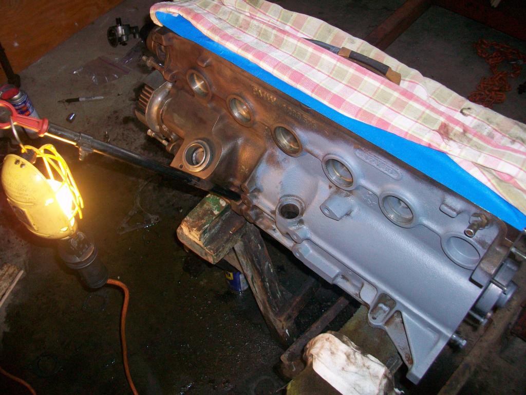

                      The hardest part was preping everything for paint. All the parts were covered by a layer of grease. Started out using engine brite but found out that pure gasoline worked alot better as a degreaser plus i had a shit ton of it.
                      The Build:
                        m20
                        Now that it was all degreased, i could proceed with painting.

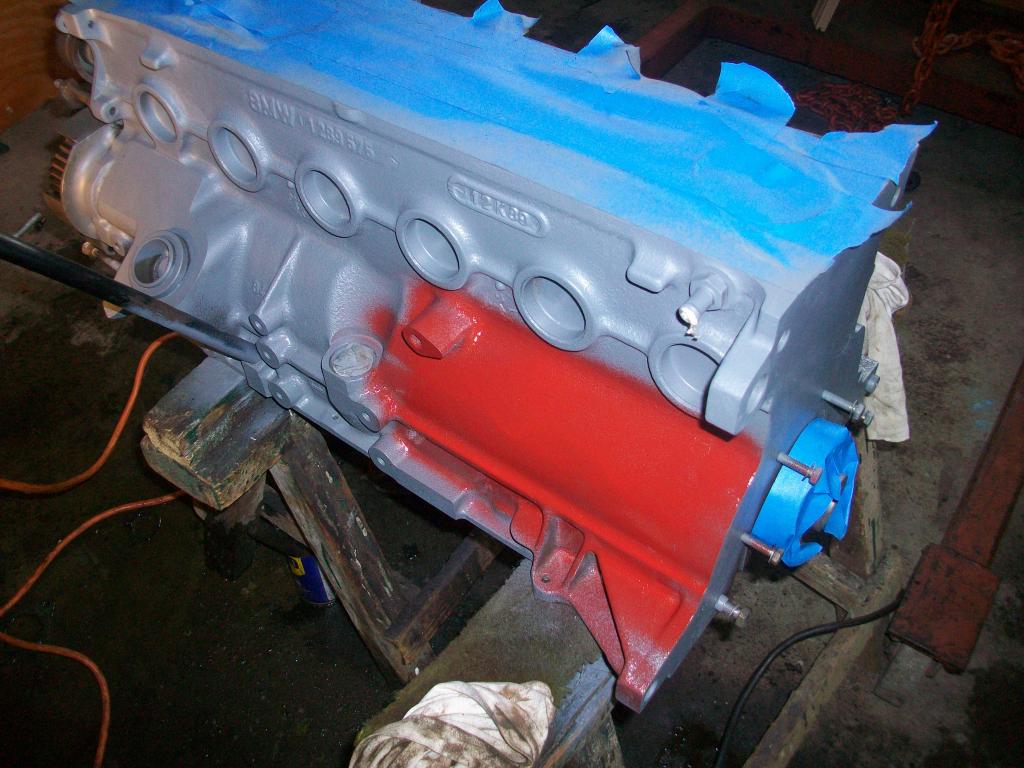

                        I used $6 dollar 500 degree paint from autozone which has stood up well so far. For the block i used a few coats of primer and then the fire engine red. I think its a nice color for the block.

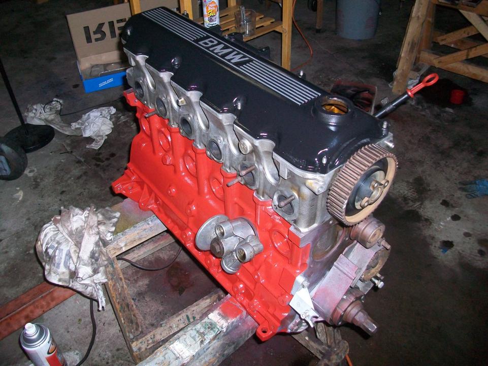

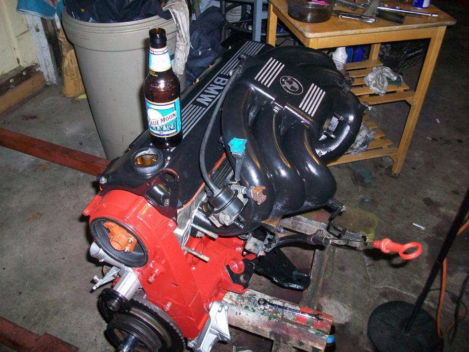

                        Moving along. Think it was early march of 2010 when this was taken. Click image for larger version
                        Blue Moon is the best beer i have ever had.

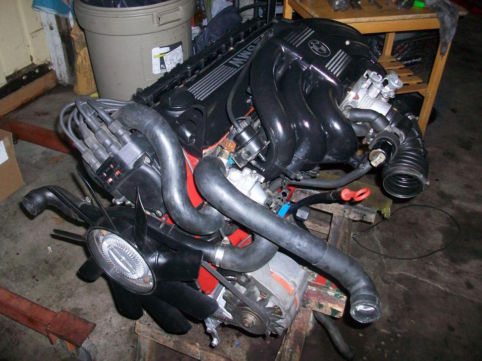

                        The Build:
                          M20 Teardown Complete

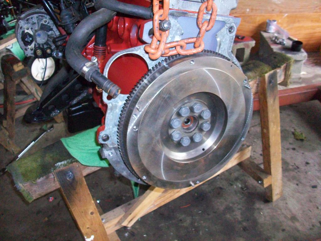

                          By April, the engine was done. I chose to use the same clutch and pressure plate since it was in good shape. I had the flywheel resurfaced and a few pounds taken off. Cost me about $130 at the local machine shop.
                          Coming up the M20 to M20 swap then the M30 to M20 swap

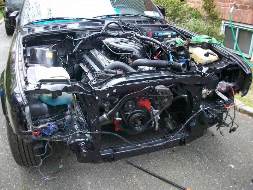

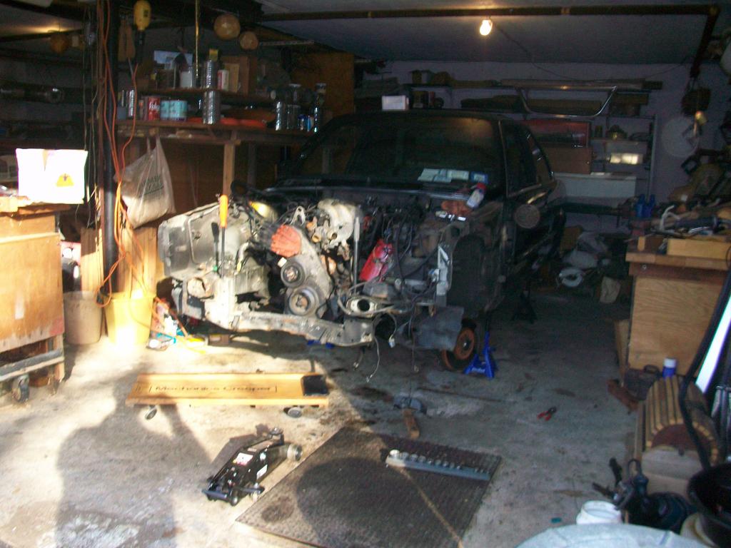

                              M20 Swap
                              March 10' removed the fried M20B25

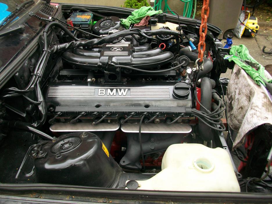

                              April-time to drop the new M20 in.
                              Finally in...
