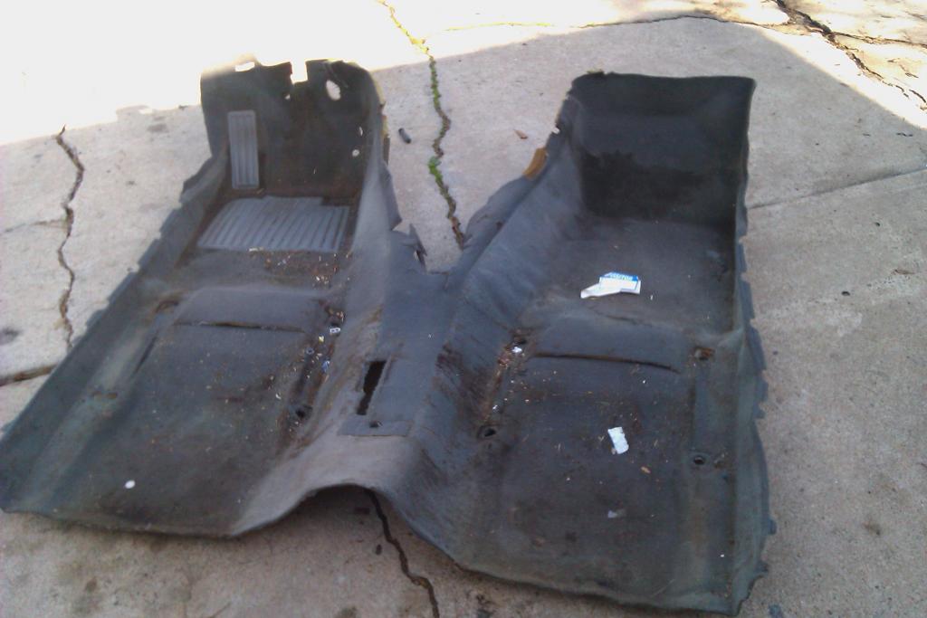

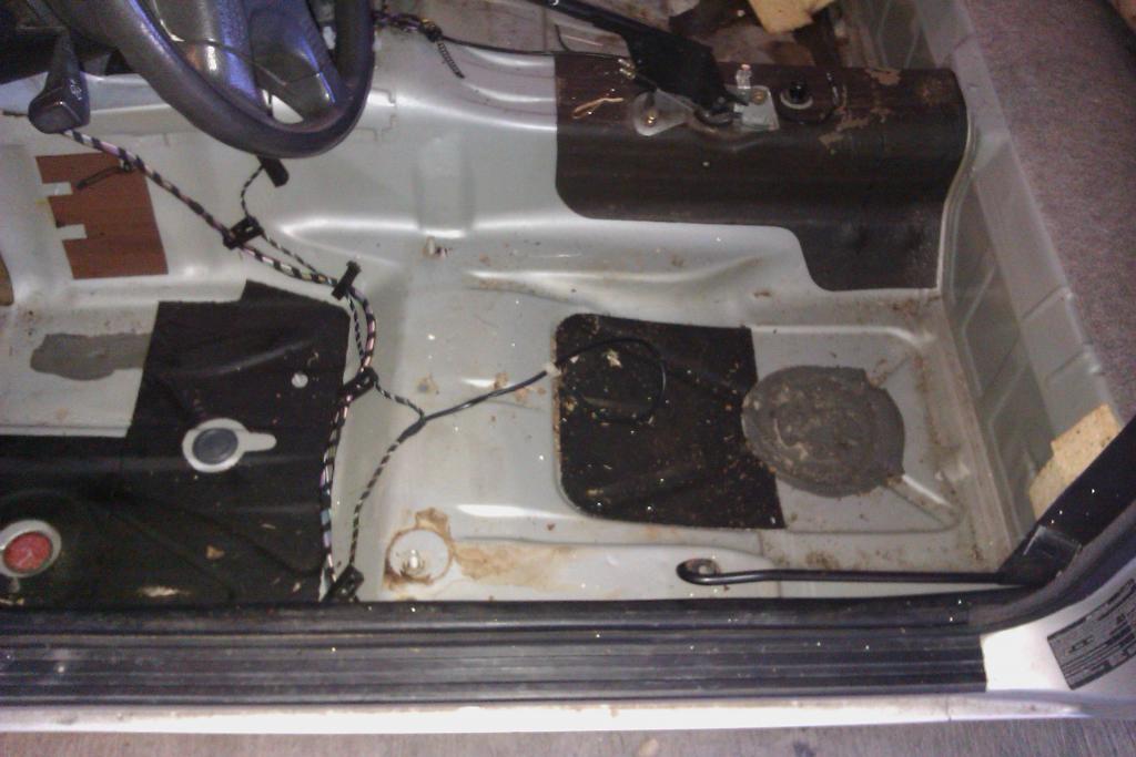

                                1-6-2011
                                Yanked out the interior while I wait for part. It's hard as hell to get this carpet cleaned. Pressure washed the shit out of it and now I'm gonna dye it as black as possible.

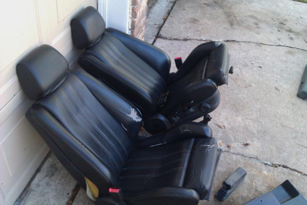

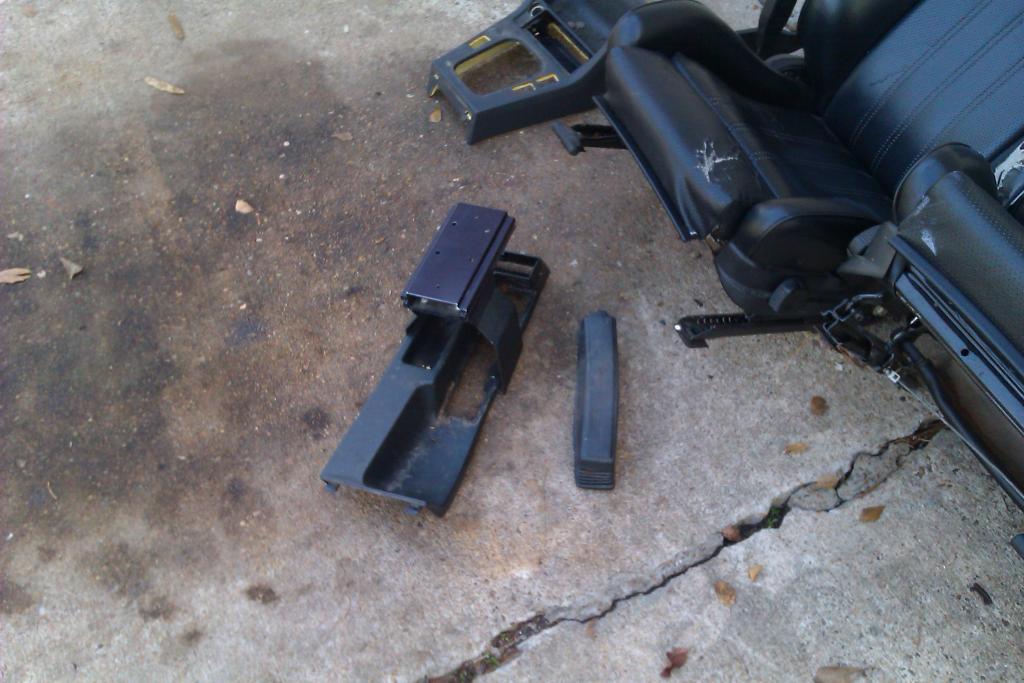

                                Seats work great and aren't too shabby. Took off the armrest cushion to reupholster it. PIX!
