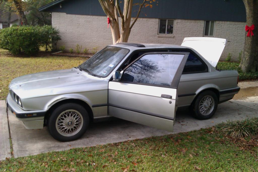

    Not bad for $500
    She's Sterling Silver, 80K miles, no rust except surface (rear kick), black sport interior, M42/240-5, umm... Little fender bend and some mechanical issues. This thread will be devoted to me doing a slight resto-mod.

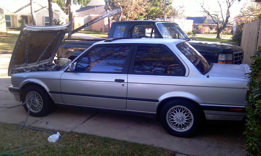

    Brought her home and wash the hell out of it.

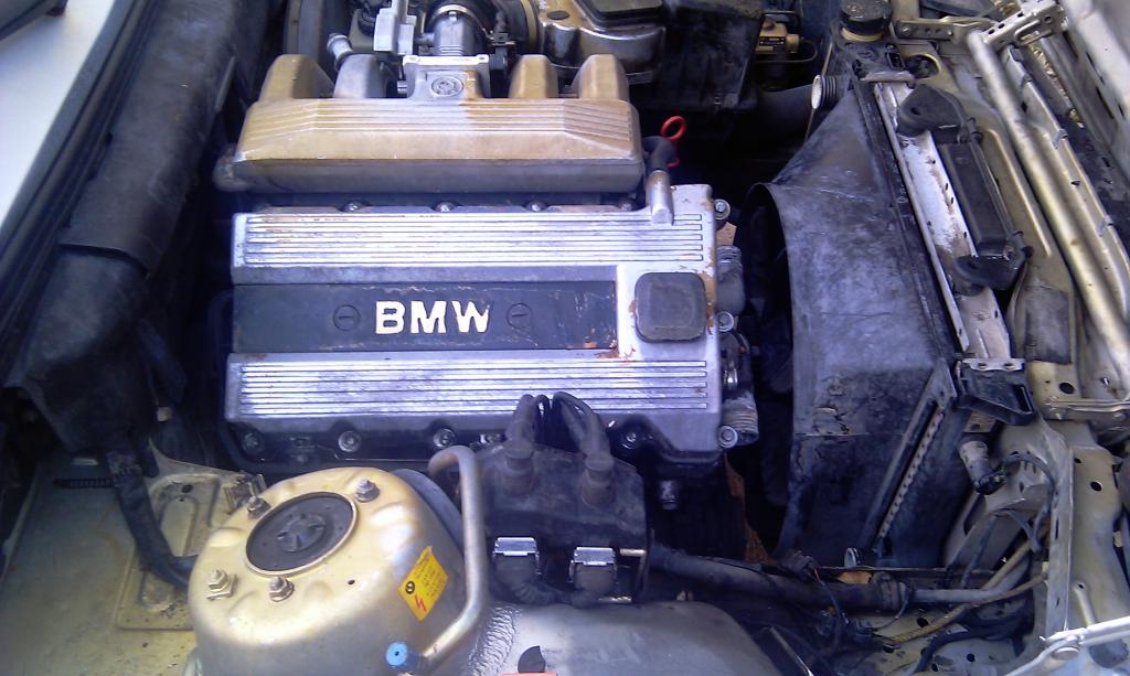

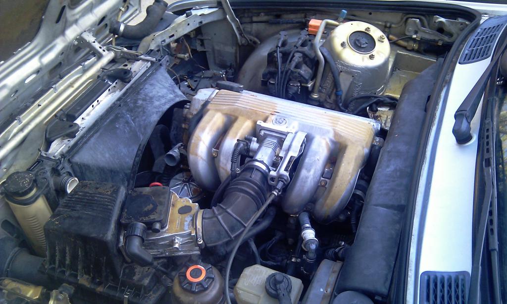

    Attached the coolant hoses only to find a horribly fast leaking water pump.
    Started her up without coolant, not much smoke but after adding seafoam to the oil and coolant in the radiator out pours white smoke!
    Motor hesitates and shakes pretty bad in the lower RPM's but when you bring it above 3k it r3v's so smoothly and nice. anything below it sounds horrible and misses. She pours white smoke when you hit the gas as if it just got a seafoam treatment through the intake.

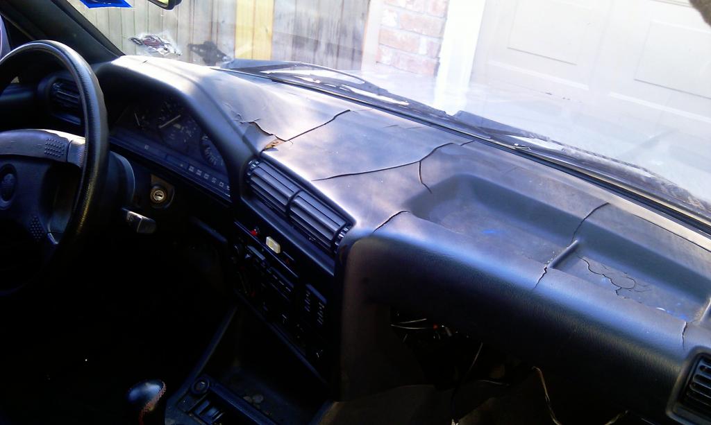

    -DASH IS EPIC FAIL! Large cracks and glue everywhere

    Now, before I tear this engine down I wanted some suggestions on what to do or what the issue might be. Here's a quick video of how it sounds.
    Please excuse my truck running in the background. I know it makes it hard to hear the car but this should still give you an idea of what's going on.
    any ideas?
    My major issue right now is this. Weather to tear the motor apart and machine/rebuild or to find a swap. Only thing about going the swap route is it has to be plug and play right now as I don't have time to source parts or the extra cash so M20 or M50 sounds legit.

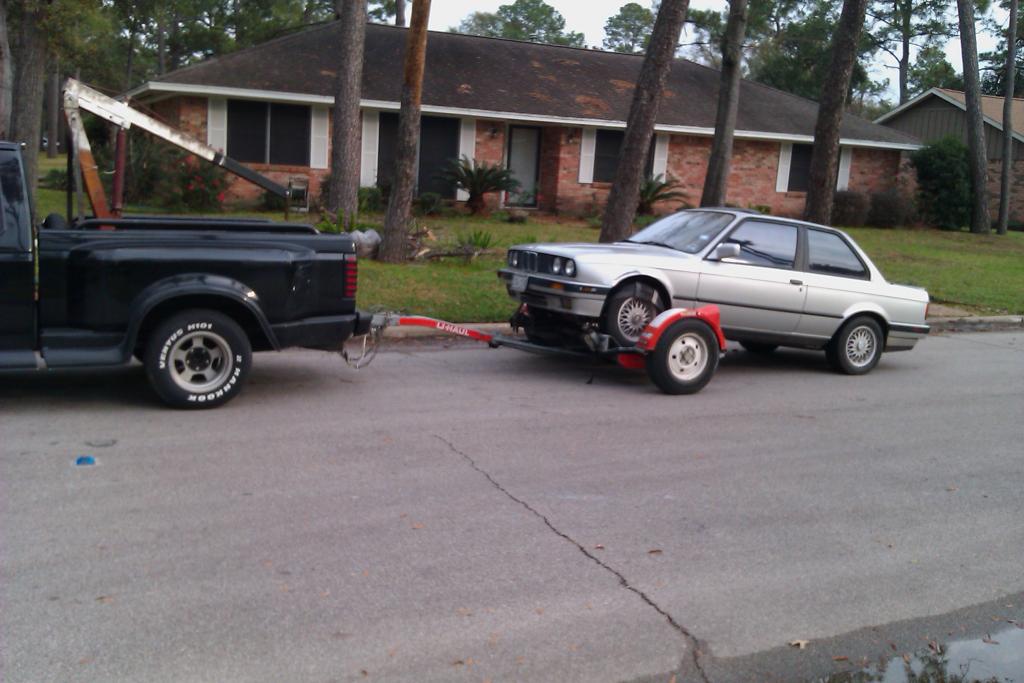

    Getting it home

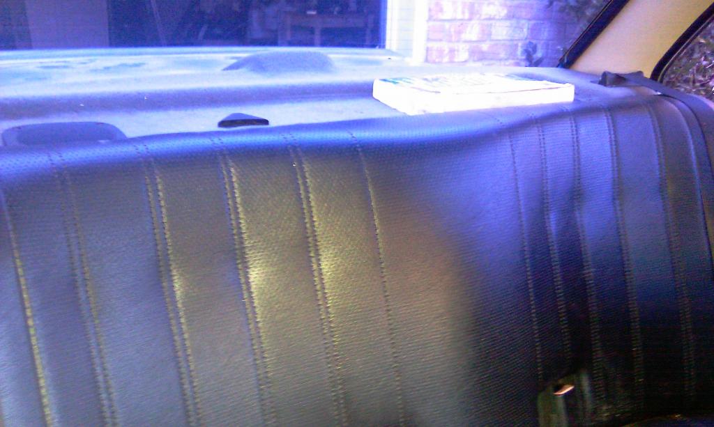

    Dash

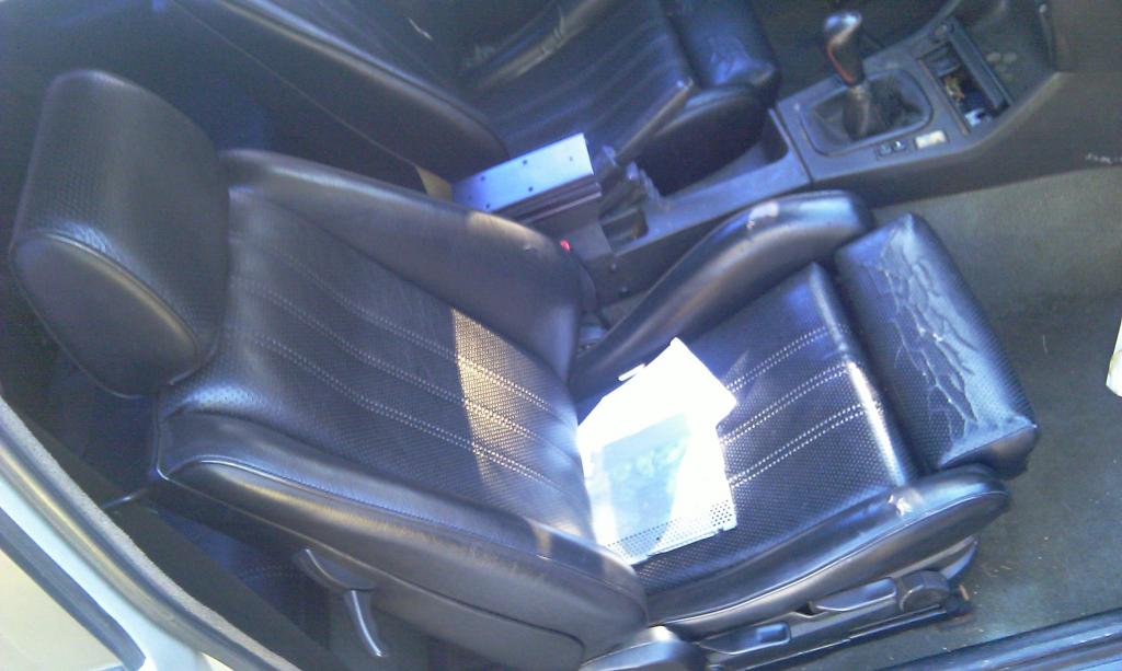

    Seats aren't that bad

        Ur burning coolant. i believe white smoke is for that... U mite have a bad head gasket or sumthing.

                I'm going to keep the M42 and just build it as I got. I don't have lots of cash to throw at it now anyway. Still, slowly ripping the head off.

                  In my experience hesitant low rpms and smooth higher rpms can be due to a loss of compression. Along with the white smoke, im guessing you'll find a cracked head gasket and hopefully, not a cracked head.

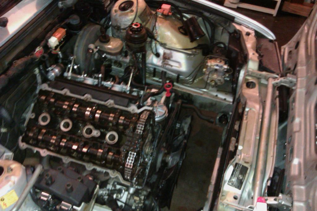

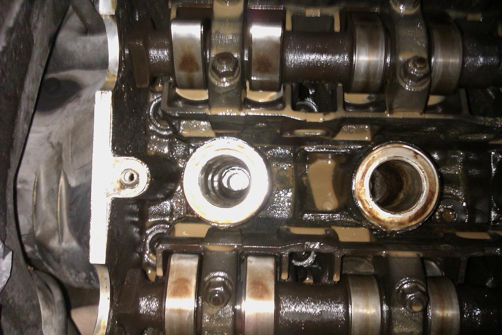

                      1-4-2011 -Found the milkshake under the valve cover, spark #3 covered in oil.
                          this might help...

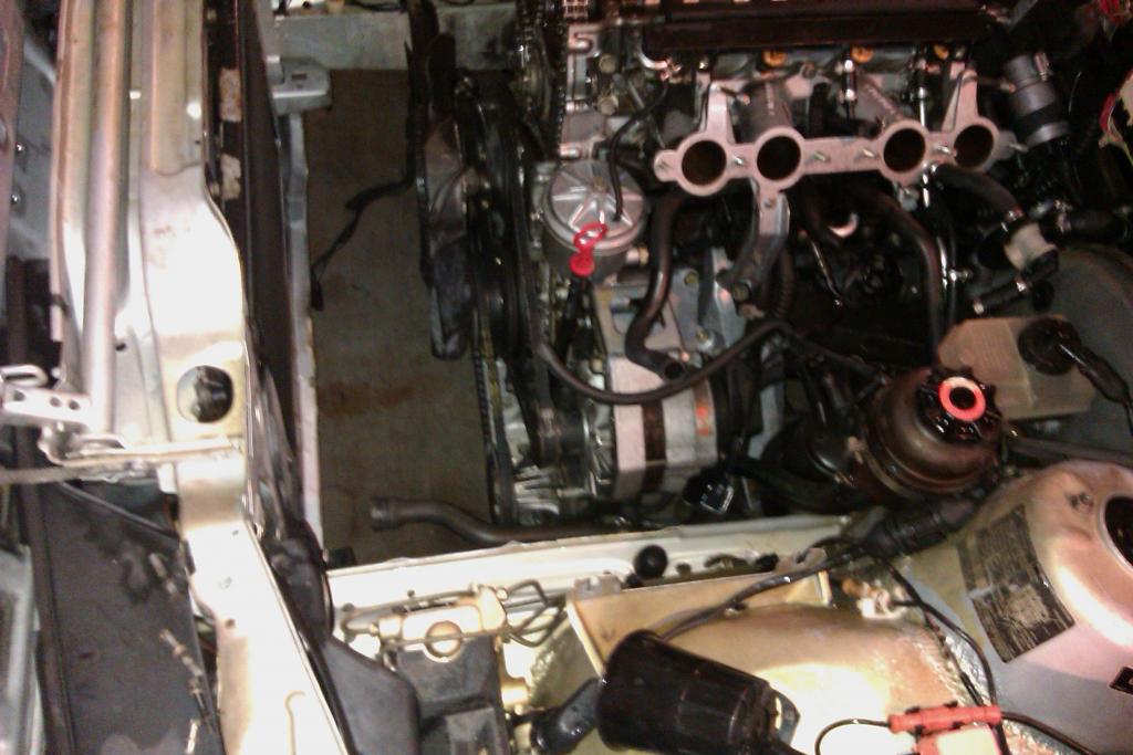

                              Findings
                              This looks more like a malty milkshake
                              Is something missing here?

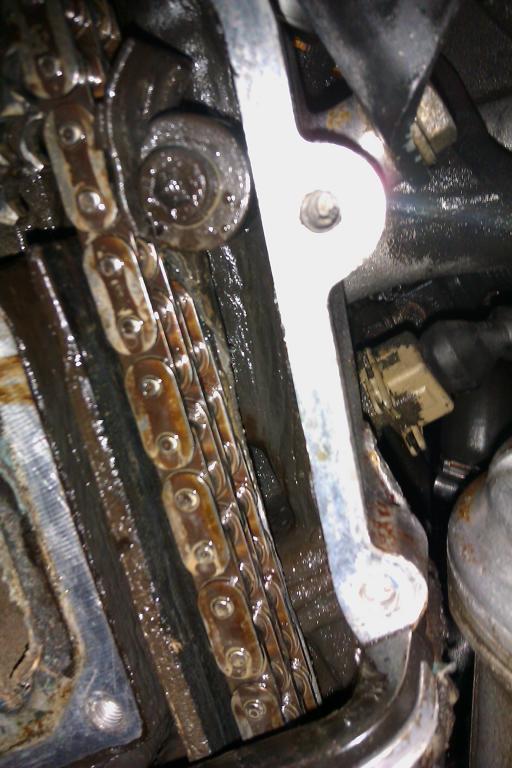

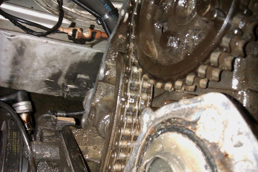

                              Cam gears... Look okay?
