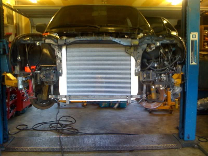

    I basically ordered the biggest griffin radiator that would fit between the frame horns and cut to fit....and it works including a ac condenser and a 16in spal fan all under the stock valance and with the stock hood hinges
    Interesting... not sure if the mechanical fan would clear that though.
      His V8 is not as deep either, I know for a fact I'd have zero luck with a mechanical fan (or engine shift) with a radiator mounted in the stock location.
