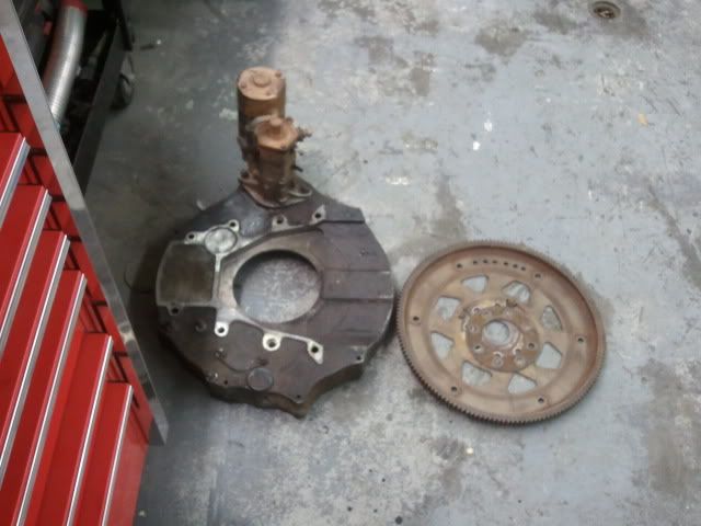

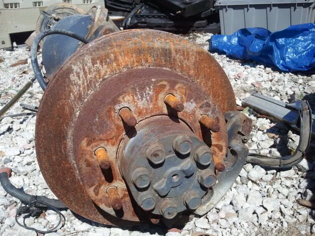

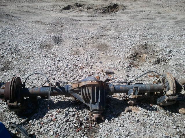

At any rate, before i was interupted. I got the adapter picked up last night. Looks good and it was cheap. Also got this little gem picked up too. Disc brake full floater for the rear. Looking for a 1 ton front as well.

Glad to see a heavier rearend there and happy to hear of more support planned too. Trimming and lowering for the win as well.
If you'd shared more plans initially I'd have had much more faith to begin with. Maybe it'll be done right after all. Looking forward to the progress.- Michael -

Got some 2x2x1/4'' tubing coming friday. That way i can get my trans and transfercase members fabbed up. As well as some 4x43x8'' angle for that hoss of an engine.sigpicComment
