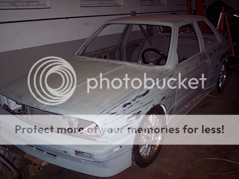

                          Since some of us didn't go to H20i, I thought I'd put up a few new pics. I've been slammed busy at the shop, which is a good thing, but it really slows down my progress on the project.:( The upside is, I can still shop for parts and they keep showing up, haha. I picked up the driveshaft, the rack and a set of tails(thanks Matt) and an OEM M3 front bumper. The bumper was hand delivered by an s14 member who happened to be making a run down to Maryland and dropped it on his way down yesterday(thanks Mike). I went over to the shop tonight and hit it with a quick coat of primer and slide it on the front of the car and snapped a couple of pics...
                          I have to pick up a second pair of OE skirts from Levent at Guten Parts this week and I'm also putting the motor together, when time permits.
                          So, all said, there is progress, just a little slower than I'd like, but being busy pays the bills...
                          Garey

                            #448
                            pictures no workie
                            Originally posted by payney8
                            We heard economics is american for card game t/f ? :P
                            • bmwmech1
                              • Jun 2010
                              • 1075
                              #449
                              Originally posted by neighborhood
                              pictures no workie
                              Hmmm, I can see them and the link is good from Photobucket. Don't know...
                              Garey
                              • drutt23
                                • Feb 2011
                                • 392
                                #450
                                I see the pics. Looks good! LOL
