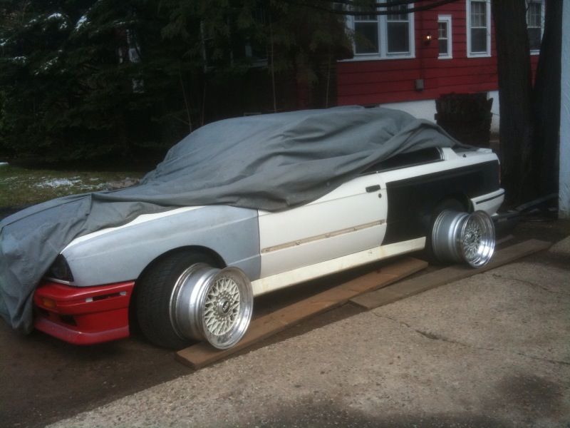

    we will be working on this next project soon, less involved than yours but similar goal :up:

      Is that a pic of the "new" project, everybody on s14 is drumming you about, Lol?
      I'm amazed at how quickly you were able to put together the misc body pieces... looks like you have all of it accounted for. Dare I ask what powerplant, or too early to let that cat out of the bag? Rears look pretty wide...

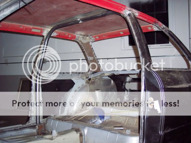

              Well, I got the main hoop made and fitted into the shell tonight. The cage is underway! The next progress post should be in about 20 days... this may take a while, Lol! Anyway, I snapped a photo to keep everybody happy...
              Garey

                I stand corrected... I got the A-pillars done and the windshield bar bent and cut, but not fitted yet, so maybe it will get done quicker than I thought, Lol! Pics...
                I was able to keep the tubes tucked into the A-pillars and they're completely buried above the tops of the doors...
                You can see the windshield bar lying on the column supports and the crazy shape of the down tubes... I may not even have to modify the dash to clear the tubes...
                Stay tuned...
                Garey

                  Sweet man!! It's lookin great so far!! BTW.....this would be later down the road of my project because I'm not far enough along that I can start the cage/reinforcement....but anyways, would you possibly be willing to bend some tubing for me so that I may do some similar things cage-wise. Probably not as extensive as you are doing, but I would like some extra support in the car that can be tucked away as close to the body as possible.
                  Oh and how did you get the weld all the way around the tubing with it that close to the roof and pillars?? Did you remove the roof again??

                        As far as bending some tubing for you goes... All of this work is being done one piece at a time, fitting it to the car as closely as possible, with many, many test fits. There's no way for me to just bend up some tubes and hope they'll fit like I have made them fit here. I'm flattered that you would want me to do it, but it's just not realistic. Plus, you'd have to buy the tubing and have it shipped to me, which is expensive and for my time to build it, it would be cost prohibitive. I would recommend buying something. They have done all of the work in designing and can offer the finished product at a competitive price. This is more of a custom built car, where price is really not an issue. To duplicate it would be pricey...
                        As far as the welds go, it's tacked right now. Nothing can be finish welded until the entire cage is made and fitted, then everything is disassembled and fully welded.
