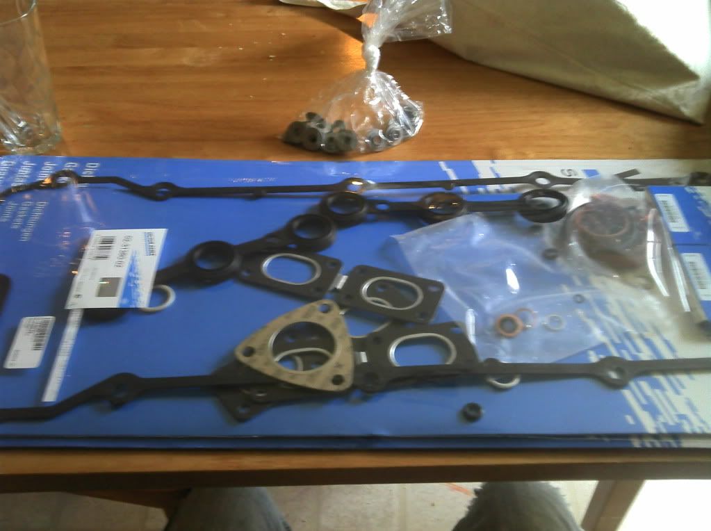

              $480.00 that I didn't have later this arrived at my door step:
              Blunt doesn't fuck around. This was ordered late last night and less than 12 hours later, there was a knock on my door.
