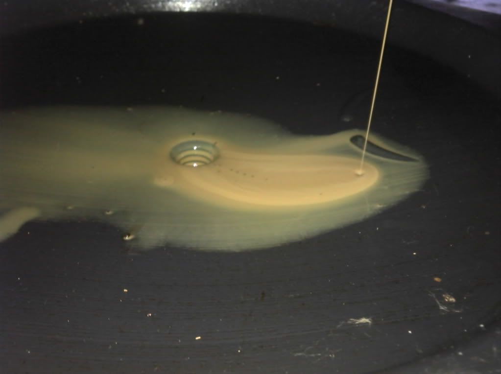

            Ha, if you want to stop by. I've got an oil change I'll HAVE to do in ~500 miles. Here's why:
            I probably wont be going on the Townsend cruise. Not only the only BUT, I have to figure out my rear springs/fender issue a bit. Removing the spacers in the rear to eliminate the tiny bit of rubbing I have going one even with it raised up an extra 1"

              Mmmmm...pancake batter. haha. But seriously that looks like elmers glue. If you need a hand and I'm not doing stuff for school, I'll be more than happy to help.

                Just changed the oil after a bit of a drain, fill with seafoam/oil, run for 10 minutes, drain and then re-fill again. Drove around the block a few times and the damn thing runs like a champ. Have to remove those fucking spacers ;)

                  Where was the leak?
                  • ck_taft325is
                    • Sep 2007
                    • 6880
                    #69
                    Cylinder 6 water passage. Blew between that and the cylinder wall on the gasket.
