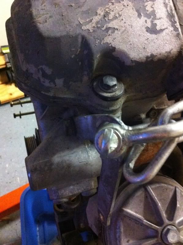

                          Took the impact to the engine tonight. Got the harmonic balancer, exhaust manifolds, and the AC bracket off. Can't take the oil housing off till I get something to contain the oil.
                          Also put back on the water pump and thermo housing to get it ready to be cleaned. Don't want dirt, etc going places it really shouldn't. ;)
                          Gotta figure out how to get those studs out....
                          My reminder to drain the oil, pulled out the dip stick without thinking.
                          • pandaboo911
                            • 2070
                            To get the studs out is easy, double nut (or triple nut if necessary) each stud. Thread 2 nuts onto the stud, tighten both nuts in opposite directions, so that they lock together in place, then turn on the bottom most nut to take out the stud.
                            To remove the nuts from the stud simply loosen the top most nut while holding the one under it in place.
                            If that makes sense..

                              It does, using the force of the nuts against each other allowing the stud to loosen instead.
