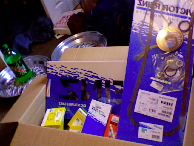

                        #41
                        Just got in a box from blunt =)
                        I am awaiting crank from forum member
                        Schrick 284 cam from Vac
                        Adj cam gear from IE
                        Timing belt Tensioner/bolt and spring and valve springs from Steve
