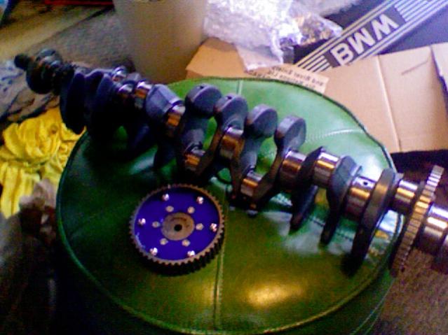

              Update:
              Crank came in and IE adj cam gear with it. Tomorrow the last of engine parts from blunt is coming in. Pulling engine tomorrow night or on the weekend(100%)

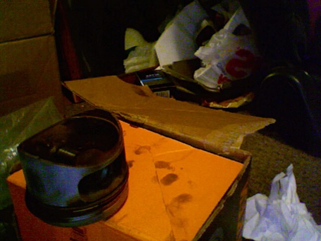

                            People were talking about that the pistons might need to be cut? I took a quick picture to show them, I believe they are the sort ones that are needed. There is not much to remove on the skirts...
                            Update coming soon tonight!
