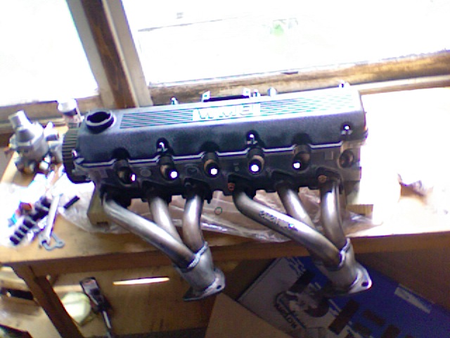

    Another with the crinkle painted valve cover.

      That flipped pic looks a bit freaky! or you have a rare head there :)
        He's running the Honda version of the engine. Backwards!

          Youd be better off with ebay headers than those shorties...
            Had them, they are complete shit.

              Are those the IE shorty headers? Nothing wrong with those! My set was great on my old 4 door.

                no those are MSDS headers

                  They dont do anything, I have a set too.
                    IE makes a copy, and they still dont do anything. ;)
                      Better than the stock ones and those shitty ebay long tubes. These fit like a custom glove and look very nice. They get the job done and that is what they were bought for.

                        The only thing they do better than stock is weigh less and rust.
                          the IE headers are eeever so slightly different i think, but yeah. ebay long tubes > shorty headers
