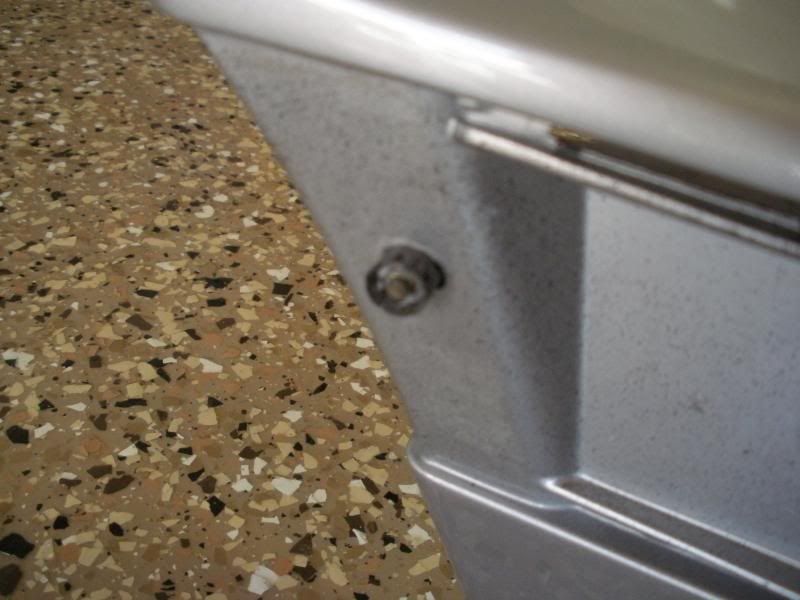

                New find... do I take the time and install this cool piece or not?
                I am thinking yes, what say you guys?

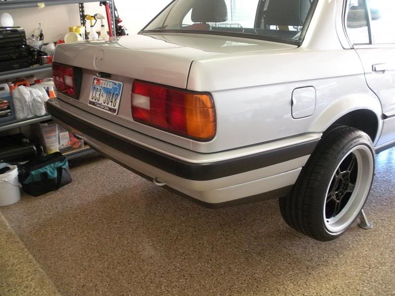

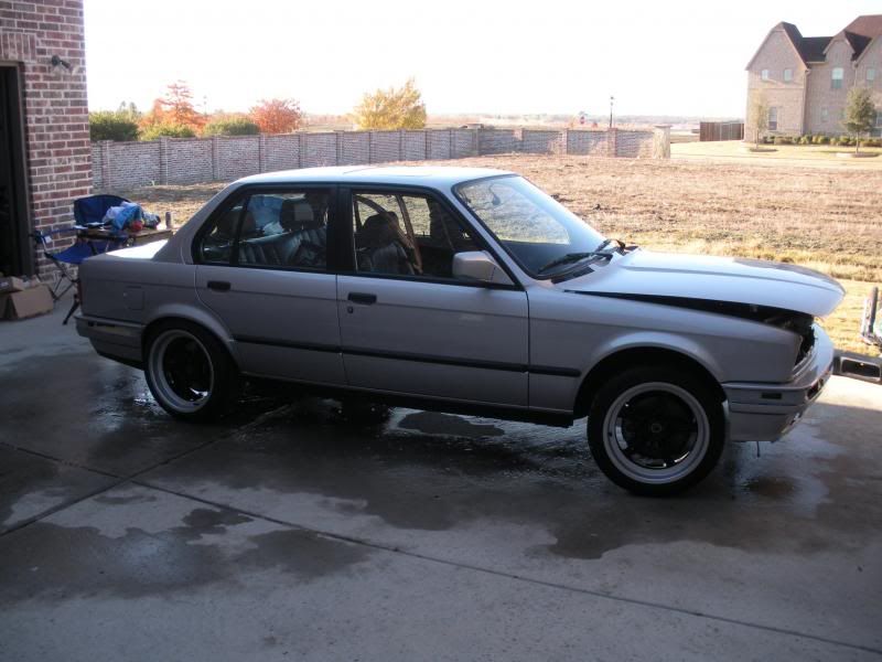

                        After more than a 6 month timeout due to the birth of my son project Euro S50 is back!
                        Rolled it out of storage and gave the car its very first car wash

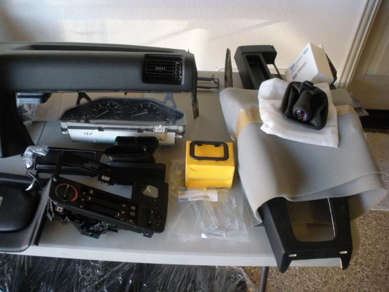

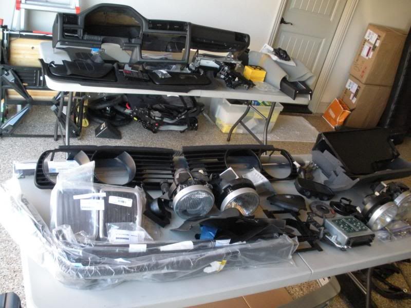

                        Next item up was setting up some parts tables to start getting all the packed up parts sorted and start a working to do list

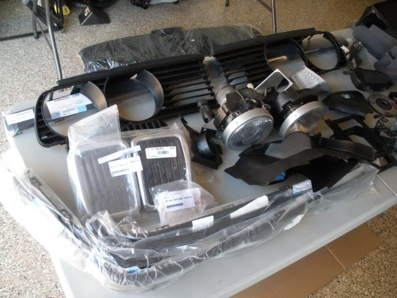

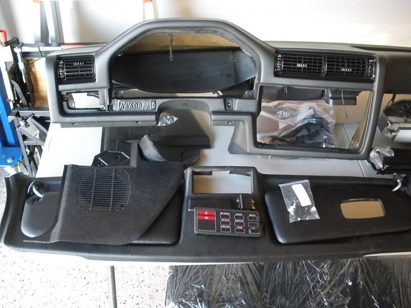

                        Sir Blunt provided all the new Euro trim, all new interior console pieces and lighted shift knob.

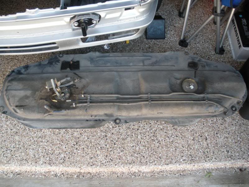

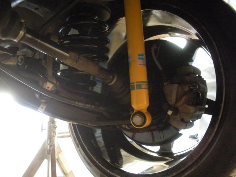

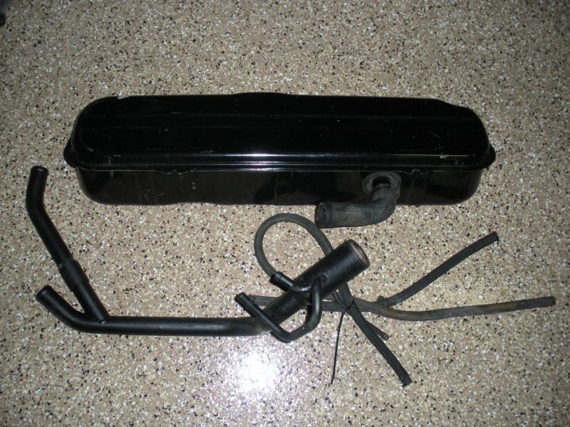

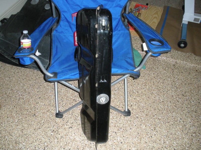

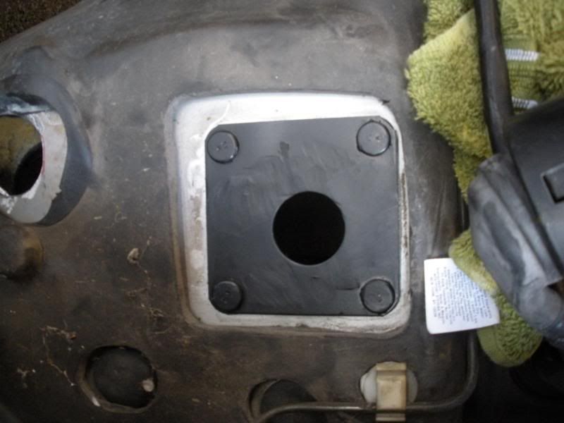

                        And since it has been a few more months some more funds are available for the project so I'm going to go ahead and do it right and install a new gas tank and fuel pumps. The original has a big dent on the passenger side of the bottom of the tank which is not good given proximity to the pump.
                        Today's project was removal of the original tank. Pretty simple actually when all the fuel hoses are original you just cut them with a wire cutter, unplug pumps and sender and then remove filler neck and 5 bolts holding up the tank and out it comes.
                        My dad helped get me started on the project again and while dropping the tank we were both pumped about how cool it is to see a completely refurbished E30 M3 rear suspension from underneath.

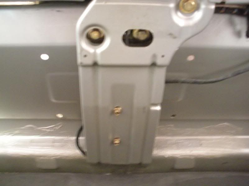

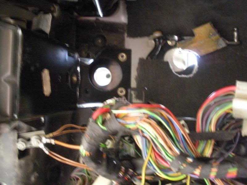

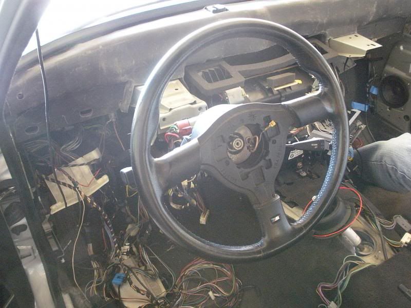

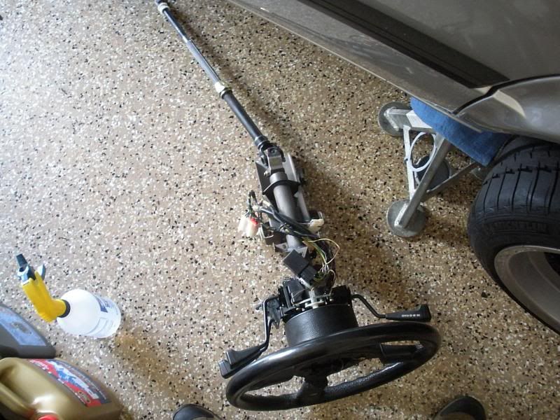

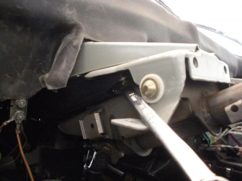

                          Back after it today and need to simplify all my parts storage issues along with marking the car movable due to completely removing the steering column to weld some mods to the pedal box and also install the new firewall insulation.
                          Up first - reinstall steering column
                          modified firewall bracket from E34 540 to allow for remote brake arm to pass through firewall to booster up by the drivers headlight
                          Remount pedal box bracket to firewall
                          Slide back into column bracket the steering column and then mount with hardware
                          All complete...

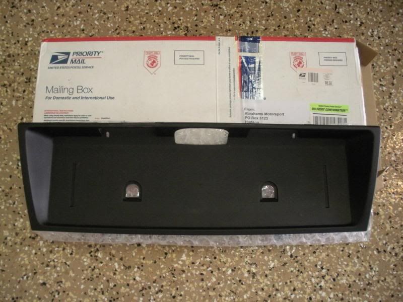

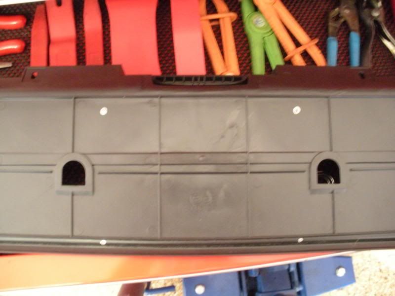

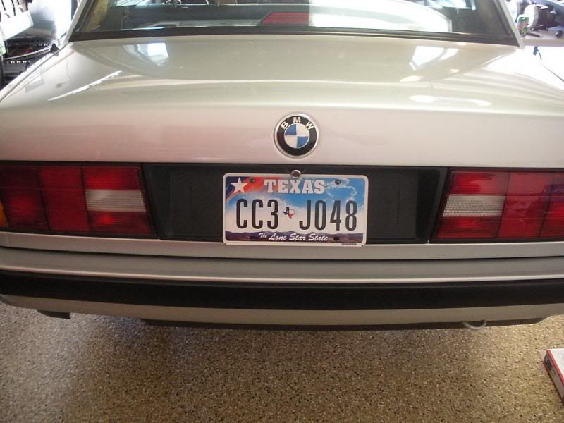

                          Next up was rear Euro bumper trim and license plate filler
                          remove old mounting hardware
                          Install is super easy if you have the bumper removed.
                          All done!

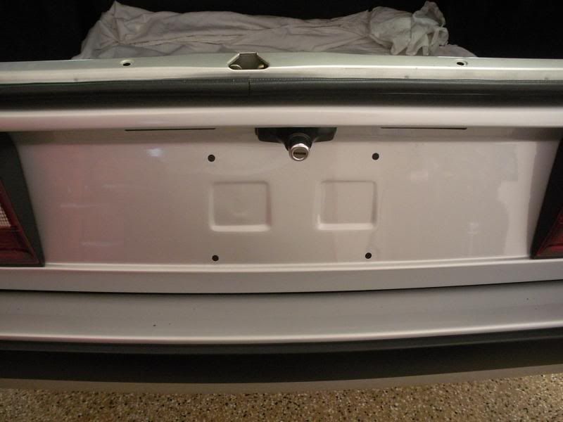

                          Install license plate filler
                          Remove all trunk trim to be able to mark from backside holes with silver sharpie pen to drill out license plate mounting holes
                          Use some 3M double sided tape and with the license plate bolts it is not going anywhere....
                          All complete

                              Just read through all of this and I'm very jealous. Awesome work and every mod is choice.
                              Is that a brand new dash?! If so, how did you get it, I want one so bad since they are so nice.
