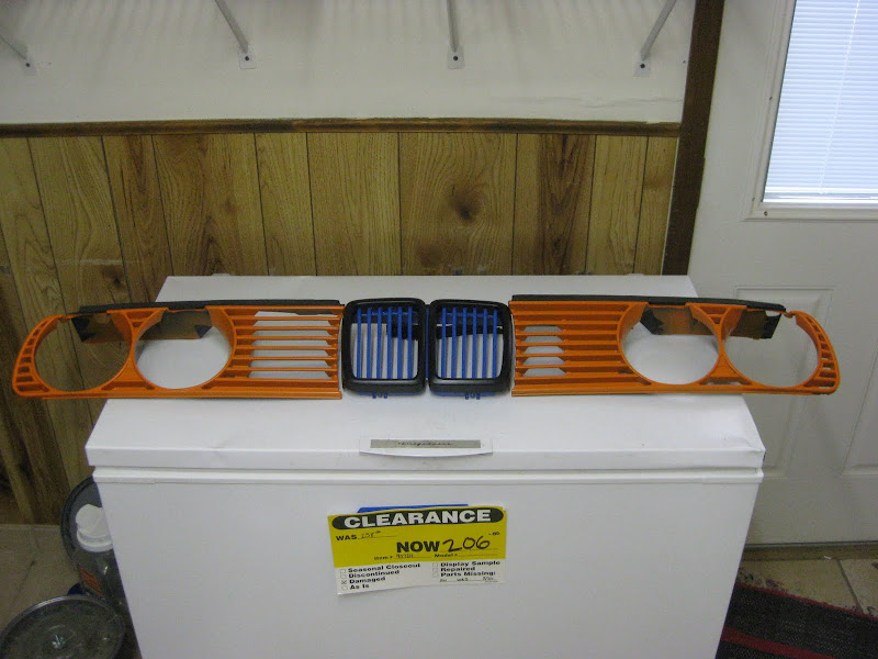

    So, having decided on a color scheme for the car, I went ahead and painted the various parts of the grille. First, since I was going to be using bright colors, I sprayed the little body panel between the bumper and the grille satin black.
    I then painted the grille pieces in blue, orange, and satin black:

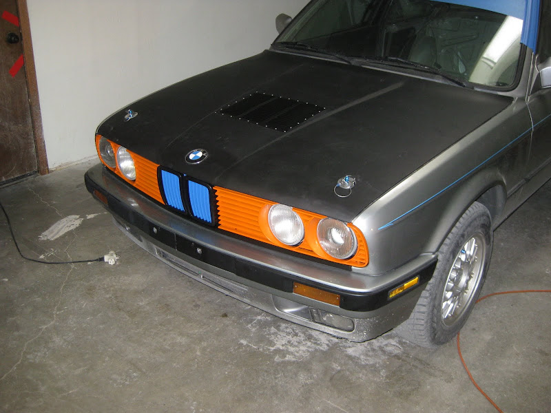

    Bolted on to the car, the whole thing looks like this:
    Or, with the camera flash,
    I still need to paint the valence and everything below the belt line, so the car will be much more black by the time its done. I think the blue-orange combo will be distinctive and just ridiculous enough for a rally car.
