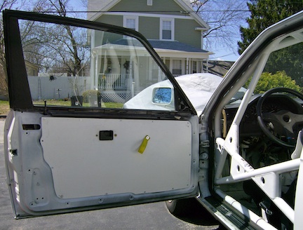

            So I picked up a bulb to replace the weak one in my shift light (2-pack was $5). The original was 3.4W, and I upgraded to 5W. This change plus a better incident angle makes the light effective. Here's how it's (temporarily) mounted:
            Should be hard to miss. As I mentioned previously, I stripped the doors. For those who are curious, here's how they look:
            Somehow in the course of removing all the door lock mechanism and wiring from the driver's door, I did something to irreversably lock the passenger door :curse:. Power accessories are the devil's work! I will solve this when I remove the entire lock mechanism, I just now have to do it from the passenger's floor instead of a comfortable chair with the door open. Ah well.

              Did you clean up the door inner shell after removing the factory plastic? I removed my factory plastic and the inner shell was a mess of mud, dust, grease, and sticky residue.

                  Yeah, there is a lot of goo when you pull the plastic.
                  Don't forget that you have to cover up that door with some sort of skin or a modified door card per RA. I used a sheet of that weird paneling that you find in RVs and/or bar room bathrooms. I put the smooth side out.
                  If you're going Lexan, you can pull the motor/regulator and wiring too.

                    I didn't clean it at all; it's still sticky. I'll probably wipe it down with WD before getting it too dusty.
                    On windows - my drag racing days have taught me that the several pounds of window motor and mechanism are totally worth it on a hot day in a race suit when you can just zip down the windows and get some fresh air after a pass/stage. So I'll keep 'em until my skill level surpasses the speed of the car and I need to shave more weight...
                    I figure I'll do the same sheet aluminum trick on the doors as the roof... worked out well and should be durable. Plus I already found some sucker to buy my door panels for enough to cover the aluminum... sucker :mrgreen:.
