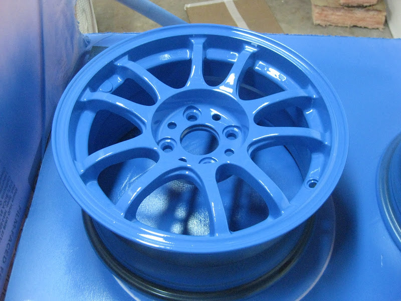

      So, as mentioned before, I picked up a set of TRM C1 15x7 wheels from TireRack.com. They shipped incredibly fast and arrived as pictured above. For anyone worried about brake clearance, here's a profile shot:
      Here are the wheels prepped for paint after a few minutes with an orbital sander and some foam sanding blocks:
      And a few shots of the result after many thin coats of rustoleum:
      Gonna be truly ridiculous.
