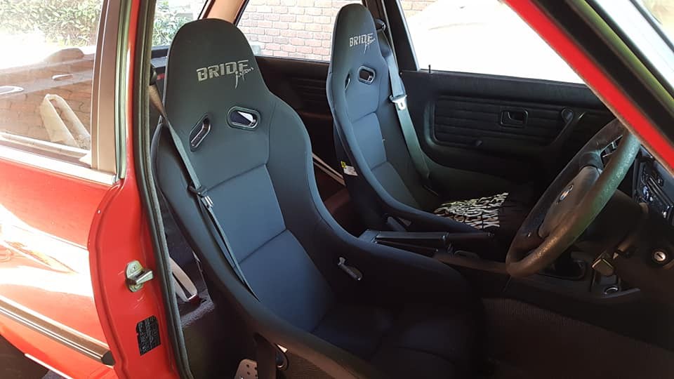

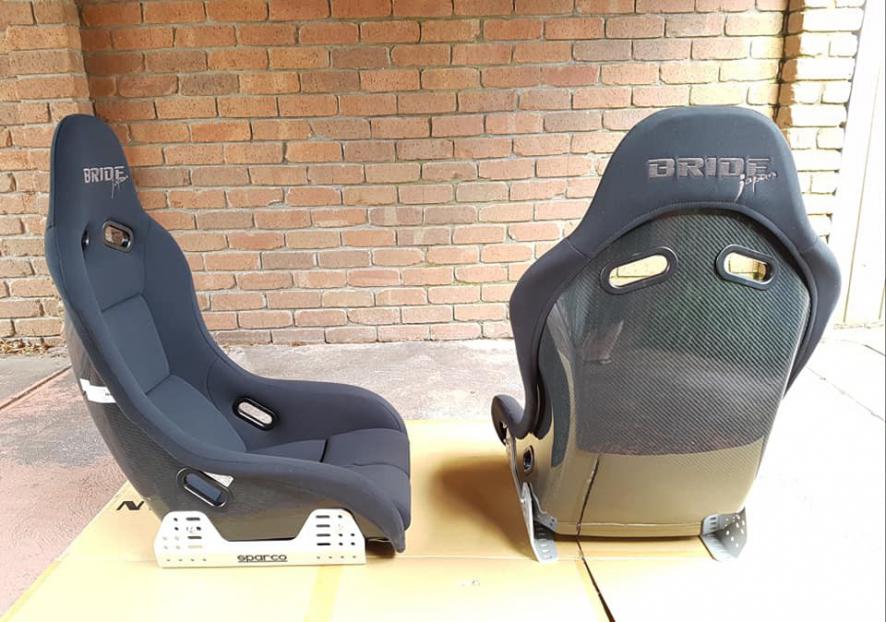

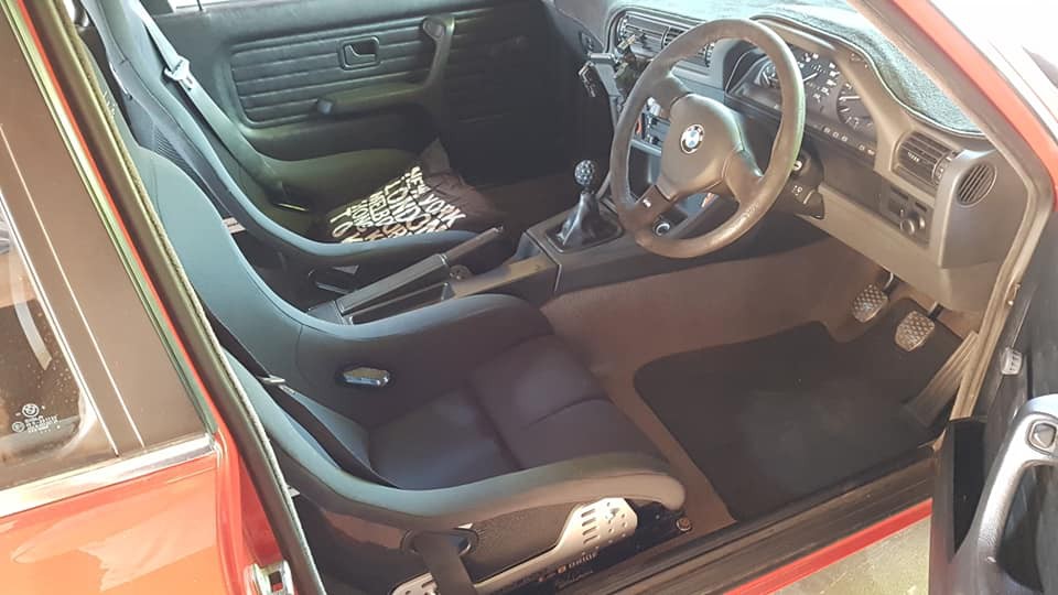

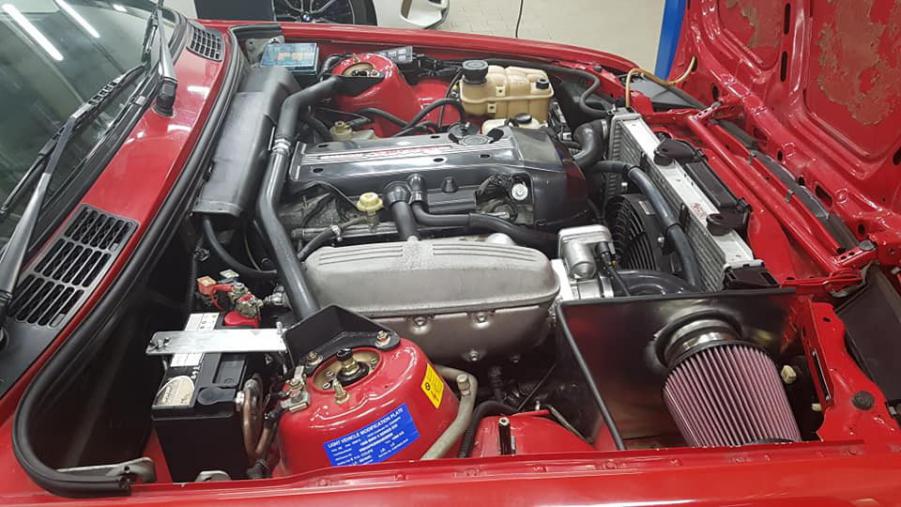

        Have carried out plenty of upgrades but to focus on the important ones I have upgraded the ecu to a Link Plug In, upgraded to fuel system with e85 spec components for the future (1000cc injectors, race works fuel pump, hoses etc), New Bride Zeta III XL Japans in carbon fibre aramid, Sparco FIA adapters etc, swaybar, eibach 6kg/8kg helper spring setup in the front, and much more.
        Came unstuck with the half mechanical/half electric throttle that comes standard on the Altezza engine so filed that in B..... and fitted a 85mm DBW N62tu throttle body and E46 DBW pedal (shockingly this is a bolt in for the E30 chassis in RHD). This is ALOT bigger than the factory item and did take some fettling to get the idle and tuning correct but the result of 137.5rwkws at 8200rpm is a great result for such basic modifications.

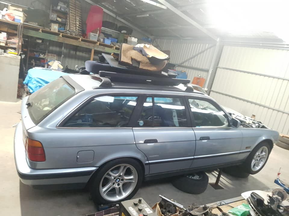

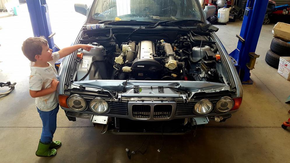

                  E34 Touring: 1JZGTE Mounts are done but need to get the service items done and dusted and fabricate all of the pipe work and ancillaries.
