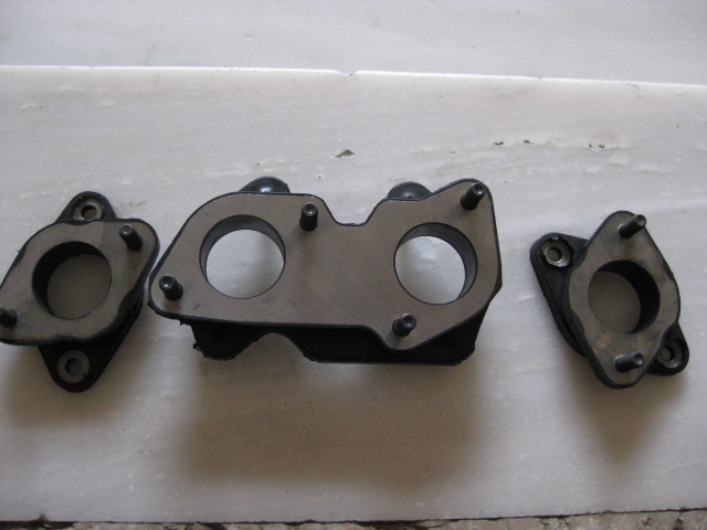

                        On the intake manifold, do you not need an isolation mount in there, where the Webers are hanging off the manifold and want to flex?
                        I ask because Alfas have an extra rubber isolator mount in the system. Maybe that's because it's a 4 with more vibration? Although I have seen aftermarket and race applications where it's a solid aluminum piece with rubber o-rings.
                          [ATTACH]86607[/ATTACH]
                          Thanks latefan.
                          In regards to rubber isolator mounts, no I won't be using them. As you mentioned you'll actually find a number of factory/aftermarket weber setups that did not use them either (Aston DB5, Jags, Maserati's). Yes the 6 will be inherently smoother, but I've been involved with enough M10 dual sidedraft projects to know they are rarely needed.
                          The problem is that its not a matter of "if", but "when" they start to leak. And I don't really want to have to deal with tracking done air leaks when trying to tune them in the first place.
                          Honestly I know there's a lot of conflicting information out there on these, so I'm simply going with what I know works. Have been fortunate enough to have weber-sage Gron Perry weighing in as well.
