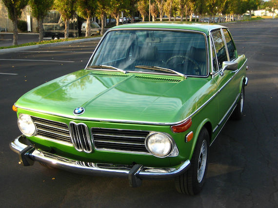

      Danke, feels so good to be at this point! Color is going to be Taiga!

          #379
          Originally posted by SkiFree
          Taiga!
          Whoa, that's really green!

            Oh absolutely.... if I was cruising for chicks at the retirement community.
            It's not boring, that's for sure. That specific shot or the car is a bit off though, too much kermit vs reality.
