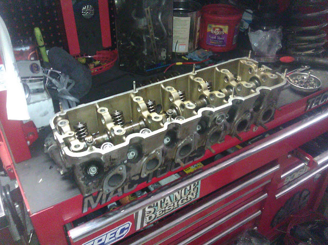

    got the head most the way stripped down, dont have a valve spring compressor(need to invest in one) so i will have the machine shop pull those before they pressure test and deck it, will drop off the valve seals with them tommorow morning when they arrive, hopefully can have the head back before the shop calls it a day and is gone for the weekend. ugh might fork up for a regrind and seat, not sure yet.
    and some goodies, love having a chill ex boss who lets me order through his wholesalers, cheap parts within the hour!
    Leave a comment:
  • mdlimy
    replied
    Originally posted by Vtec?lol
    I'm actually surprised you went and got the head. Keep up the good work! I can tell this is going to be an awesome build.
    Also, on your stroker, running regular unleaded will be a plus.
    I can't wait to run regular unleaded for a while till its boosted =)
    Disassembling the head tonight and dropping it off in the morning at the machine shop for pressure testing and machining if it needs it, he says ill have it back tommorow night so hopefully I can put this motor together this weekend! Got all the other parts also, hg kit, coolant sensor, head bolts, tbelt tensioner and some other small odds and ends.

    So a little update, the guy i bought the car from had an I head and parts at the shop so i swung by tonight and grabbed it all along with the headers that go with my exhaust ;)
    I dont see the 885 casting number on the head like most heads, this head and manifold are off an Xi tho, so can someone reassure me that it is the correct head and manifold i need?
    So now i have
    -complete I head
    -I intake mani with fuel rail and injectors and harness and throttle body
    -the headers to finish off the exhaust
    Im pretty sure thats most the stuff i need, it sounds like i need to get a couple coolant/water temp sensors from an I motor and a headgasket kit and some head bolts.
    this is the only numbers i could see on the head, but it is a little bit dirty and it was kinda dark out so i might be missing some, can someone confirm for me please?
    I finally figured out why my phone was stuck taking pictures in that gay yellow contrast, so all pics from now on will be normal thank god :pimp:
    Anyone opposed to using a Victor Reinz headgasket set? i can get the whole set for 76 bucks....
    And where do i buy the metric blue head bolts/what size are they?
    thanks for the help guys, cant wait to get this thing running asap! esspecially to hear that gorgeous header back dual 2.5"
