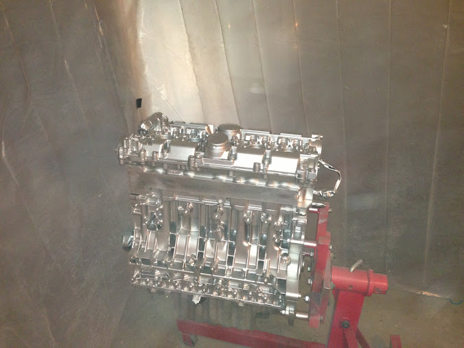

    Finally finished up all my side jobs and got to paint the motor this weekend!

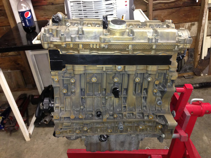

    Cleaned the whole thing real well with scotch bright, tooth brush and brake clean. Then I did a two stage etching process to prep the aluminum for the paint. That process started with an acid wash which was mainly a phosphoric acid just to clean the aluminum then a chromic acid based chemical that causes a chrome conversion before the aluminum can oxidize and allows the paint to bond to.
    I didnt snap any before and after pics but this is after the whole process was done, the motor was left to dry over night. Notice the gold color, thats the chromic layer that was formed.
    One picture with flash and one without....
    I am presented with a new problem, the whole motor is silver, will have blue R covers but i cant decide whether i should paint the accessories(alternator, intake, fuel rail, pulleys,etc) the same color as the motor or a different color. Im not feeling the gray i had planned, but i feel like i could easily end up with wayyyy to much silver....

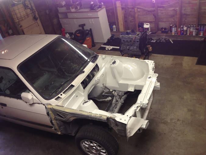

    Car came home on sunday, pretty happy with it, couple spots that i'm disappointed with but for what i paid the painter i really cant complain, and its an engine bay anyways so once the motors in no one will notice.
    Painted the master cylinder and stripped the motor to get ready to do a phosphoric etch before i painted it.
