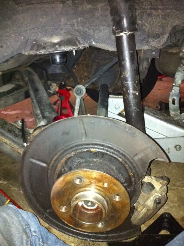

Here's some before and after's. The rear subframe didn't come with brakes or anything. Put some brembos on with generic pads, bilstein sports, and 600lb GC coilovers in the rear. the trailing arm bushings looked awesome in the rear, and it definitely showed since when I lowered my car I had very little negative camber. With my old car, my bushings were so shot I probably only had an inch of contact patch on the tire! Now I have an entire 195's worth of contact patch.Originally posted by TSI♫ Rust flecks are falling on my head...♫OEM+Comment

Got a bit more done...things got a bit carried away so I'll just post the pics in chronological order.
So we kinda started with something that looks like this
Then in the midst of cleaning my engine bay a little more..
And yeah......
Don't really remember how, but they ended up looking this good.
GC 500lb's in the front, brembo rotors and bilstein shocks
Looking really good mocked up!

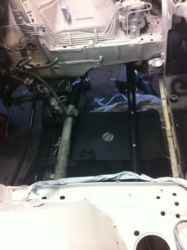

Also got the peerless skid plate hooked up! This thing is awesome!
Next and final episode: Engine and trans ;)Originally posted by TSI♫ Rust flecks are falling on my head...♫OEM+Comment
I'm skipping a lot through parts but to recap, when I got the car it did not have brakes on any corner, now it has a bitchin Brembo/hawk pad setup all around, it was on stock springs with terrible shocks and now it's on GC coilovers 600/500lbs on bilsteins. The bushings were really good on the TAB's and subframe so we didn't touch that, the CAB's are getting replaced to M3 ones.
