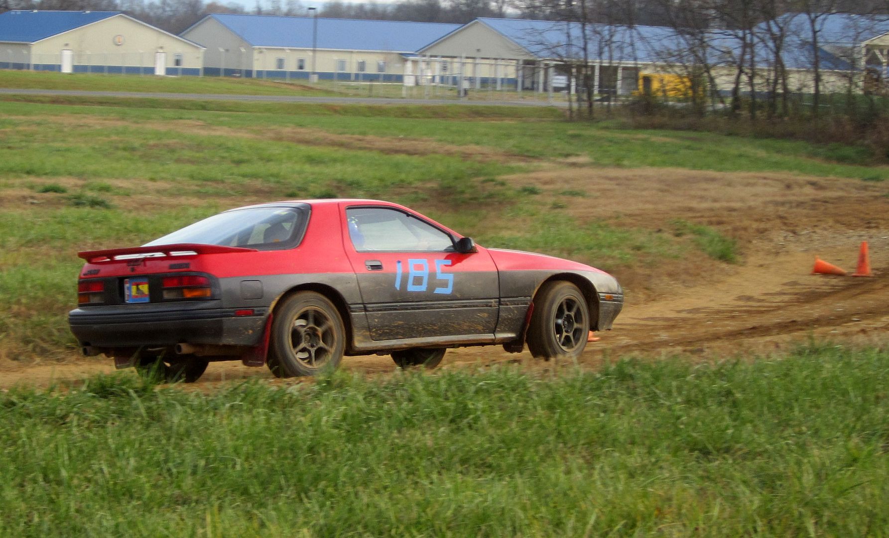

    Gorka/Roberto's RX-7 (1st in PR, 2nd in MR for the season)

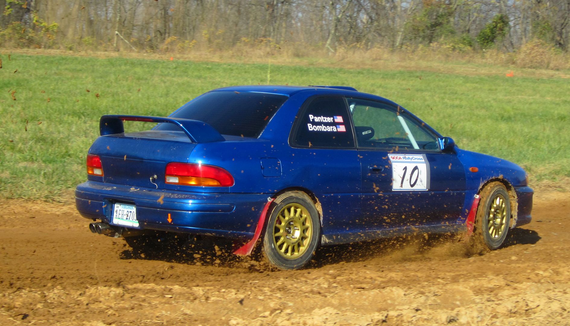

    M4 season champ Matt Berkebile in his H6-swapped impreza

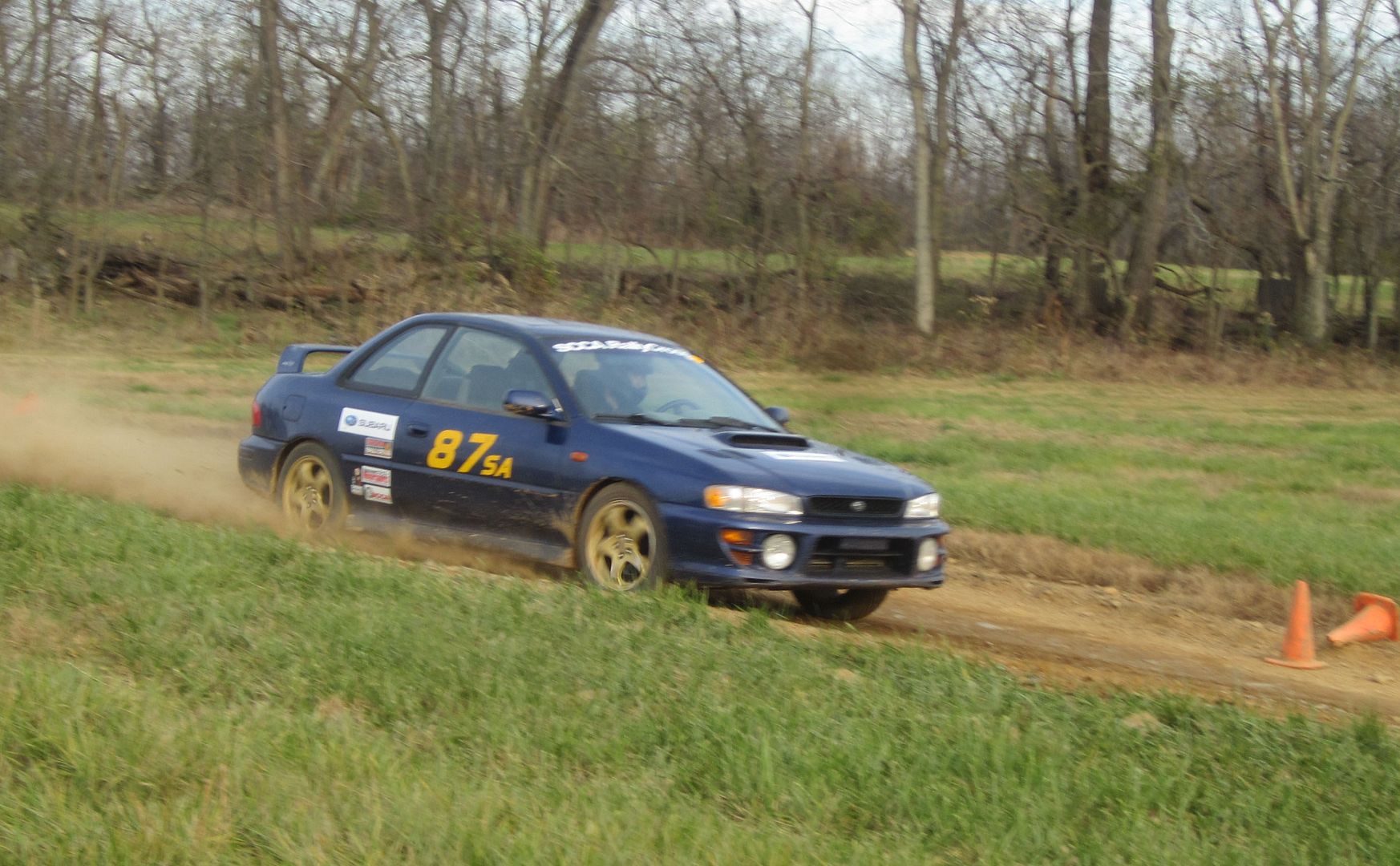

    SA champ Mike Golden

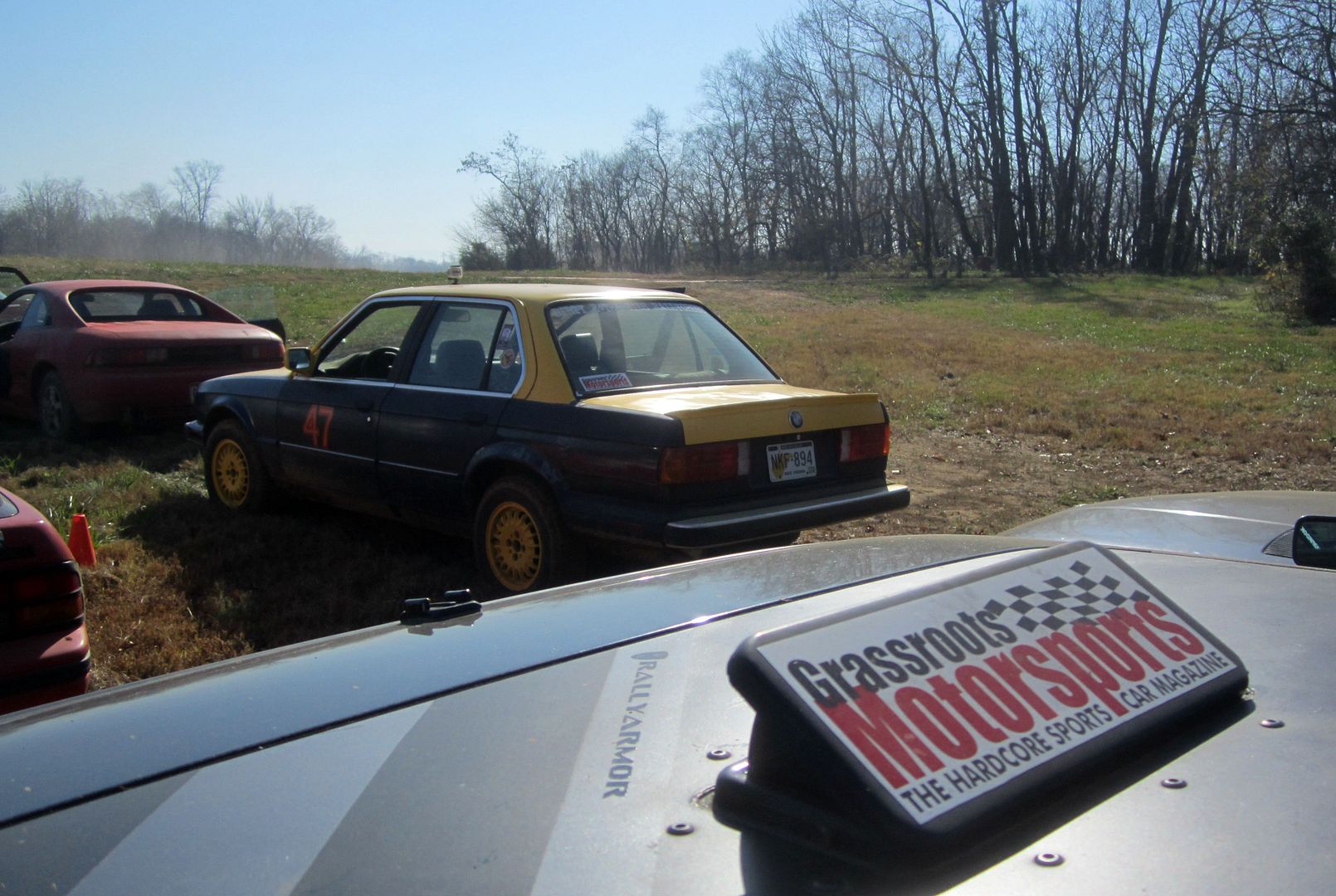

    grm style

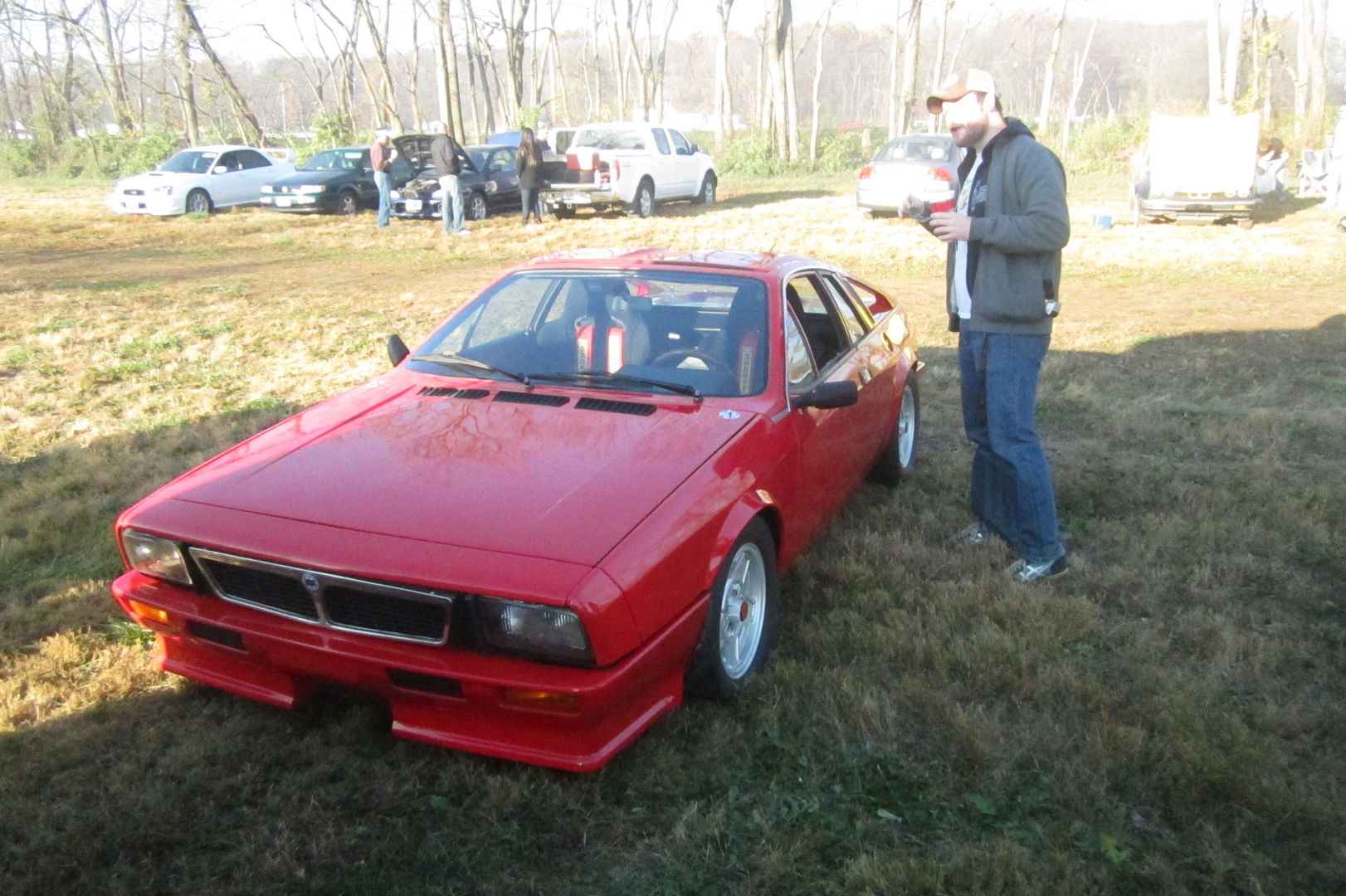

    dave shindle's nice lancia (not rallycrossing)
